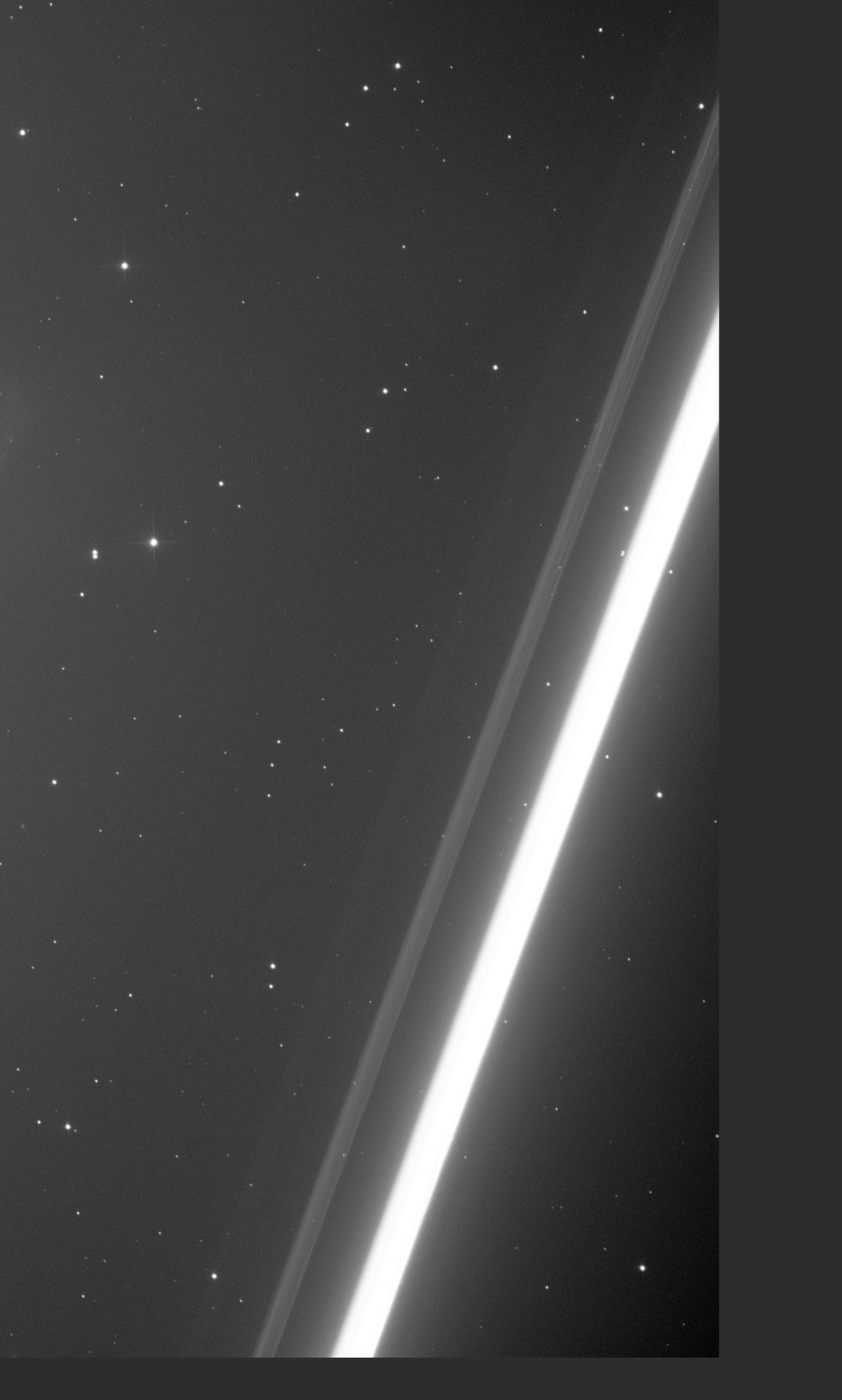

Got this in one of my sub, this is way too wide to be a satelite trail, do you guys think it's a plane? If not what do you think this is?
Most likely
Tapfret 4.95
What's your focal length? Looks to me like ISS.
sgthebert 2.81
My focal length is 900mm with the reducer, pixel size is 3,76um.
Is there a place a could check the iss position?
Thanks

How about Tiangong? Not sure if there is a tracker for that. Planes always take up more of my FOV at your focal length.

In short, if it's not the ISS it could be anything. The Goodyear blimp, a plane, a drone, a UAP…

Too far South to be Tiangong, especially since I was pointing North. There's the local airport not that far away and it's only for smallish planes so maybe on of those
Thank you all for the suggestions!

Could be a meteor.

Could be, that would explain why it's tapering a little, it heated up on entry. It also doesn't look like the plane in the CN thread posted earlier.

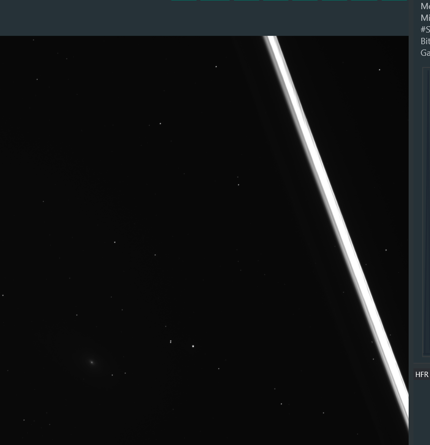

OK, I'm going to have to run through some of my frames that I was certain was one of the large station goin through.
You can really get a sense of what is happening in the stretched image with the dimmer trail. There is a filamentary, almost twisted helical appearance to it that would indicate the trailing of multiple small objects than one solid object; as in a piece that is broken from the main object and in a further state of decomposition. Very interesting.
