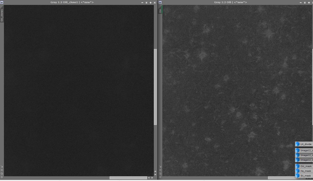

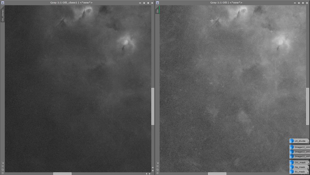

Hi guys,
Being tired of my spotchy Oiii and Sii layers full of stars imperfectly removed, I gave the trial of StarXterminator a try. The outcome is rather clear.
You find here a comparison of the StarX generated starless (left) and Starnet2 generated starles (right). These are two different areas of my Oiii layer of IC410, collecter over 1h40' with a Touptek 2600m. The processing is exactly the same (I did process starnet version, get back, made a clone and reapplied the same steps using the history).
I would not have believed that the difference to be that huge.

I tend to agree on paper with your argument, especially about spikes. However, spotchy layers are, at least for me, hard to process. It makes it difficutl to assess how much you can stretch your data, especially in the darker areas.

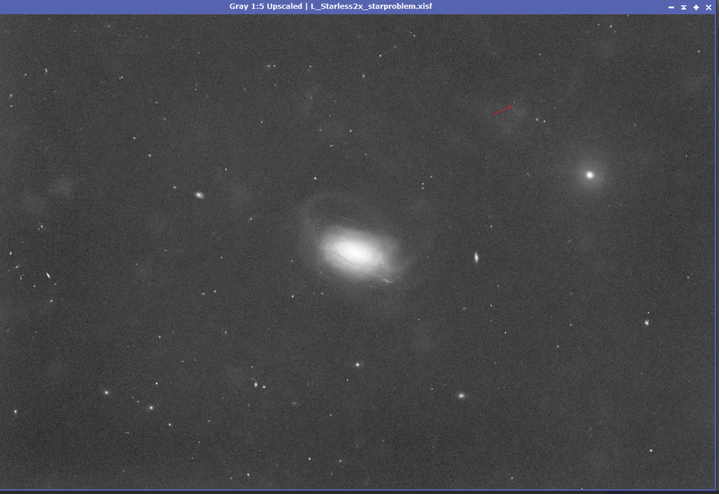

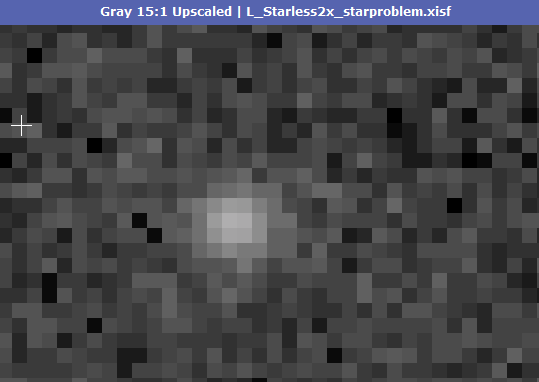

In case of both the Spaghetti and Virgo an Askar FMA230 was/is used, it's somewhere in middle between long FL scopes and wide field lenses.
Regarding the BlurX, it's obvious that the tiny blob turns into a brighter nucleus and blurry rest which in my case may be recognised as the star and halo. It happens that the nucleus is removed by the StarX while the 'halo' remains.
I compared results of applying the StarX on the Virgo image, it's 2x upscaled copy and 2x drizzled image. The two last results are better (than the first one) while they differ slightly. I hope Russell Croman will release the new version of the StarX before I finish my mosaic. 🙂

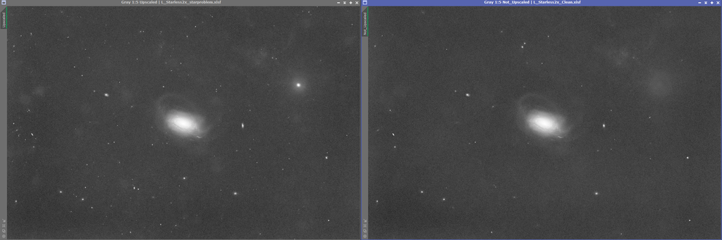

*I'll be traveling during the next week, so will be unable to support my response with data.  Upsampling at 2x is precisely what the image of M31 was because this was drizzled 2X.  If you look at the .PNG version at full res (Rev D), you will see how smooth and detailed these small features are. Please understand that this image contains no stars (none other than ones affiliated with M31).  99.9% of these features in the non-M31 part of the field are NOT stars. Yet all were removed by SXT.  Yes, and this after BXT, NXT, etc.  So while I can concede that using those tools prior to SXT is a help, it's far from doing a perfect job. And for those like myself, for this sort of project, it's not even  good.  That said, this field is scattered with very small background galaxies and I concede for most of the work done by people here it is a great tool and could never be completely accurate without including too many stars in the actual result.
As I said, my issue for deep field galaxy field, that contain NO foreground (I e. Milky Way) stars, it is a critical issue. Most would care less for the loss of many small smudges. I believe that is the loss to ignorance.  Not trying to be insulting to those who don't know what they can actually see with their optics, but more and more often I see proof when I see posts of images and the originator is so proud that they picked up hundreds, if not thousands of distant galaxies in an image of one of the typical, famous NGC galaxies.  Please see
The NGC4725 Family in the Foreground of The Universe - An ExtraGalactic Traveler's™ View
and the revisions as examples of this.
While SXT cannot be faulted for extracting smallish smudges, it continues to trouble me when I see edge on galaxies completely removed, or their cores extracted, and often cores of larger galaxies extracted in full or partially.
As for losses in emission nebulae, well what can you do?!  Hopefully it gets better. In M33 so many parts of these features were affected in my image and so apparently for at least one other person here.  Most who have done M33 or similar, probably use SXT as a one click solution, thinking or caring little about these losses.  Indeed, probably never notice in the haste to complete what otherwise ends up still being a wonderful colorful final image.  The solution is not in masking.  That tends to be tedious because of the hit or miss nature of the artifacts.  It ends up being unfaithful in the end, mostly, and invites just painting the data to look "kinda" like it should.  I agree that if the Stars-only image is to be screened back into the starless image, with no difference in stretch or many other processes, then all will be good. But then why use SXT?  Most use SXT as a means to do star reduction (using such as the Blanshan method), or else modify either the starless or Stars-only image making the accuracy impossible to recreate.  There is a far better solution that I can't go into here tapping on my cell phone.
I should conclude that SXT-caused artifacts are not inevitable, nor seen in every field.  But they can and do occur often enough to never use SXT without doing a thorough job by inspecting the resulting image for problems.  It is easy to do blinking between images treated and untreated by SXT (even more so now with the new PI updates).  Or one can do a strongish screen stretch on the Stars-only image to look for nebulosity that "should not be there"!  If you see it in the Stars-only, then it ain't in the starless image!  Know that.
It can be an issue with BXT as well. You won't notice it looking at the full frame but when I look carefully can see tight nots of nebulosity that it turned into stars and faint stars that are just erased or turned into nebulosity. It's probably a product of correction mode where the AI has to decide what it's looking at.
