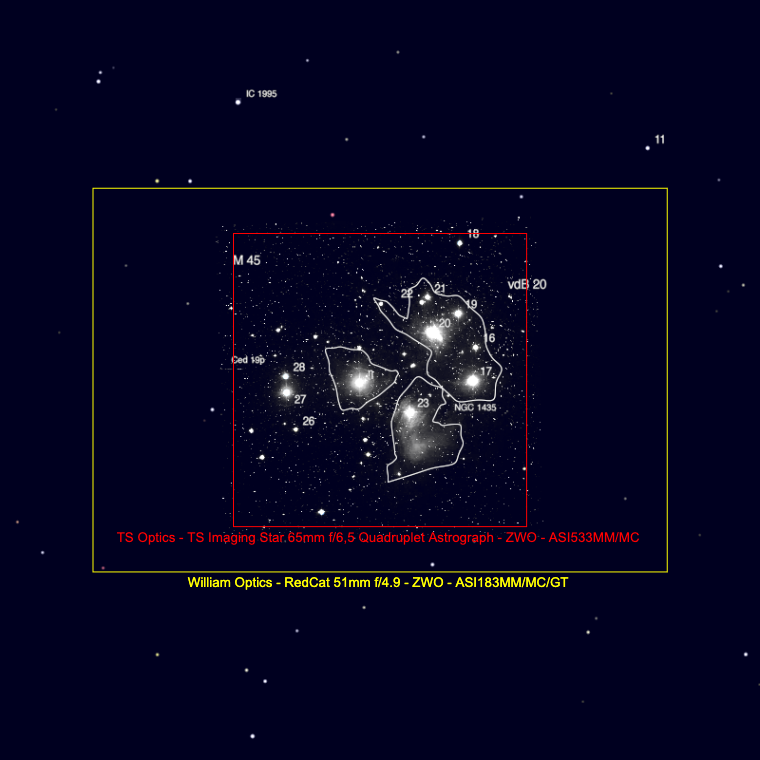

I've played a little with astronomytools.
Redcat51+ASI183 resolution 1.98"/pixel
Sharpstar 65Q+ ASI 533 1,85"/pixel
Which combination would be better for Luminance and which for RGB? As I know better Luminance with higher resolution

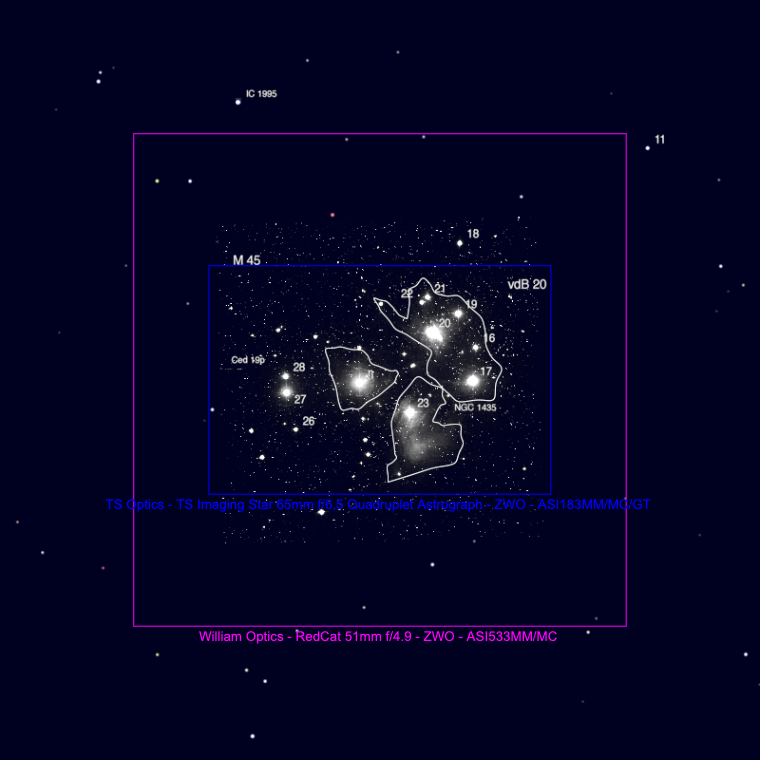

Ziofrancotto 0.00
Second option
Sharpstar 65Q+ASI 183 resolutionn 1.18"/pixel
Redcat51+ASi 533 resolution 3.1"/pixel
I think in this solution Sharpstar for Luminance is better and Redcat for RGB

The optimum combination is the first since they yield similar resolution and you can still feed the RGB into the luminance channel (or Ha/OIII if you use Dual NB) and still capture at the same time the Luminance (or Ha/OIII) signal. So you get the best of both worlds. In the other case the extra time or better SNR would be wasted for RGB because you'll have to spend a lot more time for L.
