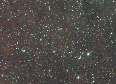

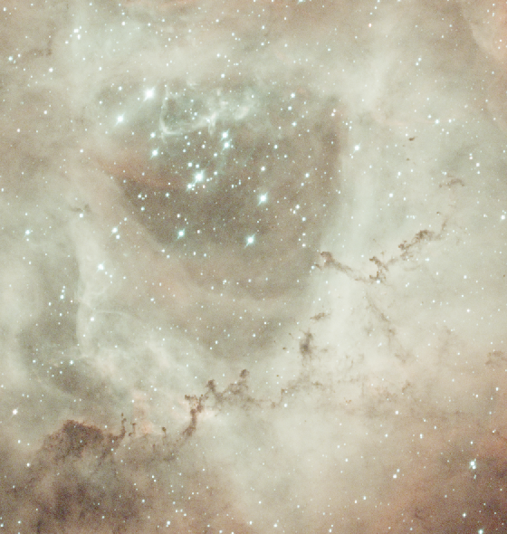

A few weeks ago I bought a 2" L-Ultimate filter that I used for the first time the past weekend along with an Askar SQA55 and an ASI2600MC Pro Camera.
I set the exposure time to 300 sec and since the first image I noticed some kind of spikes on the brighter stars when checking the preview images, but I just ignored it since the previews in my phone were not very good, so I continued shooting.
Today I downloaded the images to my laptop and I found out that all the exposures have those weird spikes.

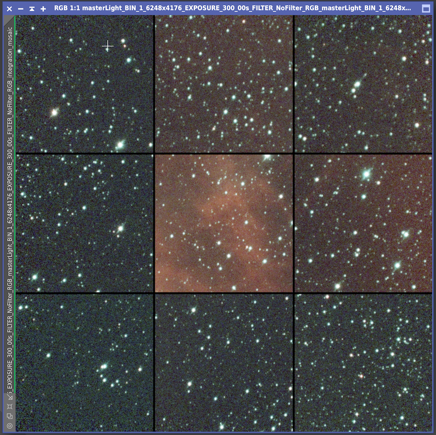

Below you can see a couple of portions of my image, as well as the Aberration Inspector where those artifacts are very noticeable across the entire field.
I have checked several reviews of the Optolong L-Ultimate filter and I didn't see anything like this before.
I have used this very same telescope and camera with the Optolong L-Quad Enhance filter and I got perfectly round stars.
I also thought it might have been a guiding problem, but don't see anything wrong with the nebula, the issue is only with the stars.
Do you think I may have gotten a bad/defective filter? or is there something I may be doing wrong?

Im no expert, but if everything worked fine before adding the L-ultimate and is doesn't now, I'd send it back for another. Maybe it has an optical irregularity. Good luck.

how cold was it during your imaging? This looks a bit like pinched optics. Just a guess.

We have this filter and its been perfect on all of our imaging systems, from 135mm to 2500mm. We occasionally get spikes just like this however and its usually due to high cloud, mist or excessive moisture in the air. Slight dew on any of the optical surfaces (including the camera window) can do similar. Make sure its not the filter by changing to another like you've said and if it isnt check these other causes. Do you use the dew heater on your 2600?

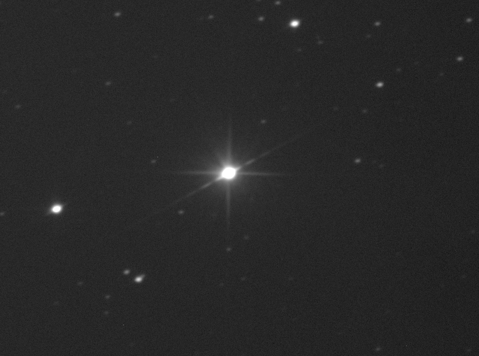

Probably not this, but I do get something similar when my target get behind the clothesline. Do you have any obstruction in your telescope line of sight in a portion of your sky? Even if really small, it'll make diffraction spikes.image.png
