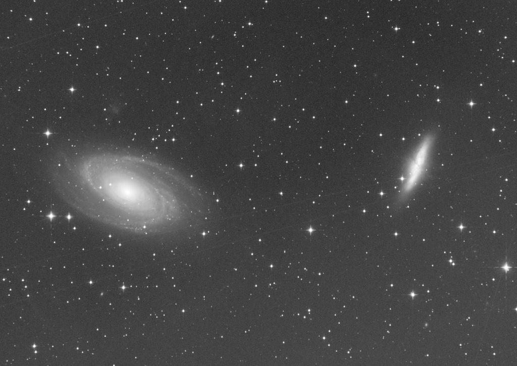

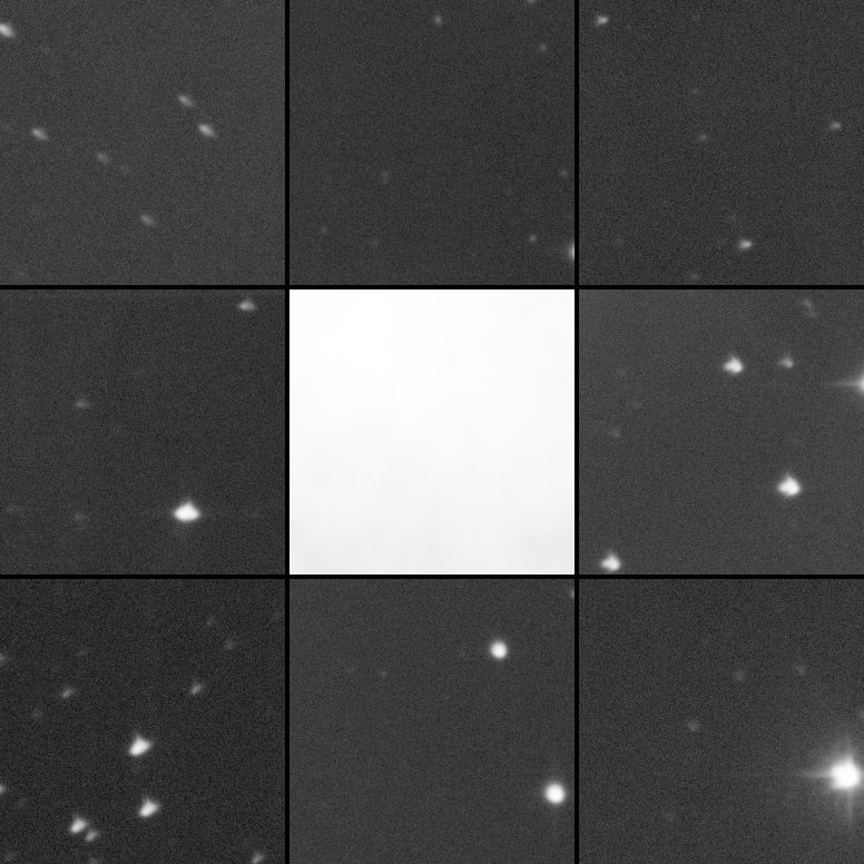

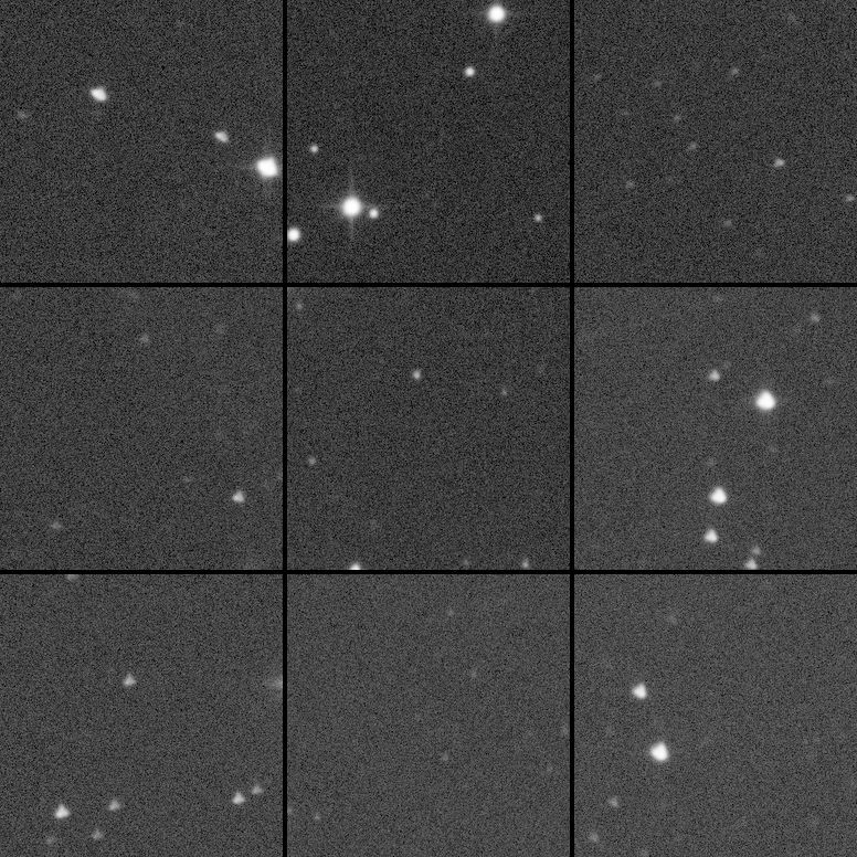

I've recently got a Skywatcher F4 200P reflector used but have some problems collimating it. I used ocal for collimation inside room, but after I take it out and put on the mount, I find stars are always not satisfying. I tried the next night but still didn't help (so it's fully cooled). I did different crops on M81 and even on 4/3'' sensor I think the star still shows coma.  I really don't know if that's collimation problem as I've collimated several times. For imaging, I use skywatcher quattro MPCC, then a 55mm  5mm tilt plate+OAGL+2''EFW+12.5mm camera as ZWO suggested. Any advice is helpful, thank you!
CS,

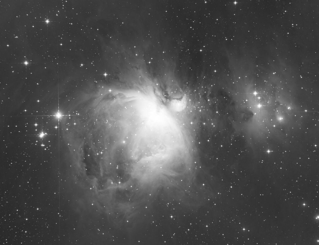

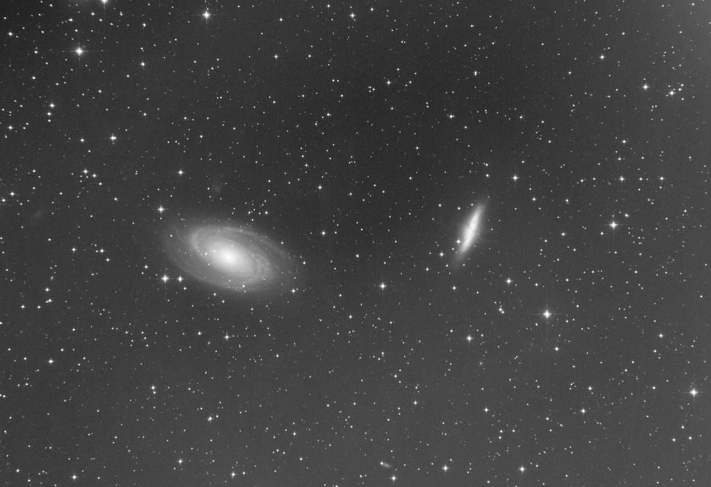

YingtianmasterLight_BIN-1_9576x6388_EXPOSURE-300.00s_FILTER-G_mono.jpgmasterLight_BIN_1_9576x6388_EXPOSURE_300_00s_FILTER_G_mono_1__integration_Preview01.jpgmasterLight_BIN_1_9576x6388_EXPOSURE_300_00s_FILTER_G_mono_1__integration_Preview01_mosaic.jpgmasterLight_BIN-1_9576x6388_EXPOSURE-300.00s_FILTER-R_mono.jpgmasterLight_BIN_1_9576x6388_EXPOSURE_300_00s_FILTER_R_mono_integration_mosaic.jpg
YingtianZHANG 0.90
Or poor seeing and caused poor guiding is another reason? But I see stars are varying in all direction, so I think remaining comas are still damaging quality. Back focus may be a problem but I just followed 55mm and there are at most 0.5mm error from filters.
Poor, actually quite poor, collimation. The 55mm backspace is quite right (I have the same CC), give or take 1 mm so don't fret over the filters'. Don't use the OCAL other than for initial centering. The gold standard is auto-collimator(s) and star test. A good auto-collimator is key for an hassle-free relationship with fast newts so you might want to splash the cash for a good one. After collimation is sorted you'll need to sort out the tilt issue which is undoubtedly there.
I see guiding error and coma. I'm not sure why you think you need an OCAL at F/5.6 but ok. Have you looked at a bright star far out of focus to check collimation? It just takes a second to make sure it's not the issue.

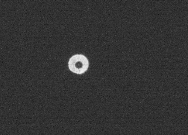

image.pngThank you guys! I rechecked the collimation out of focus, in-focus is still a round but out-focus is definately showing the collimation error. I'll try to fix this now. Thanks!

Looks like a combination of guide error, coma and astigmatism. I got diamond-/triangle stars with my TS UNC newton once, because the push screws for fixation of the mirror cell were screwed in extremely tight. This caused the primary mirror to flex and produced triangle stars/astigmatism. On top of that the look of your stars is different corner to corner, which could be caused by tilt and/or misalignment of the mirrors. Newtons are not hard to collimate, for my UNC I use a laser (which can be collimated, too), cheshire and stars.
On newtons coma related issues are backfocus issues most of the time. Buy a digital caliper and make sure you are spot on with your imaging train. Sometimes the threads can be pretty short and your adapter/FW/camera/etc will not screw in completely which adds up additional backfocus. Depending on the corrector additional 1-2mm can mess up your stars already.
If your star was at the center of the FOV then yes, you are out of collimation. A slight adjustment is all it needs. You can quickly do it with this view. Just make sure to re-center the star in the center of the FOV after every adjustment. You're just working with the primary here.
