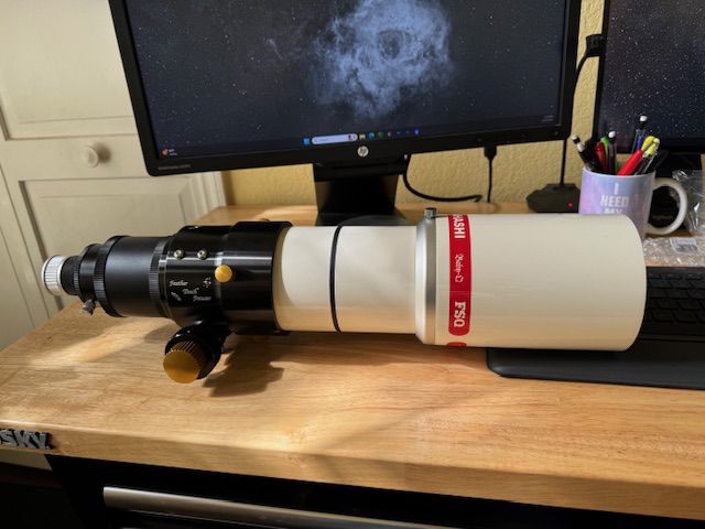

I have the Tak FSQ 85-EDX with the 1.01x flattener and it produces wonderful images with an ASI6200mm.   I also tried it with the new full frame 0.73x reducer but the results are not as impressive.  I've made a couple of posts and images about this on AstroBin. The only issue I have with the Baby-Q is the focuser started to sag with the weight of a 7-position filter wheel and the ASI6200mm after a few months in my permanent observatory setup.   As a result, the autofocus motor would not work properly.  This has been mentioned by others.
I took the focuser off and right away I saw the problem. The teflon strip with the glue that holds it in place was dislodged from its proper position. So, I have had enough of this and ordered a Starlight Instruments replacement focuser FTF3015B-A—Feather Touch® 3.0" Diameter, with the adapter. Once assembled and tested, I'm going to sell it and then someone will gain a much better scope.
umasscrew39 13.55
Best decision to permanently fix the problem.....
Removed the flawed stock focuser and replaced it with the Feather Touch® 3.0" Dia Dual Speed Focuser--1.5" DTT, Brake

Very happy- the FT focuser is amazing but I decided to piggyback a RedCat 91 WIFD on top of my C11" in my observatory instead of the Baby Q.  The reason for this is that the RedCat has an internalized draw tube, so no sagging or tilt is possible when adding heavy accessories.  This is what caused my issue in the first place with the FSQ85 EDX.  While I have no doubt that the FT will not suffer from this, I prefer the internal design as it also prevents dust and dirt, which accumulates on the draw tube during an entire evening of imaging, from potentially causing movement issues when using an autofocuser motor.   If no one is interested in buying it, I will gladly keep it as a travel scope since it is an excellent scope.
