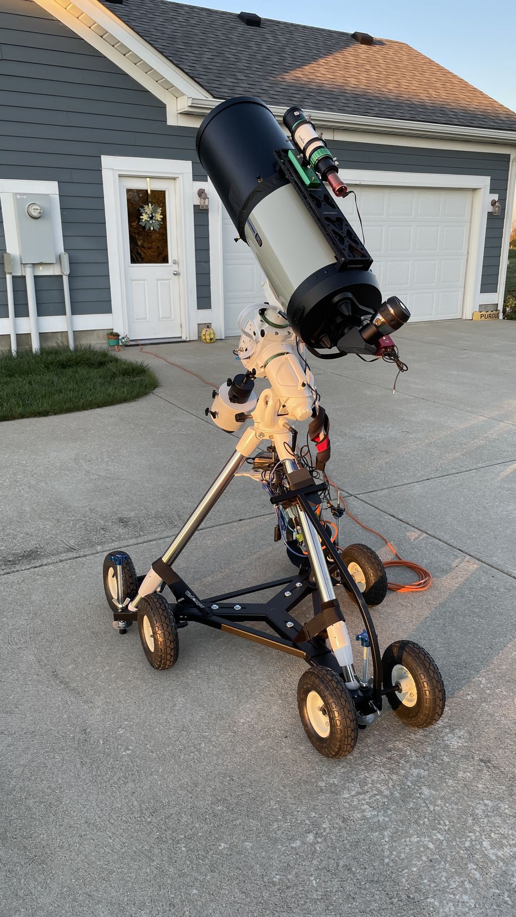

super jealous of your JMI wheely bar cart!!
Yea I thought I would add that about it being donated. I am not a huge windows fan TBO. I had a connection that was able to hook me up with that computer, so I am obviously not complaining. It is the mini version (8.3 x 8.6 x 2.7 in). I was thinking of attaching it with velcro or something to the leg. A friend put a round wood stabilizer/platform between the three legs of their Celestron tripod. If I did this, I could potentially put it there.
