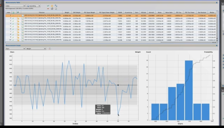

I blink for satellites and then use sub frameselector in PI based on FWHM and number of stars - set to limits below and above the light grey area respectively.
As the author of this video explain, at about 6:20, wbpp already selects for PSF and SNR.   https://youtu.be/mLmtVcgaQZo?si=dyyYIEfOIW6mhtaC
I first used SBS when I had imaged over 30 hrs on CTB1 and wanted a way to select for sharper structure of the nebulosity - so I selected the best 450 of about 700 based on FWHM and star count - which corresponded to limits below and above the dark grey area.  I figured sharper stars would translate to sharper non stellar. Yes,  I threw out a lot, but after running WBPP at default settings I could easily see the improvement in the sharpness of the nebulosity, especially for the OIII signal, and I still had 23 hrs🤷‍♂️.
For more recent wide field shots using a Samyang 135, I just used Blink in PI. In this case I shot the nebulosity at F2 and the stars at F11. Works great - pinpoint stars throughtout the FOV.
ps- the screenshot is from the video - not my data.
