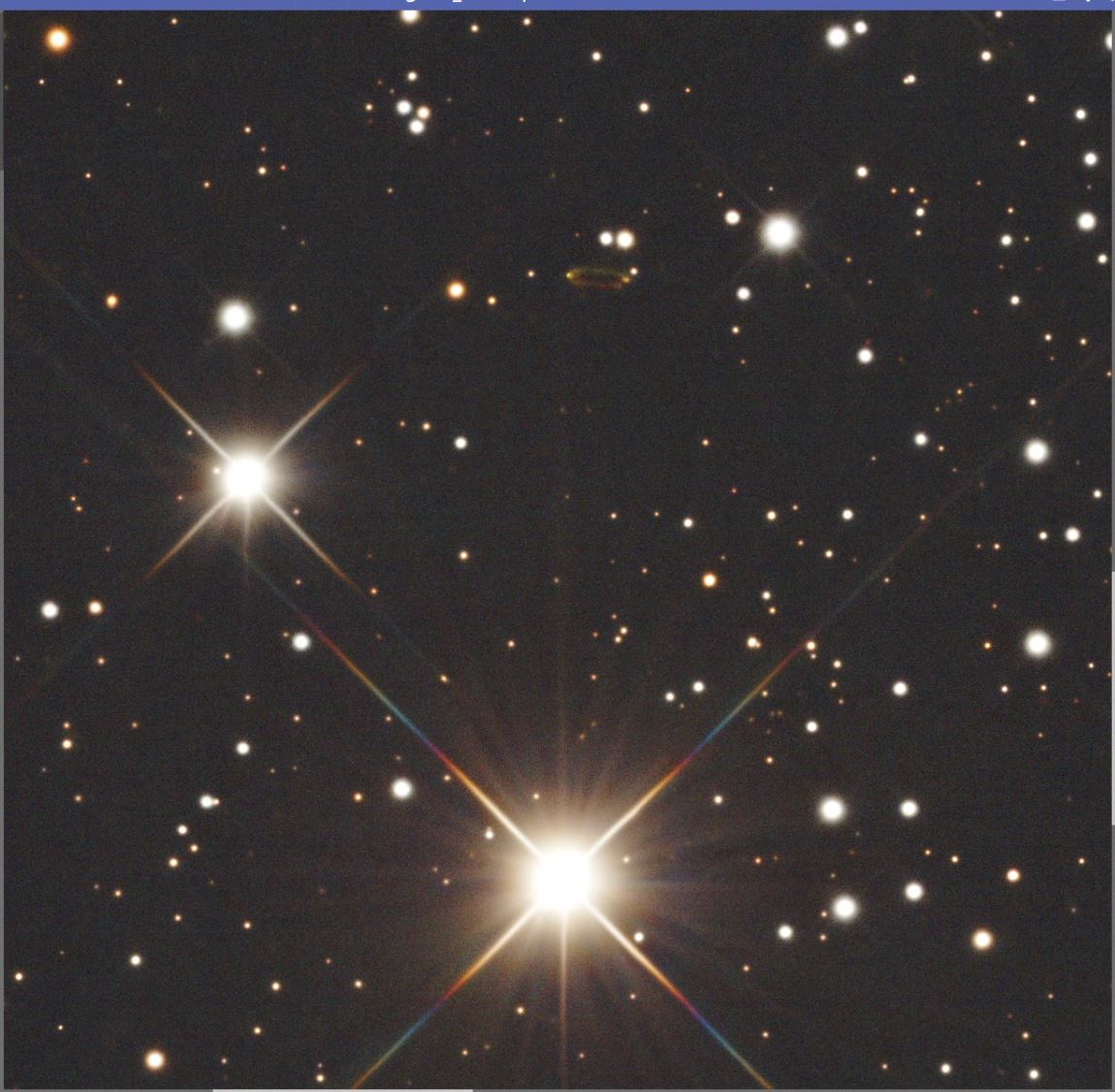

Not sure how things like this are reported, so we thought we would post it here for thoughts and ideas. Captured with a 16" RC telescope, using Chroma RGB filters, and a Paramount ME owned by myself and John Kmetz. It seems to be uncataloged. Coords are 1 19 44.93 +58 14 01.27 (cut and paste these coords into the link; it's not loading as it should automatically): http://cdsportal.u-strasbg.fr/?target=1%2019%2044.93%20%2B58%2014%2001.27 It's in the Owl Cluster, NGC 427, in the constellation Cassiopeia. It looks like a PN, which we have dubbed PF 1, for PhotonFarm 1, the name of our observatory in New Mexico, but perhaps it is something else all together? Any thoughts or feedback would be appreciated. Also, is there an official reporting process? It would be most embarrassing if this is a known object! We plan to do a narrowband shoot tonight, it may look very diffrent.   |

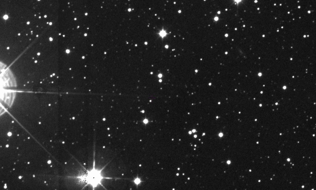

That's not a new discovery, sorry. Its more probable to be a flare or some type of artefact. If you want to do more research about some further cases like this, i'd suggest you search on Aladin and VizeR. Here is the location of your image, imaged by the UKIRT. Hope that help !  |

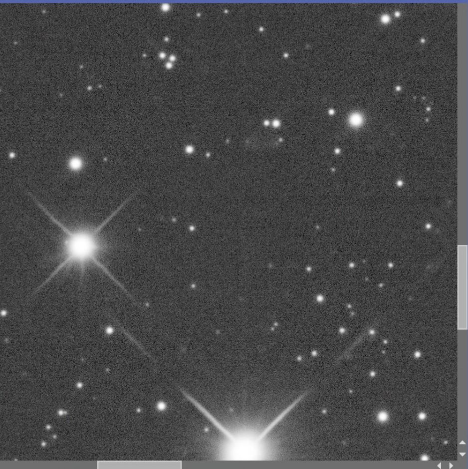

So you think this is a reflection artifact possibly? Here is an Ha image take this evening that shows a faint, but larger area. We moved the FOV a bit to see if that alters what we see, it seems to not have not moved, but perhaps we need to realy move the scope more.? I'm 70% on board with this being a reflection artifact at this time. Part of the difficulty here in my image is at a greater level of resolution that the catalog images. There was nothing visable in the Oiii.  |

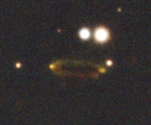

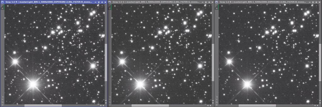

No you shoudn't. There is no object here, don't waste your own time. Such an object would appear in DSS/Other surveys like PanSTARRS, but there's nothing. One thing i would suggest is try imaging this position with another scope/look on AB for images of other to rule out the artefact possibility (even though it is one). Well, OK, but I have a hard time figuring out how such a distorted elliptical artifact might be created in perfect focus with two star-like lobes. This is an RC with two reflective surfaces. The same artifact only appears in the red and green images, and not the blue image. No similar artifacts are generated by the other two adjacent bright stars.  |
That's why i was suggesting to try with another scope to see if the object is still here (spoiler, it won't, or this would be the weirdest thing i've saw in my entire life). The artefact is indeed weird, i agree, but this can't be a PN or other type of object because in 4 years of archival DSO astronmetry, i've never seen such a thing. This doesn't look like anything, except a misshaped HHO, but the region doesn't contain any active object like these.

Not a lot of Ha, No OIII, No Hb (no object in the B channel), bright in RG(B) -> Not a PN.

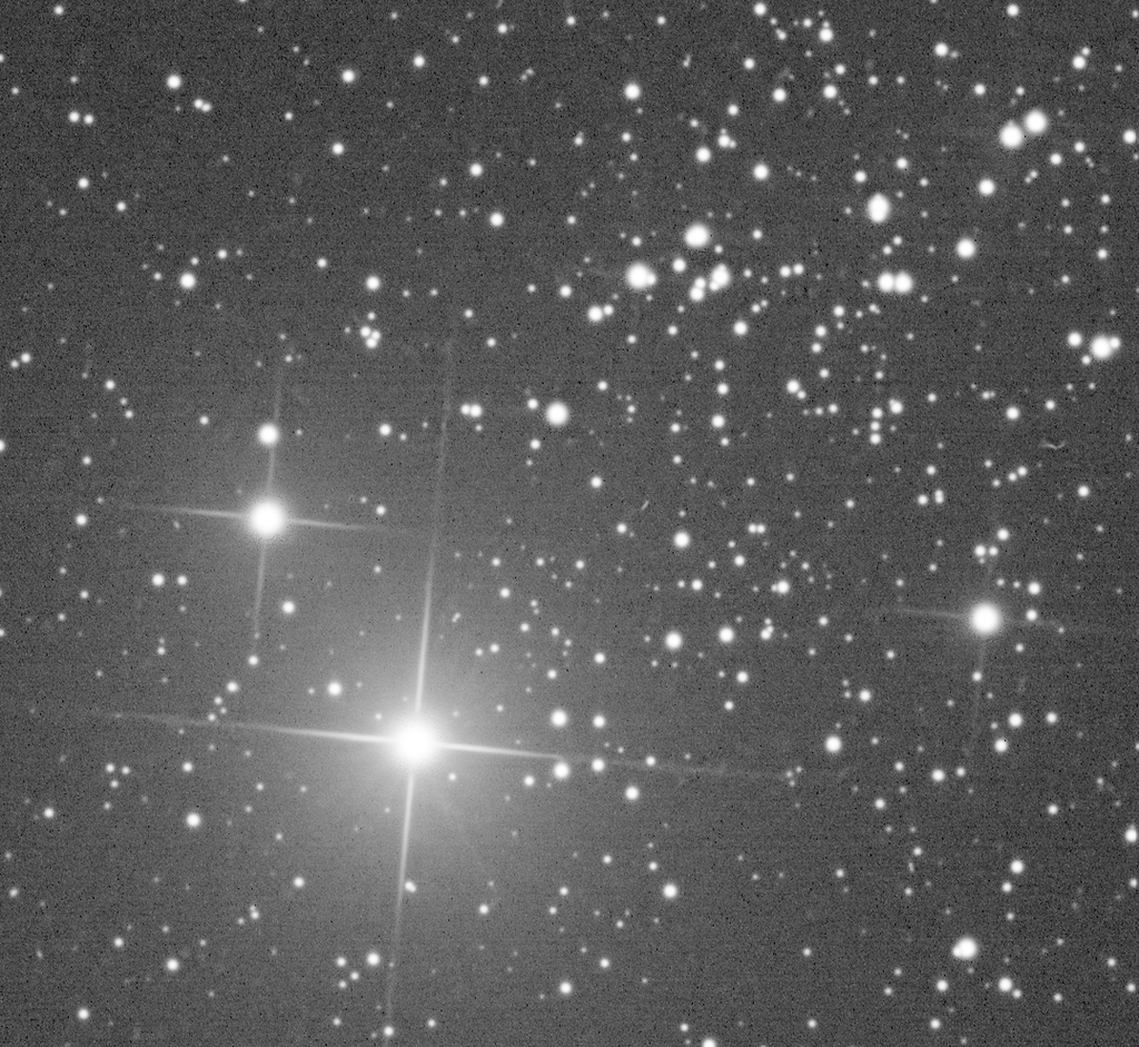

So here we go, using a remote 17" CDK with (what else) really really lousy seeing, with a total integration of 420s in L which should be enough to reveal if the thing exists. It does not.  |
Thanks for taking time to image. We have learnt that this is an artifact of the ONAG we are using. A reflection off of the back of the IR splitting mirror. It was so convincing being in focus. Alas a red herring!
