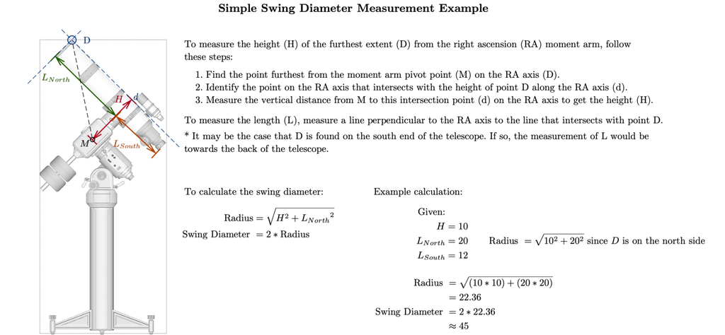

Here's a measurement that would really help me out. I need to calculate the distance from the frontmost top tip of the spider horizontally to the center of the RA axis when the scope is balanced on a mount with a normal mono APS-C camera setup (OAG, Filter wheel, camera) Then I need the vertical distance from the top of the losmandy plate to the stopping point of the above measurement. This will let me add my mount's center of RA axis to top of saddle to the second measurement then calculate the hypotenuse of right triangle these 2 measurements describe. I need the distance in the following diagram. My EQ6-R is 8" from center of RA to top of saddle.  |

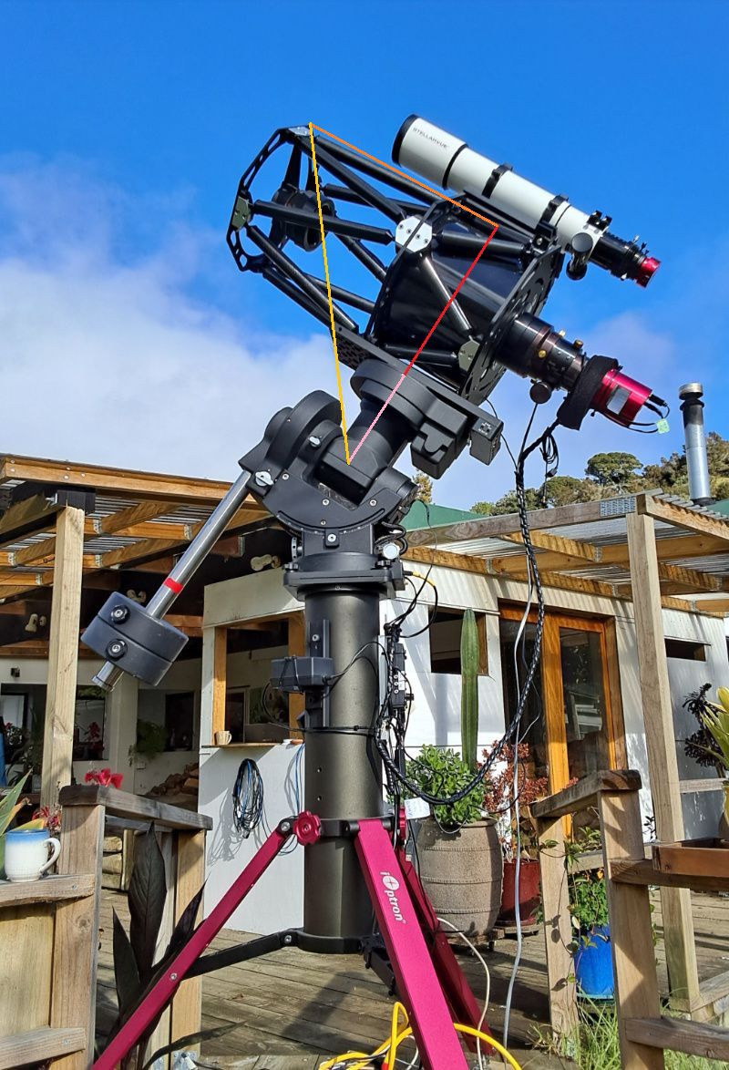

David, Can you measure the following 4 lines for me (orange, red, pink, yellow) Please notice that the orange and red lines form a 90 degree angle. Thanks so much.  |
I will measure this for you tomorrow John. its dark out there now and I am shooting.
Hi John. its difficult to get exact measurements in these dimensions but I have tried.
1. the Pink Line is about 205mm. this measurement is exact, 2. the yellow line measures about 775mm. this could be plus or minus 10mm
3. the brown line is in the vicinity of 500mm. this could be plus or minus 30mm 4. the red line is in the vicinity of 370mm. this could be plus or minus 30mm.
the total distance for the Red and Pink are approximately 575 but this is an estimate.
of the 4 measurements
1 is the most accurate. 2 is reasonably accurate. 3. less accurate 4. same as 3 above.
I tried to use hypotenuse on a triangle maths to work it out, but the result numbers did not add up right, so I know some dimensions are not perfect. I am no good at maths anyway ,but these were the dimensions I could measure.
let me know if you want me to measure things again.
Dave

did the measurements help John ? yes, thank you. 775mm is about 30 1/2” which is sad for me because I need it to be 29” or less to fit on a pier at my remote observatory.
