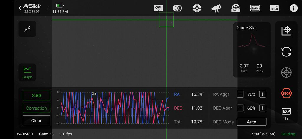

I am having weird issues with guiding - getting very high guiding errors. My guiding, when I start the plan, begins as bad as 8" in both RA and DEC, takes a long time to remain in 3"-4" region, and finally stabilizes around 2"-3". Could you please help me diagnose what could be the issue?
Guiding/Tracking Equipment: ZWO ASI120MM, WO 50mm guidescope, iOptron CEM40, ASIAIR
Telescope: WO 71GT APO, ASI294MC Pro, 120s exposures.
Settings being used: Standard ASIAIR settings without much changes.
  • Medium Gain, 1" exposures for guiding
  • Calibration step: 2000ms, Max DEC Duration: 2000ms, Max RA Duration: 2000ms

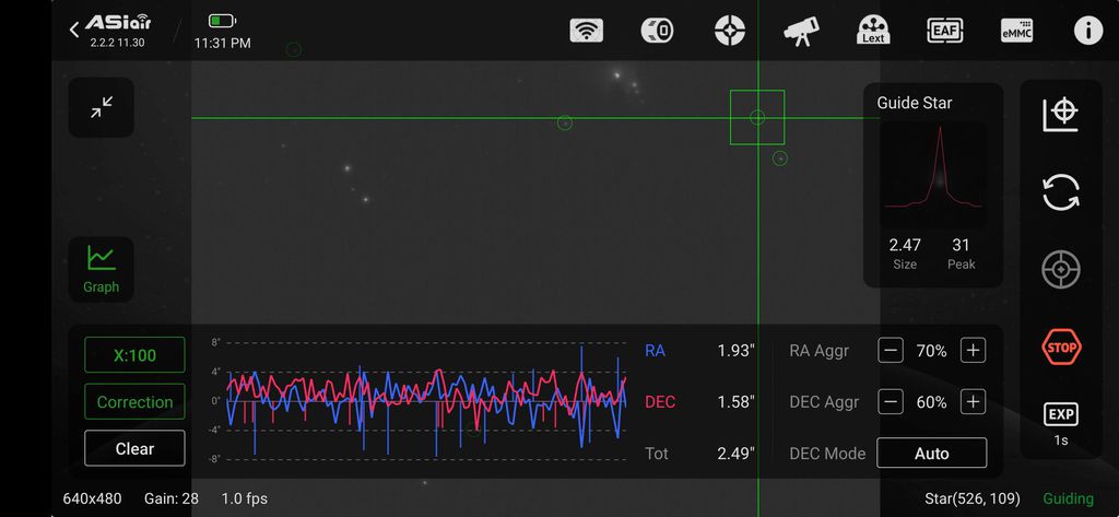

  • Dither by 2 px after every 3 frames. This is turning out to be a big problem that throws the accuracy to as poor as 20"-30" for about half a 20-30 seconds. I understand the mount moved, so it will become poor, but this seems really bad.
I did check the polar alignment too a couple of times - I polar align to accuracy within 1' (as per ASIAIR). I have been seeing people getting accuracy < 1", which seems like a very far fetched thing for me at this time (and is very disheartening too).
I am not using a field flattener at the moment, so please focus on the center stars. Posting screenshots of dithering and the image.

Can you please help diagonose what could be going wrong, or any settings I am not having correct? Appreciate all your inputs and help.

Quick update - I thoroughly reviewed the settings in ASIAIR and realized a blunder. I use a WO 50mm f/4 guidescope, and I had put the guide scope focal length as 50mm (instead of 200mm)! Instant fix, now I am getting guide errors of ~0.4-0.9" in either axis, adding to overall RMS of less than 1.5". Still a bit to improve, but glad to realize that my equipment is not incorrect, neither is the effort in coming so far unfruitful! However, will plan to go through detailed documentation to understand the nuances of guiding.
And the stars are definitely much more sharper now!
