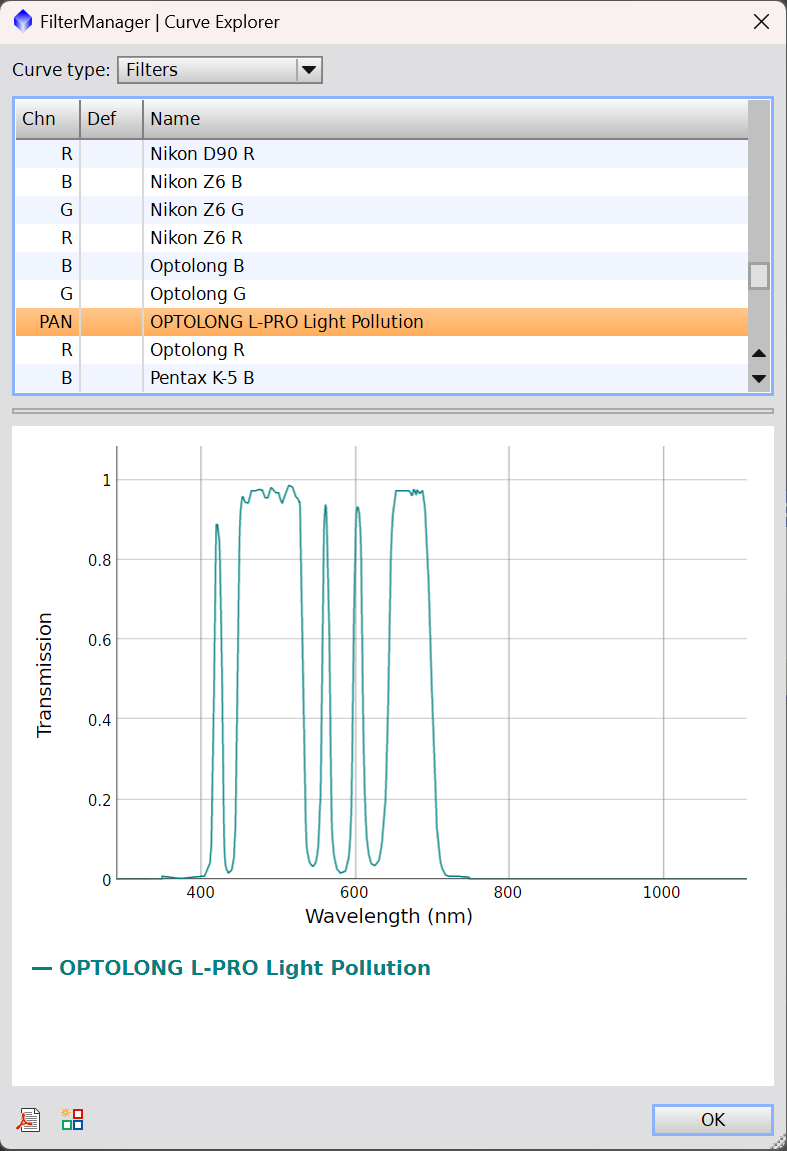

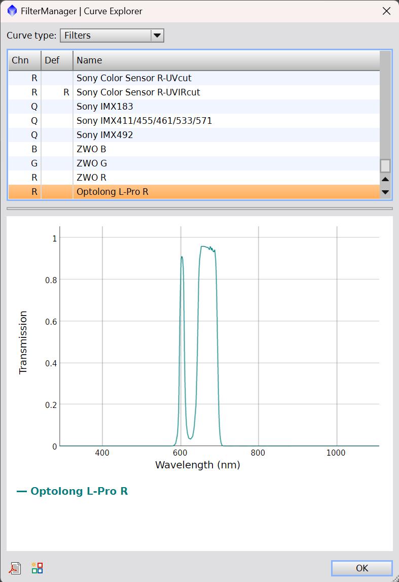

Even in the reprocessed image your color balance is way off, slewed far too much to blue. Given that you're using the L-Pro, SPCC might not be the best choice for color calibration. I mean, you _could_ try to model the R, G and B components of it by using the FilterManager process. Open up that process and click the Curve Explorer button. When you do, you get this:  As you can see, they have the L-Pro modeled. Now scroll through and control-click on some R filter. I picked the Baader R filter because it gave the most complete coverage of the R spectrum also covered by the L-Pro. When you do, you'll see both graphs overlapping:  Now you click that icon next to the PDF and it pops up a save dialog:  Enter a name (I chose L-Pro R) and the channel (in this case R) and click OK. You'll have the new filter:  Repeat the same for the G and B channels:   Once done, click OK and then choose "Yes" to save them when prompted. Now, when you open SPCC, you can choose your newly created filters:  Running SPCC now should give you a better color balance from which to start  .
Jonny Bravo: Even in the reprocessed image your color balance is way off, slewed far too much to blue. Given that you're using the L-Pro, SPCC might not be the best choice for color calibration. I mean, you _could_ try to model the R, G and B components of it by using the FilterManager process. Open up that process and click the Curve Explorer button.

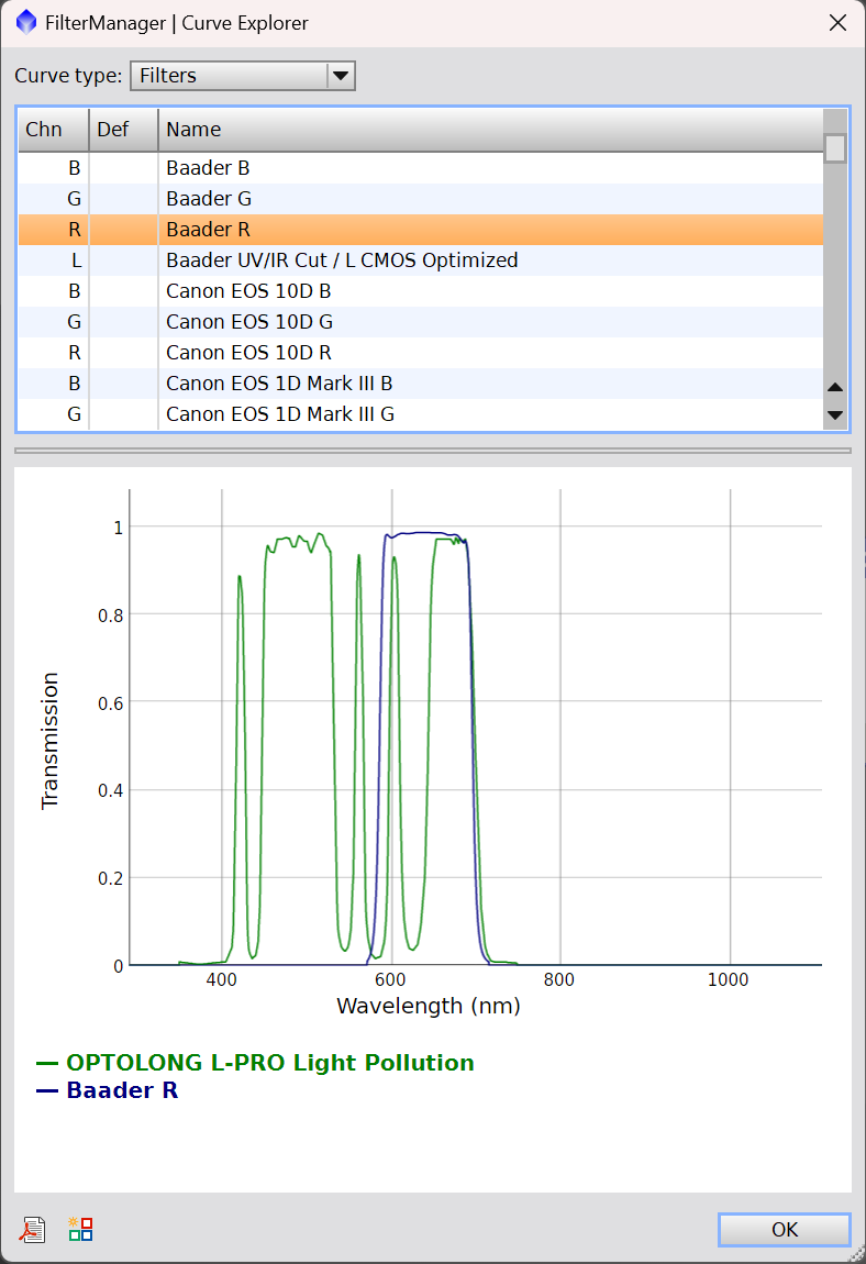

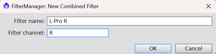

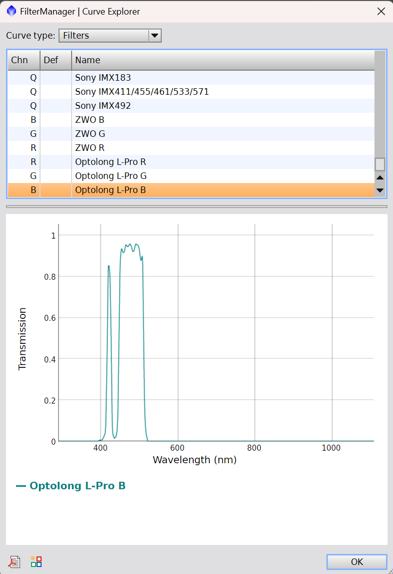

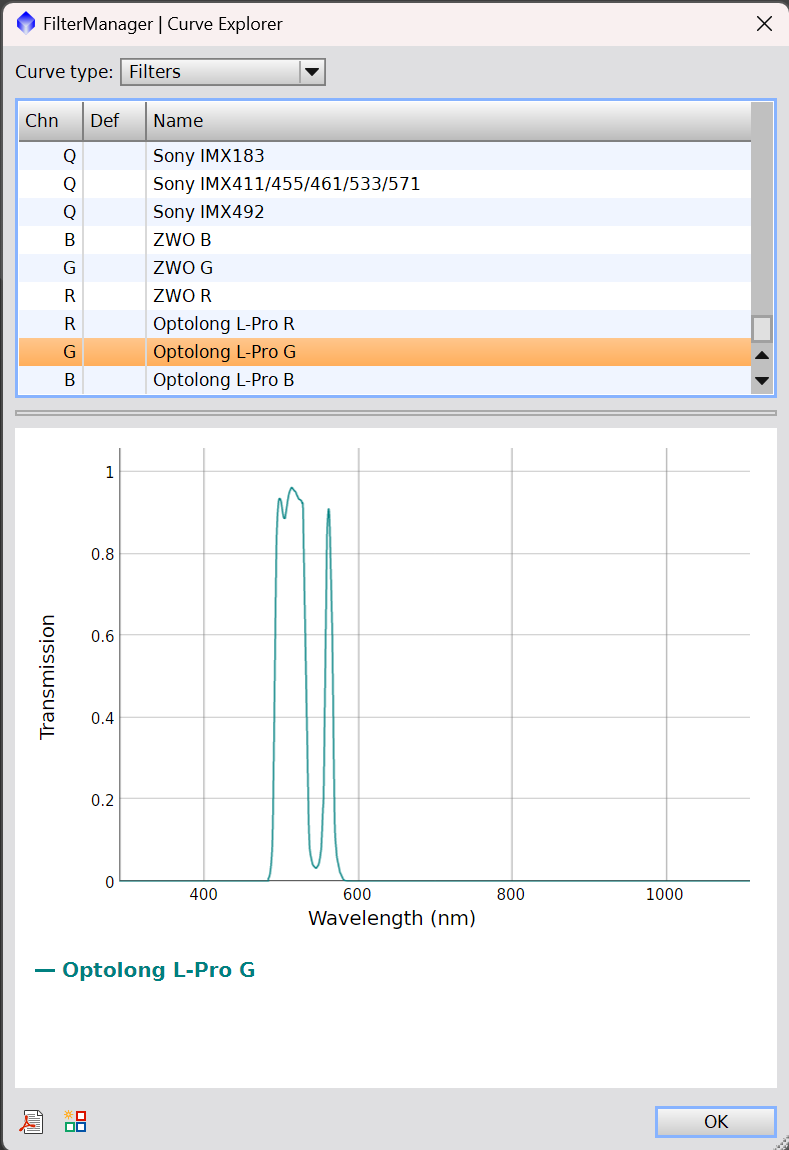

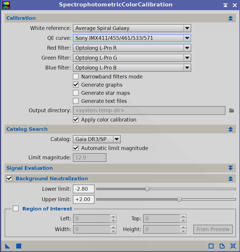

Running SPCC now should give you a better color balance from which to start . Wow! This is incredibly helpful stuff here. I can’t wait to try this out. I really appreciate the thought and effort you put into this response. Many thanks!
