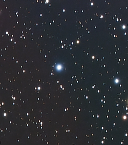

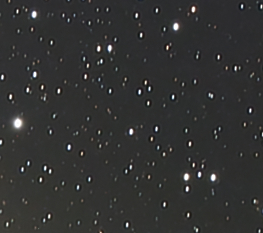

Can you tell us, what equipment you used? I'd say considering it's only 36 min, it's pretty good. But I think the color balance is off, how did you calibrate it? Also, all the stars have a black ring around them, so something went wrong there.

Hello. Did you happen to pass a layer of UnsharpMask? There seems to be some ringing around some of the stars. Anyway, amazing result for 36 min of data.  |

 I am very new to astro post processing, so I may not have complete context. When I used background removal in pixinsight (either using dynamic background extraction, automatic background extraction, setiastro - which ever method I tried, and however accurate I tried to be with the placing of squares/sizes/thresholds), I would have that donut which you are talking about. SO i ultimately gave up and did not bother with the background extraction in pixinsight. Moved straight to spectrophotometric color calibration, noise removal, followed by histrogram stretches, masked adjustments, etc. I did try deconvolution, maybe that is why the stars have black edges around them? That is why the gradient still shows up.
Anyway, amazing result for 36 min of data. Could it be because I tried to do deconvolution almost somewhere in the later stages of my workflow? I also did contrast adjustment, but that is unlikely to cause the ringing?
