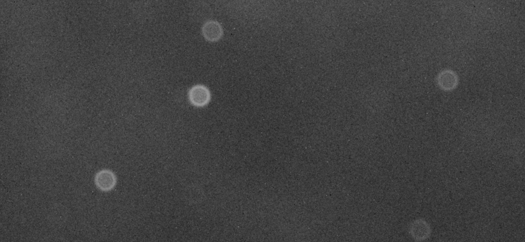

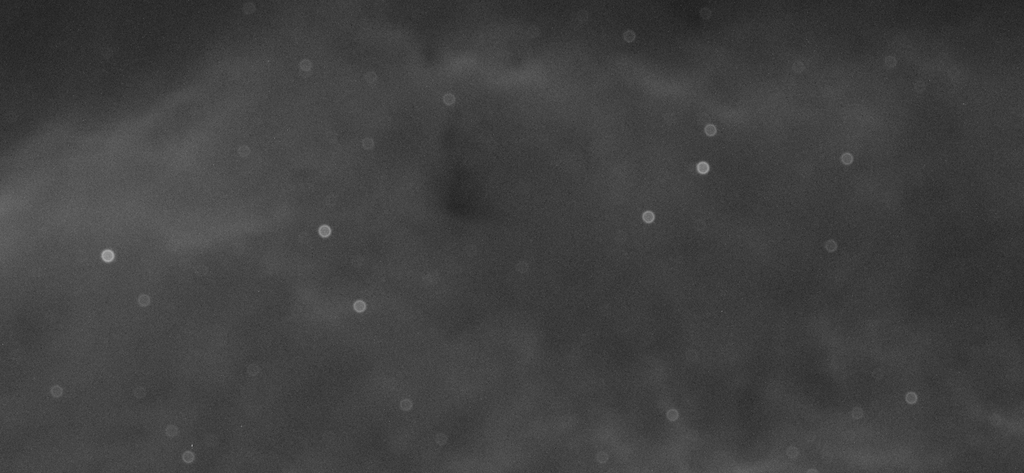

Hoping to get some help from the group on an issue I had last night while imaging the California Nebula. I installed a brand new Antlia 3nm 2" Ha filter in my filter wheel and quickly discovered there was something wrong with the images. Perhaps to complicate matters, it was also the first night of imaging with the WO FLAT GT flattener: https://williamoptics.com/products/flat-gtI have the GT81 WIFD and wanted to start imaging at the native focal length of 478mm. Below are the images in question (single 300 sec image). I also shot with LRGB and the images looked great - pinpoint round stars all the way to the edges. It only seems to be affecting Ha. Focus, backspacing, and guiding were all good. Any ideas what this might be? I know there have been reported issues with star halos on some Antlia filters, however, these images do not resemble those that I find online.   |
It's out of focus. There is always a focus shift with filters like that.
Out of focus, quite a bit so.
Agree with the above comments! Out of focus!
And those were my first thoughts as well as the images suggest, however, I've used the LRGB + Ha (different filter then this new one) and always maintained near perfect focus without adjusting between filters. Could it be the focus sensitivity between filters is amplified using the flattener only vs. the .8X reducer/flattener that I've always used up until last night?

You're over thinking this. If you've spent any time at all looking through a telescope visually or at least manually focusing on a screen, you'd recognize what's happening right away. It's basic astronomy 101.
Very simple, out of focus. Just refocus or configure a filter offset in NINA.
You haven't specified the model of your LRGB filters. What you were expecting is parfocal filters of same thickness, meaning they all roughly focus at the same distance, and clearly they are not.
I don't think that perfectly parfocal filters even exist anyway. You should always refocus after switching filter, or have the offsets configured. As little the difference may be there will always be one.
