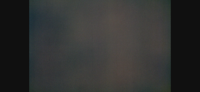

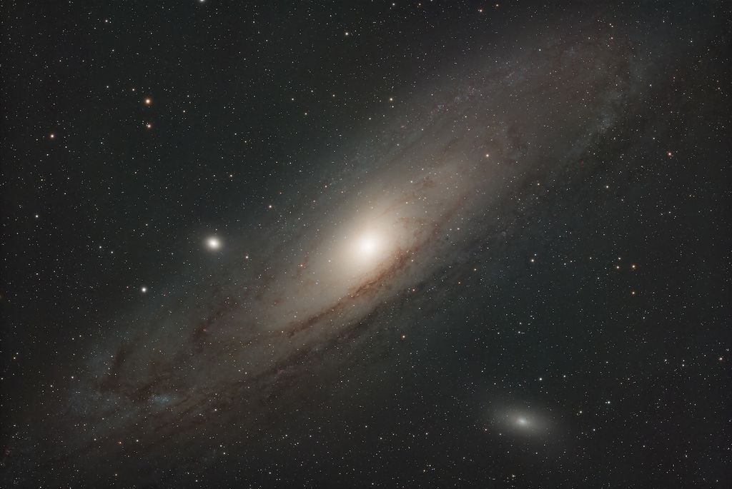

Newbie here. I've had a couple of sessions with this (almost) all-in-one unit and am noticing some banding issues. Both times, my results showed prominent green and magenta banding, which I'm not sure is normal. I read that this can be due to cables and power sources, so I've tried a combination of these, and the banding is always present. Given my inexperience with this new equipment, I hoped to get feedback here. I'd guess that this is the result of underexposure. If you look carefully you can see these in a processed image. TIA, Sean   |
If that first image is a flat sub, that looks normal to me when viewed through the ASI app. I'm pretty sure that's how mine look. It doesn't look that way in Pixinsight.
Some of this banding seems to come through after I stretch the image. IDK.
If that's a flat frame, there shouldn't be banding. What setup are you using?
That is a flat I was using to understand why I was seeing this in my resulting images. Askar 103 API + ASI2600CM Air.
What gain is the 2600MC Air set to?
And what did you use to get your final processed image?
I don't readily see the banding in your processed image, there is some gradient of some sort. I do believe when viewing anything in the Air app you are looking at a very compressed, processed JPG so I wouldn't go buy that view as a true example of your flat. Open it is Pixinsight or some other processing software.
Gain: 100. I used PixInsight but have since found some scripts to better deal with the gradient and background neutralization for an image I captured this Tuesday. Okay, I just checked one of the flats in PixInsight; it is evenly gray across the frame. I was thrown off by the view in the ASIAir. I appreciate the help.

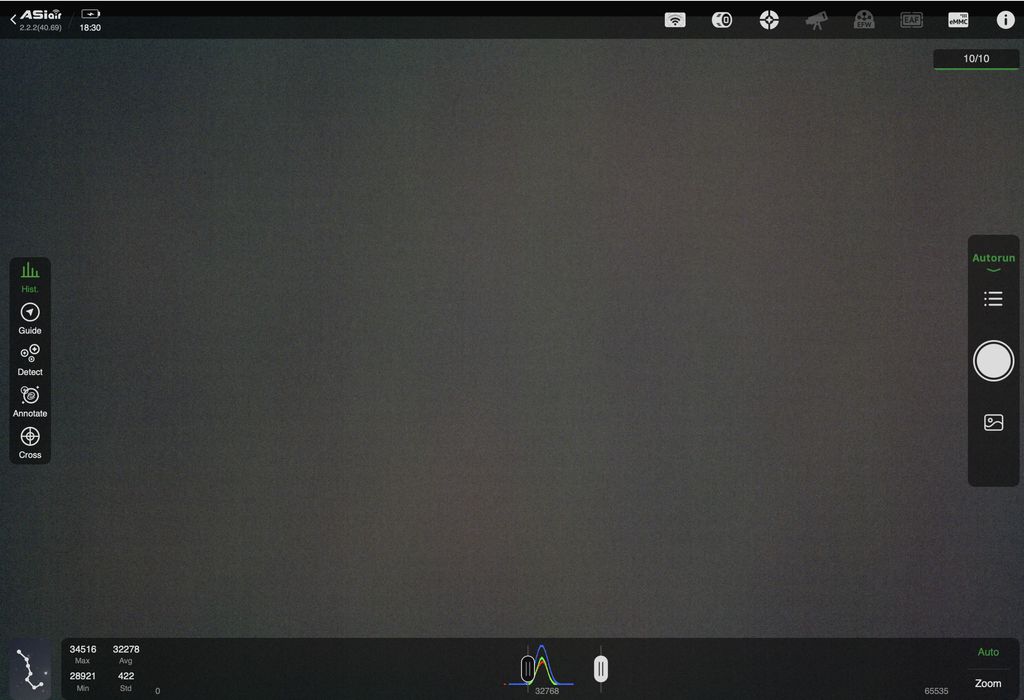

Sean, I thought of something else that might cause the banding, although you say it looked fine in Pixinsight, but if you are using a light pad for flats and have it set so bright that your flats are very short exposures (a fraction of a second), you may be catching banding from the electronic light. Adjusting the brightness to it's lowest setting (assuming you can), will cause you flats to be longer and will eliminate this. Like I said earlier, it may just be the look in the ASI software. I do have sort of the same hues when viewing mine through ASI, but not really the banding look (well maybe one). Rob Here's one of mine:  |
