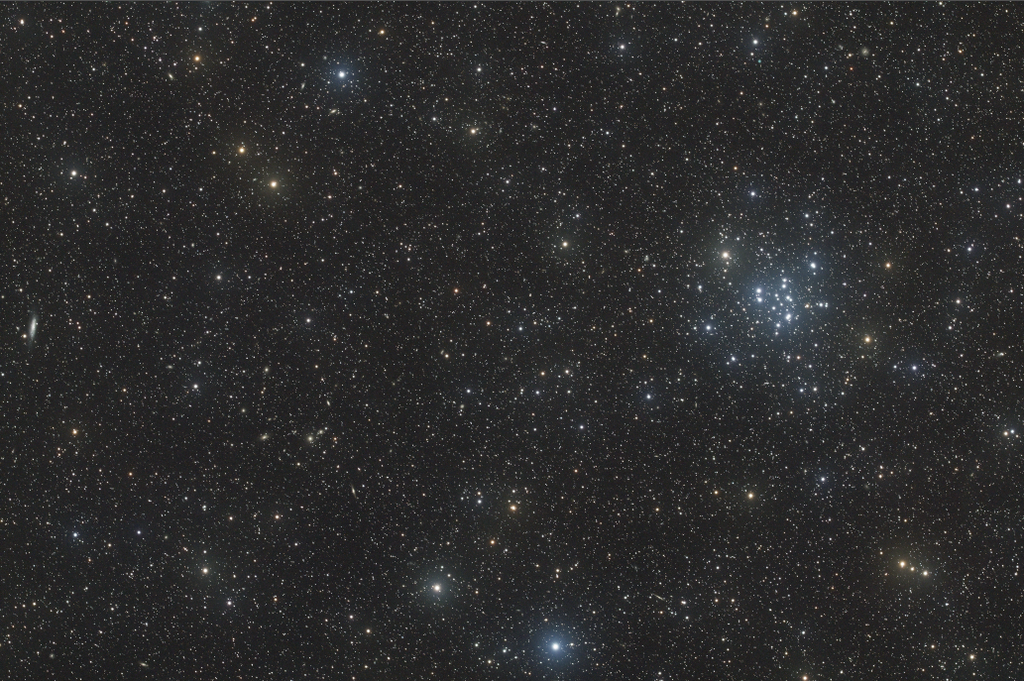

Last night I shot M34 as I fancied trying to capture some of the faint tiny galaxies nearby too.
I've processed the frames and it resulted in this

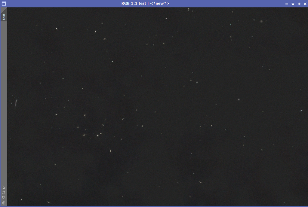

I rather like it, but I've been wondering if I'd like it more without the misty glow around the stars. It's already been through a round of Blurxterminator, so I thought about trying Starxterminator. That produced this as its "starless" image.
It's picked out the galaxies impressively well, but I can't think how to reduce the mottled misty bits .

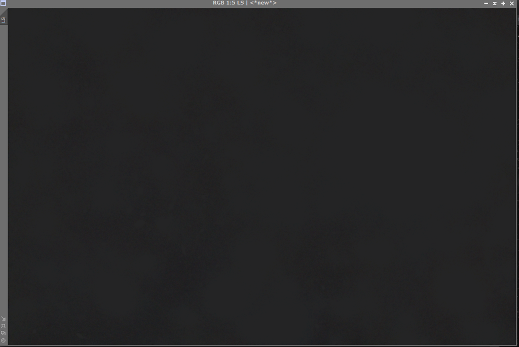

Duplicate your starless image and name it "LS".

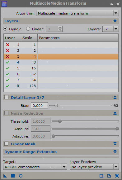

On this duplicate, run MultiscaleMedianTransformation with seven layers and layers 1-3 disabled:
With pixelmath, combine the new LS image with the original starless image with this code:
$T+(iif(LS > median(LS), median(LS)-LS, 0))
Keep this checked.
Result looks like this:
(I used your PNG images so shit quality)
Much better, no?

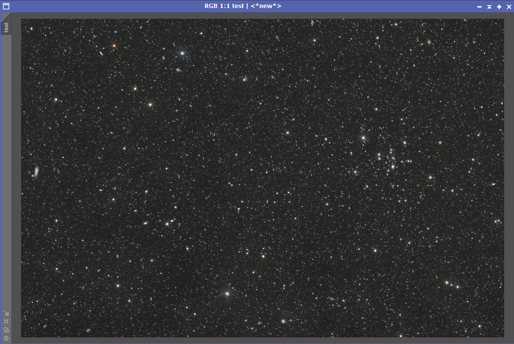

Combined with the stars:
Voila!
There is much room for improvement.
Have fun

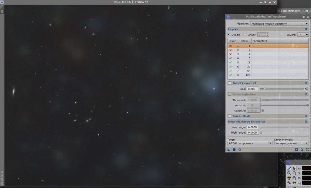

I must be doing something wrong though because once I've run  MultiscaleMedianTransformation, on the duplicated image, it looks just the same;
and when I run the code you suggested, I get this....
It'll be me!
*Are you running on a linear image or a stretched one?
PiersPalmer 2.81
Sttretched. Is it as simple as that?
I'll try again.
