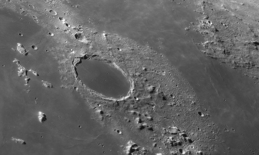

Dear AstroBinners,
I was wondering how close can one get to the surface of the moon.
I assume seeing is the big limiting factor here.
Here is an image from LRO, the Tenerife mountains under Plato;
Is there anything even remotely similar to this scale at a good resolution here on Astrobin?
Feel free to share your examples.

Here is my image of Plato that includes the Tenerife mountains:
https://www.astrobin.com/full/gsdrko/0/?nc=collection&nce=30770&mod=&real=

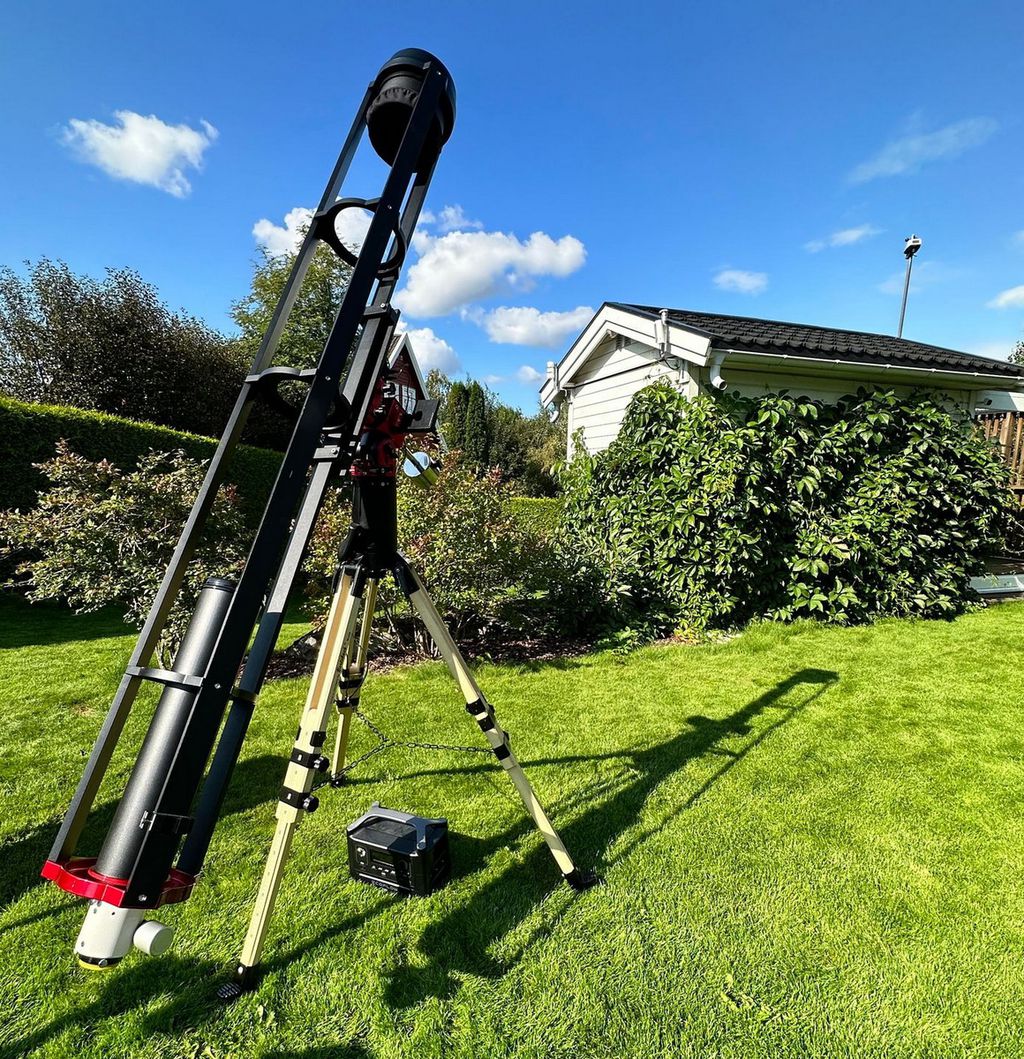

Definitely not most close up, but here's a 6 frame mosaic of an 79,6% waxing Moon I made with an 8" f/12 refractor:

I would love to know more about your 8" refractor...
It's an iStar Asteria TCR 204 f/12 refractor that I bought second hand about a year ago. The main usage of the scope is for solar imaging.
Really neat, unwieldly but wonderful!
