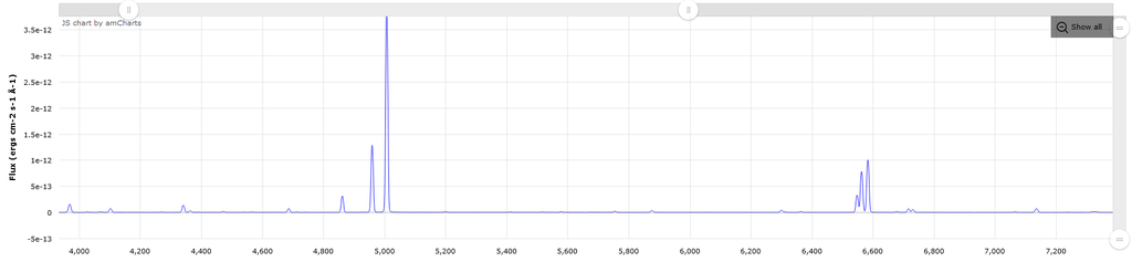

Which one of the two NII lines? Otherwise you can help yourself with some NB spectra such as: M27:  In some cases you loose more from ignoring Hb than by ignoring the NII lines. Link to some PN spectra: https://web.williams.edu/Astronomy/research/PN/nebulae/search/index.php |
Thanks those are great links!
