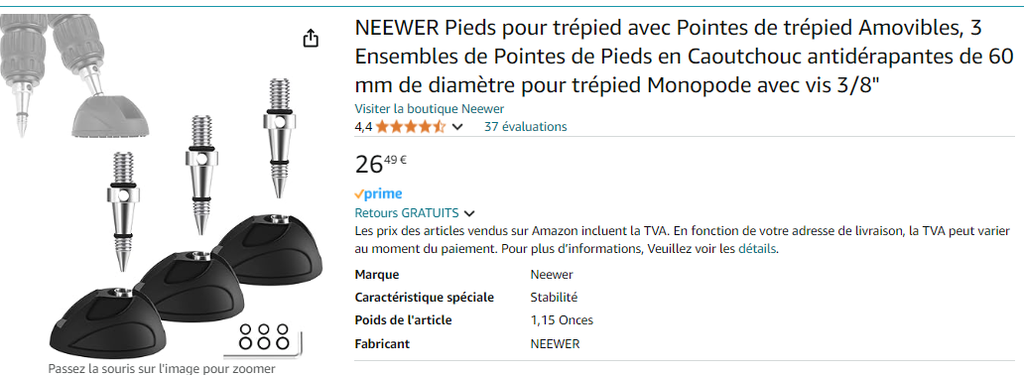

Yes  I am planning to do that with  about 5kg counterweigth and some weigt in the bag under the mount. The total weigth RC10 + my equipment will be around 18kg so it should suit as the mount is given to support up to 20kg. I plan to put the zwo tripod at the lower position for stability. I already changed the foot of the tripod with something less bouncy and more stable and I saw the difference even with Rc8.
I think the weak part is the ZWO tripod , if it seems too risky I will buy a heavier  tripod to replace the zwo. Now the Zwo tripod is given to support up to 50kg so... I will let you know once I have done my 1st try early next week.
below the foot I used in replacement the standard zwo TC40 foot

Hello Damien,
I got a significant improvment with the feet  I  posted here. I am using with the RC8 that is about 11kg with all camera, guiding scope and camera, etc...   I will give a try with the native Tripod and the RC10 and if it does not work I will go to the Berlebach tripod  (or a EQ6 tripo with a AM5 adapter that is also a possible solution less expensive).

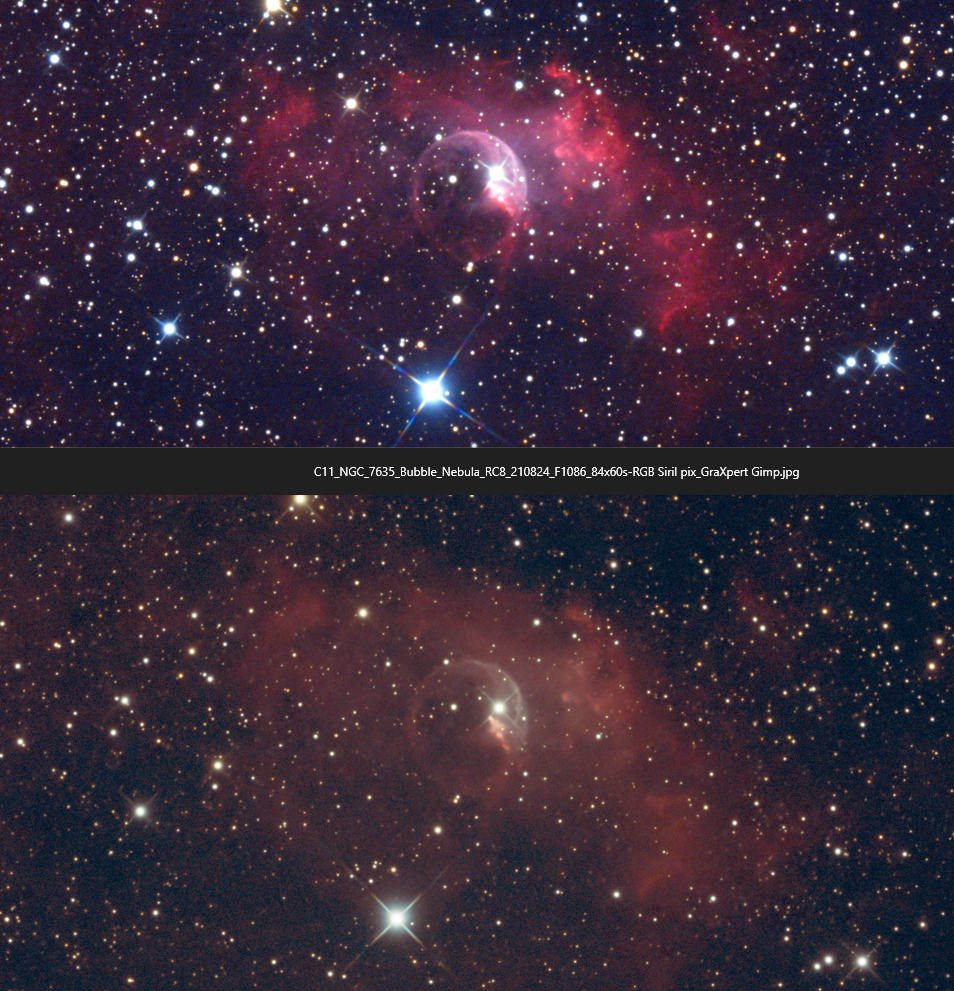

Hello,
I have done the 1st ligth of my new RC10 telescope 2 days ago and I can say :
- the AM5 can handle that telescope (18kg)  with no problem,  the zwo tripod is a little bit ligth and I have about 1s vibration when I  touch the tube, but it works. (I will certainly change the tripod)
- RC10 need the extension for the baffle, because I got reflexions when brigth stats are in or near  field. of view.  Extension ordered
- the picutres below taken with RC10 and RC8 shows that  RC10 is more accurate and detailled than the one taken with RC8. I took a 30min exposure picture of C11 and a  86 min exposure  the in RC8 , both with the same F/D 5.5 , same camera (touptek 2600c)  see  below (top image is RC10 , bottom is RC8)
dgalanaud 1.20
Very nice, congratulations.

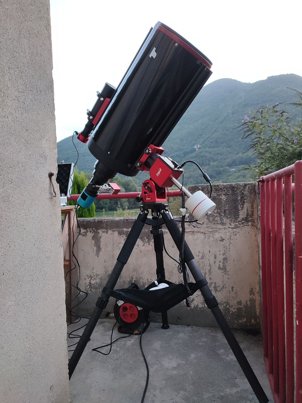

Damien,
It tried different combination of the mount lower, higher, with the extension tube and without . Also  I tried pull the mount with the scope on it (with caution of course)  to see the behaviour  of the mountand each time it returns on the tripod feet. So unless a dramatic event , it seems to be stable enough.
Now, the main issue are the vibration when you touch the tube that stand for about 2s  and the vibration have their source in the TC40 tripod. So I will certainly buy a Berlebach tripod.
Below the scope. I attach it to the AM5  at that position because it is the position where the weigth is in balanced (all the main weigth is in the miror part). You can see I put a 4.5kg counterweigth and I have 6.5kg in the tripod bag.  The total weigth (scope + guide scope + camera) is between 17 and 18kg. The AM5 moves everything with no  effort.

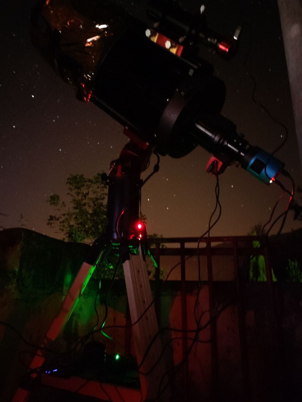

*** Ecrivez votre réponse ici **Hello evrybody , I have upgraded the tripod with a berlebach uni18. I was not confident in the TC40 to hold such a big tube , specialy when I saw on FB that a guy got one of the feet tube enter fold by itself causing its C8 to be broken.
