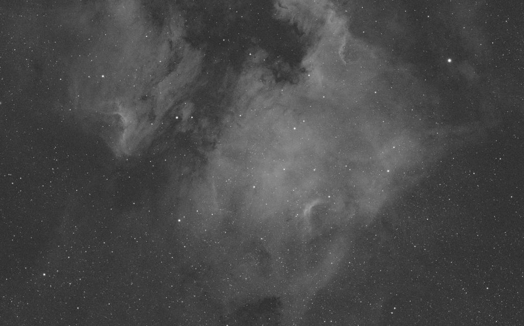

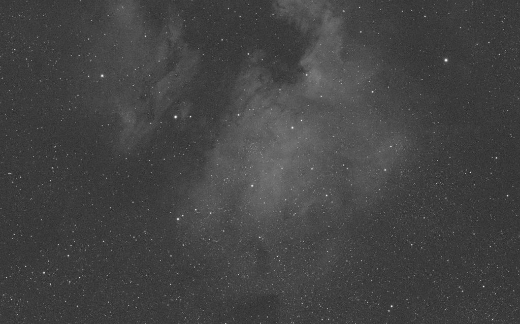

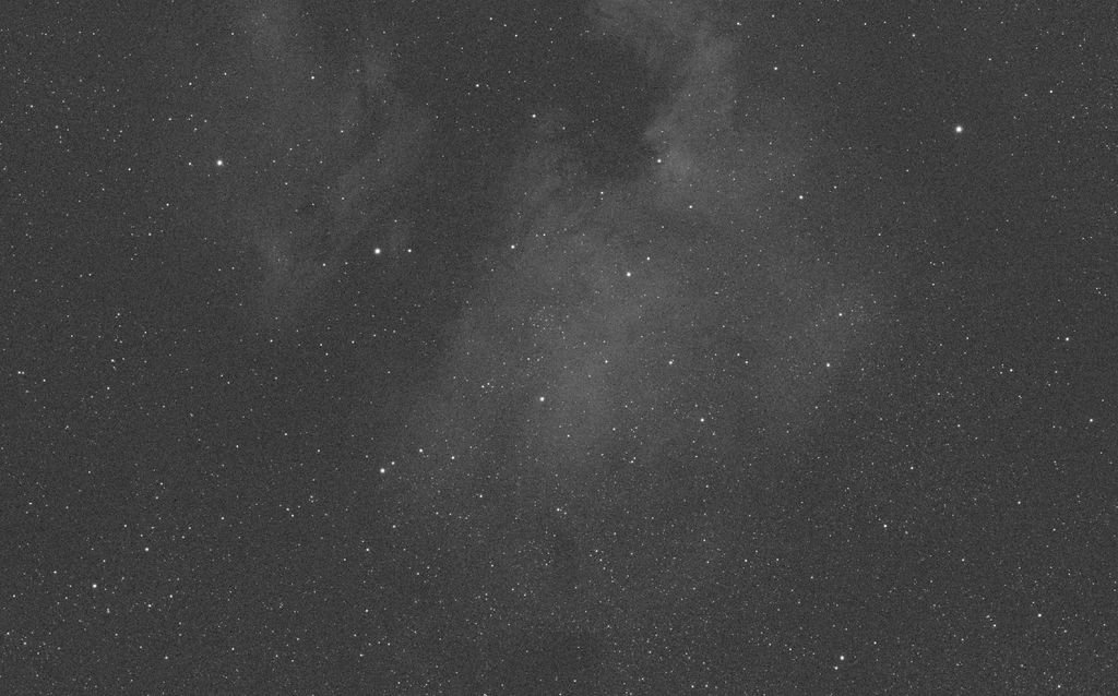

It works quite well for Ha, but makes OIII quite noisy and weak (no surprises). Otherwise I'm happy with it, only limited halos around bright stars. See a picture 4 days after the full moon - 24th August at 02:25. Single 300 sec exposure, R, G and B channels (screenshot from PI, not full res picture):    |

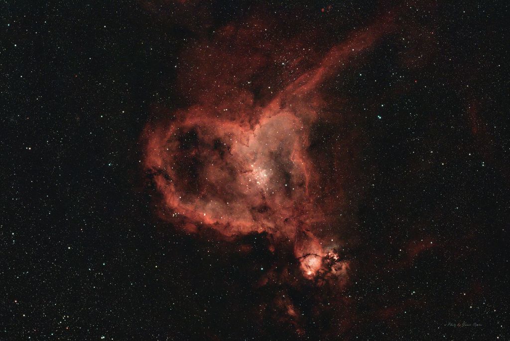

I was able to give this a test. Only had time for 54 x 300 second frames under 98% moonlight (no calibration frames) The L-Ultimate is pretty awesome to achieve this 👍🏽 I'm going to add more data when I get clear skies again. Thanks everyone 🙏🏽  |
