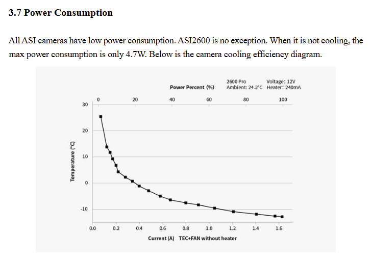

  With both cameras and the Asi Mini you should be fine! What are the specifications of the dew heaters? ASI2600MC: around 2A ASIAIR MINI: around 0.21A ASI224MC: Im not sure about the camera, but my 120MM mini takes 0.1 = 2.31A 0.69A are left for the dew heaters. If they draw much more, you should use a second power supply. Make sure the power supply is supplying at least 5A at 12V!
0.69A are left for the dew heaters. If they draw much more, you should use a second power supply. Make sure the power supply is supplying at least 5A at 12V! Hello Armin, They are omegon dew heaters, they fit redcat51 and uniguide32 so there are quite small.. i could not find the specs! Then it’s worth buying the cable! Can’t wait to see if it works, that would mean the only « loose » cable would be the one connected to the AM5N  Thanks for your answer !

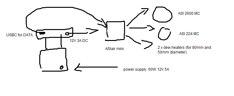

@Christian Großmann thanks for your experience sharing ! I' may have not be very clear in my first post : My idea is to power supply the mount with a 12V 5A (from a 220V adaptor) on the principal power plug (not on the saddle) and then use the DC power on the saddle of the AM5N to power the AsiAir, then the ASIair powers the rest (cameras, dew heaters...). To be clearer, here is a wonderfull paint drawing of what I want to do  |

If they released the mount, incapable of powering their own ecosystem, what's even the point of the thing. Hello Alex, Thanks for the info! that means it should be fine ! I just wonder why they did not include the that cable to the AM5... the plug on the saddle is not a 2.1mm x 5.5mm, so the cables in the ASIAIR won't fit either.. Do you have any idea what should be the specs for this cable between the saddle DC and the ASIAIR? 5A I guess
I imaged with my new AM5 a couple of days ago. I ran the power supply to the mount and then the asiair off the mount from the sadde connector. I ran my asi6200mc — cooled to -10c — and guide camera off the ASIAIR. Everything worked flawlessly
ZWO don’t usually include power cables for whatever reason. I picked up a 12v 5a adapter from Amazon that works really well. I also picked up an Apertura battery that comes with every power cable you could ever want
@masslessparticleHello, thanks for sharing your experience ! OK you convinced me  Do you mind sharing the link of the cable on amazon? I'm afraid I'll buy the wrong one if not. Cannot find the specs for the DC type plug on the saddle... Thanks in advance, Clear skies
