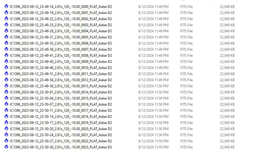

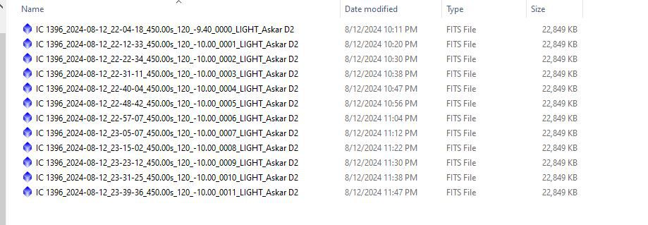

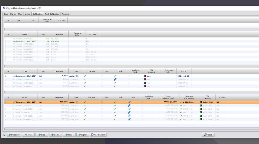

I always seem to have this problem where the flats and dark flats don't seem to take the keyword that the lights and darks do. I usually build my folder structure to include, for example, IC1396_N1, IC1396_N2 and so forth. When I do this the lights and darks use Keyword N1 or N2 but the flats and dark flats use the date. I'm not quite sure what I'm doing wrong...
I had to manually change the one group of flats to 2023 instead of 2024 in order to keep them from lumping in with the other flats taken the same calendar day (shot both tonight and this morning after midnight in two sessions).
What might I be doing wrong? It make it so I have to manually link my lights to my flats and its kind of annoying... Thanks!
