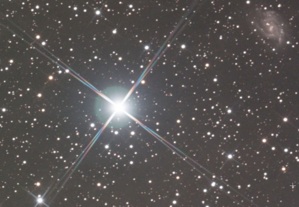

Hi, I know this is an old thread, but I have this issue with 20 hours of Iris Nebula data. Polar alignment was always under 1‘, mostly in the low 10“/20“ during the sessions, the spider vane is a fixed aluminium ring from Backyard Astro, is this possible to fix in post processing? I have BlurXterminator, StarXterminator and PixInsight so I hope this is fixable… 🥲 Because otherwise the data is perfect

Mina B.: Hi, I know this is an old thread, but I have this issue with 20 hours of Iris Nebula data. Polar alignment was always under 1‘, mostly in the low 10“/20“ during the sessions, the spider vane is a fixed aluminium ring from Backyard Astro, is this possible to fix in post processing? I have BlurXterminator, StarXterminator and PixInsight so I hope this is fixable… 🥲 Because otherwise the data is perfect Cone error. After registering all the frames use only one subset with uniform spike orientation for the stars and add to the starless version.
Mina B.: Hi, I know this is an old thread, but I have this issue with 20 hours of Iris Nebula data. Polar alignment was always under 1‘, mostly in the low 10“/20“ during the sessions, the spider vane is a fixed aluminium ring from Backyard Astro, is this possible to fix in post processing? I have BlurXterminator, StarXterminator and PixInsight so I hope this is fixable… 🥲 Because otherwise the data is perfect Cone error. After registering all the frames use only one subset with uniform spike orientation for the stars and add to the starless version. Thanks, I‘ll let the nights stack seperately as well then, or do a seperate stack with alright stars! Would be a pity to waste that amount of Data, 20h on Iris in Bortle 3 are quite something
This is due to spider banes that are not exactly symmetrical with respect to the Dec axis. If you think carefully about the orientation of the sky vs the scope, before/after a flip the vanes have been rotated by 180 degrees. Any inaacuracy in the vanes geometry will show.
You can prove it for yourself by choosing a field of bright stars at the zenith or meridian - take a short exposure that won’t show drift due to poor PA - long enough to show spikes - say 30s, then flip the mount and repeat on the other side.
Superimposing these will show the same issue.
It’s one advantage of a refractor, SCT or maksutov - no vanes, no spikes.
Just wondering if stacking the pre flip subs and post flip subs separately and comparing might help narrow it down?
It will - especially if you try what I suggest above.
If there’s no issue for targets at low declination either side of the meridian this implies the vane arrangement is good.
Another source of error is a non-perpendicular error in the mount between the RA and Dec axis. For a target near declination 0, the spikes from the vanes will be rotated by 2 x the NPE.
Conversely if it occurs only near the celestial pole it is likely to be cone error.
Mina B.: Thanks, I‘ll let the nights stack seperately as well then, or do a seperate stack with alright stars! Would be a pity to waste that amount of Data, 20h on Iris in Bortle 3 are quite something It doesn't matter if the star removal leaves no trace of the spikes. Just create a stack with your best stars all with the same spike orientation. And use the stars from that stack, rememberin to use it as the reference frame when you add all of them together.
Well, there is an alternative solution which would eliminate the whole issue - modify the scope by replacing the straight vanes with curved (circular) ones, bent to match a circle of the same diameter as the primary mirror.
No more spikes.
You then should be able to stack images either side of a meridian flip without issues.
Thomas LELU: Good morning all,
I am currently encountering, with another astrophotographer, a rather intriguing problem with our Newtonian telescopes.
I currently have a Newton ASA 10", very well collimated and very robust at the mechanical and mirror level. My colleague has an EPSILON 130ED which is also very well collimated and configured.
When we image targets close to the north celestial pole, we notice a significant field rotation between, before and after, the reversal at the meridian. Results, when stacking the egrets are split.
On the other hand, with lower targets, no problem.... !
I recall that there is no rotation of the tube in its rings, no rotation at the level of the optical gear etc....
We both use NINA software for acquisitions.
Thank you in advance for your help and opinion on the matter.
Good day Looks like some cone error to me.
