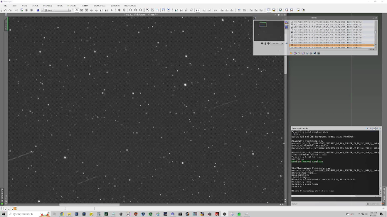

I imaged the Witch Head Nebula, NGC1909 a while back. Haven't done much because I have a fuzzy satellite train in it that I can't seem to stack out. I have tried several different rejection Algorithms including GESD. I have Large-Scale Pixel Rejection High enabled and I've tried both layers and growth at 1, 2, and 6. Nothing seems to even make it different. I'm not keen to throw away this data but I can't stand the fuzzy trail:
Here is the zoomed in blink from 110 of the 216 files...
Can anyone help me? Thanks!

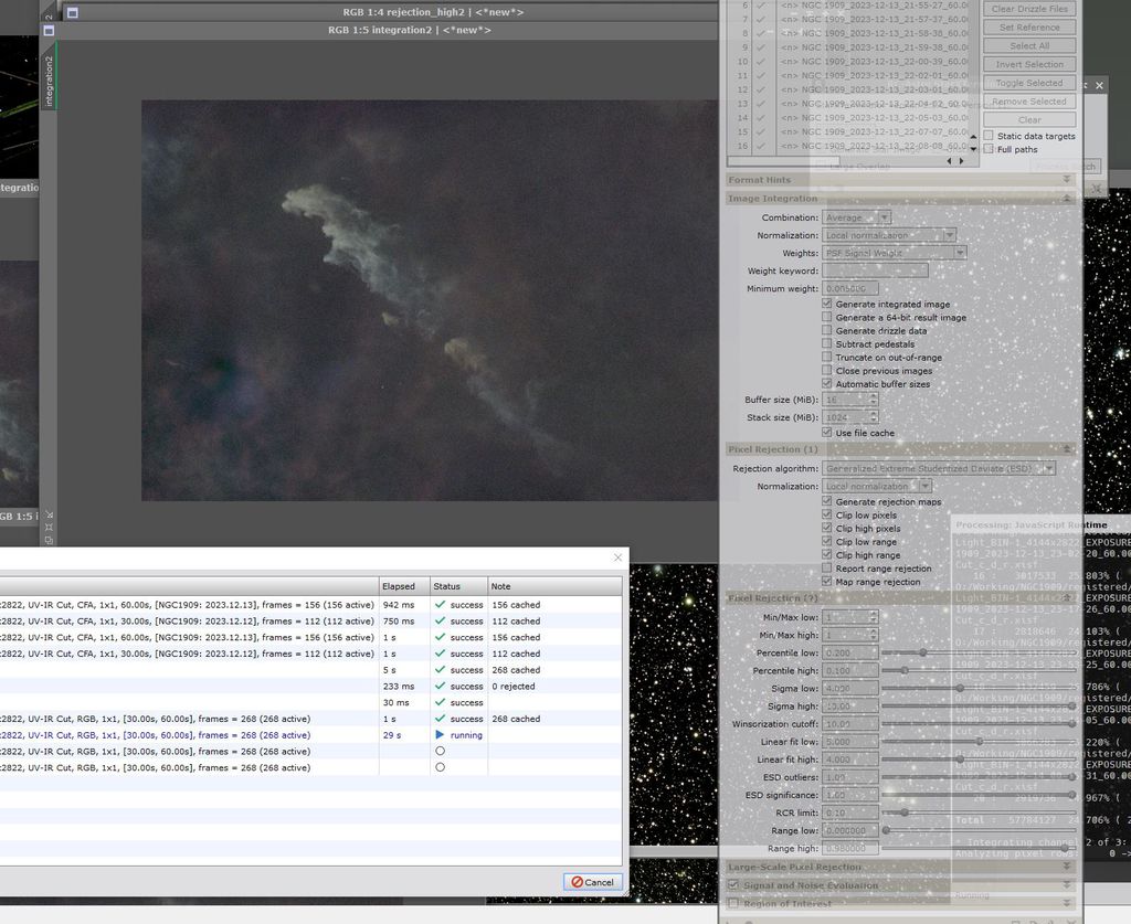

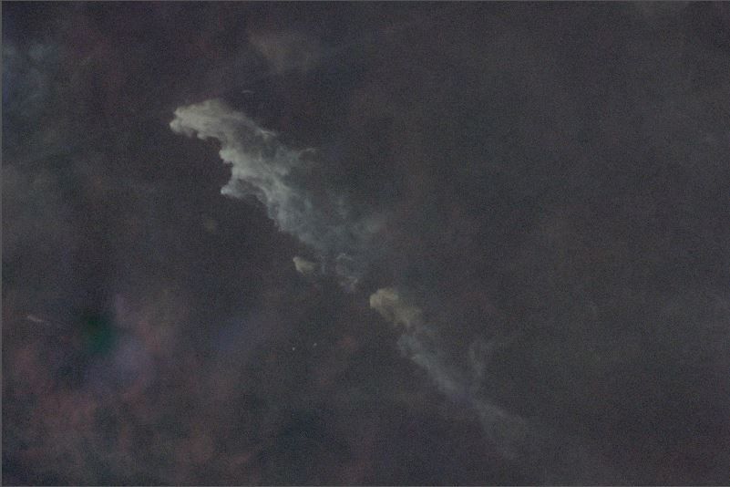

I think I got it... Forgive the WBPP, I am trying to duplicate my ImageIntegration settings. But if you look at the integration2 starless image you can see the trail is basically gone. I switched back to GESD (ESD) and upped my ESD Outliers to 1.00 and ESD Significance to 1.00 as well... And in Lare-Scale Pixel Rejection I turned on High and put both factors at 2.
Well, my attempt to get WBPP to give me the same results failed. The streak was still there. So apparently it only works in ImageIntegration. The only setting I can't find to duplicate is "Clip low pixels", "clip High Pixels", "Clip low range", and "Clip High Range". Now to figure out how to Drizzle after ImageIntegration...

So I can get the trail out but when I drizzle in DrizzleIntegration I lose a ton of contrast and detail in the Witch Head dust compared to the WBPP drizzle integration with the trail. Any idea why this might be?
mcchurchmouse 0.00
Ok, for those following along on the edge of their seats… I figured out that the high rejection is eating the detail from the Witch's Head leaving just formless clouds. So I'm starting to use the SKILL script to color over the satellite trails. 268 frames might take me a week but thats the price we pay for a good image, yes? So now I'm cranking down the high rejection and cranking up the low rejection… I'll report how it goes!
