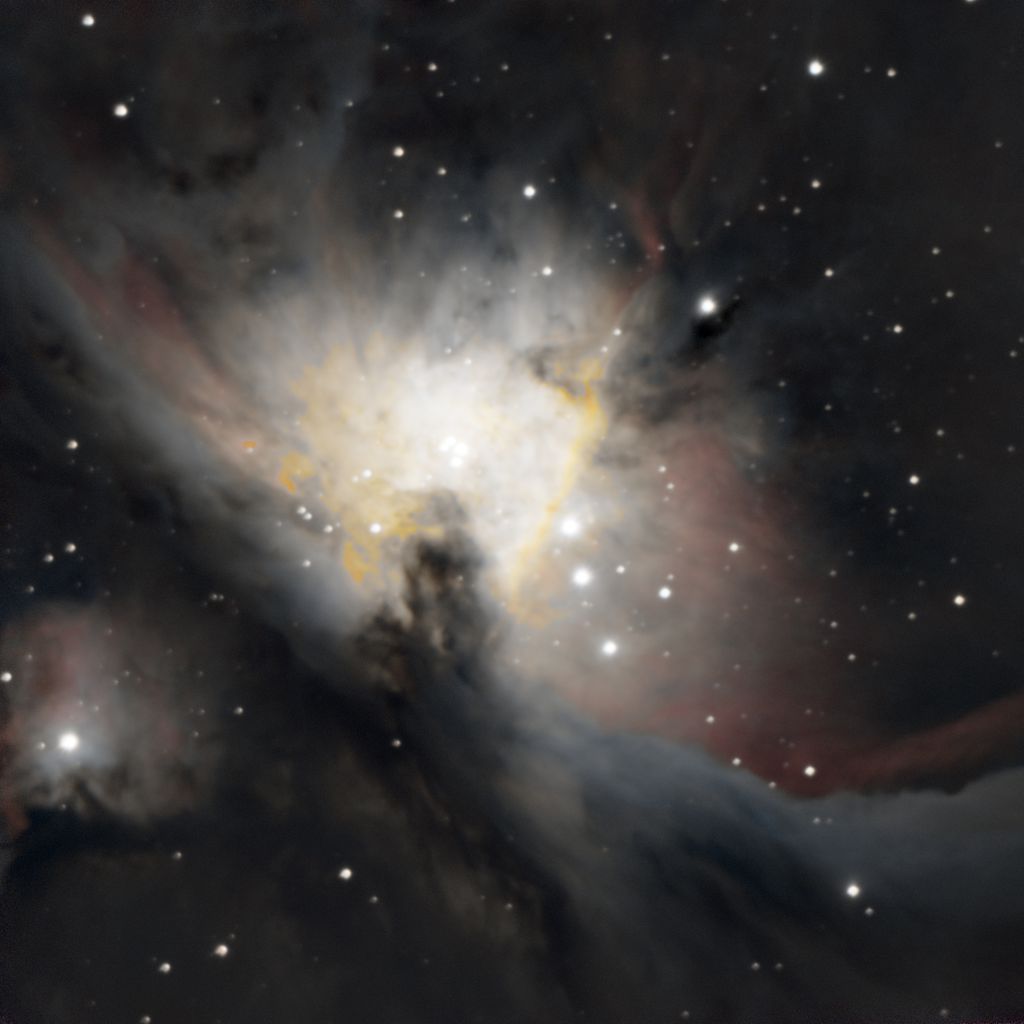

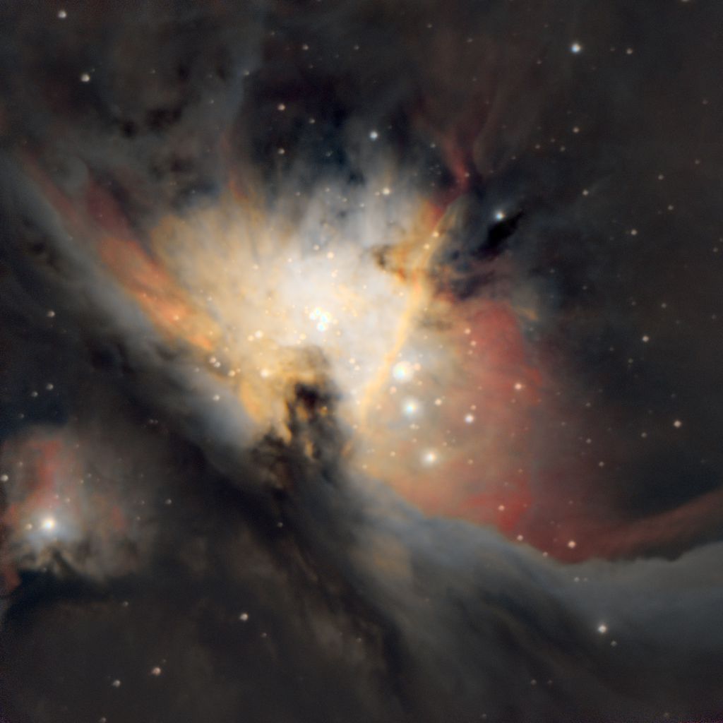

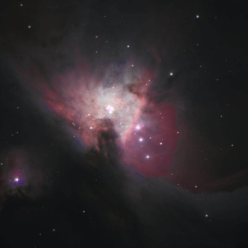

orion-2.JPGorion 3.JPGorion 4.JPGFirst time imaging -my son got me hooked on the hobby
Thoughts /Suggestions  on pictures.

Tom H:

Tom2023+ 0.00
Thanks
Any issues –should have had better focus ? Over processed?
tomtom2245 1.91
Tom H:
Thanks
Any issues --should have had better focus ? Over processed?
That's actually a fairly tough region to start with. It has a very high dynamic range so it can be tricky to get the processing just right. Especially if you are trying to show all the way to the trapezium. The focus doesn't look half bad. Are you using anything like a motorized focuser or bahtinov mask to focus? The third image IMO is the best. You don't have the sharp divide between color saturation like the first two have. Those almost look like you used a mask with a sharp edge that isn't feathered or anything.
docathos 0.00
Those are awesome! They look similar to my first image, taken a year ago on my 8" Evolution! Some things I did when I started…
- a Bahtinov mask is cheap and a no brainer for fast and precise focus
- That was my first image too, but I think I liked my initial pictures of galaxies better? Orion Nebula is a big target for that focal length.
- A focal reducer will give a bigger image and faster light gathering
- keep pouring in more money as you decide you'd like to level up (Pixinsight with some fancy tools, an equatorial mount, guiding)
- Your gallary says you're using a 533MM - I assume that should be an MC (ie colour camera, not mono) That camera should take you pretty far (I'm still getting much joy from my uncooled 585MC)
Also, I got quite a bit of happiness out of 10 min EAA sessions when I started, "OMG I can see a galaxy's spiral arms" lasted for quite a while.
Tom2023+ 0.00
Thanks for the advice - I finally got a  Bathinov mask – I will correct the mm to mc on the camera -
I also  bought the 585mc uncooled looking forward to planet season-  and testing it  out.
