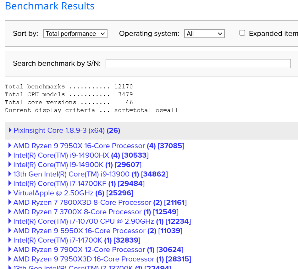

Well, if you are into using PixInsight, one thing to do is go to their benchmark page (https://pixinsight.com/benchmark/) and look up the performance you want.  See clip here: image.png
Click on the machine title and you can see more info at a high level of what the score was and the machine description:
Then click on the hyperlinked serial number and it will give you more details of the build:
So, pick the performance you want from the scores (and times to completion) get the info on the computer that gave you that performance, then price out the components.  Take some sedatives prior to the pricing, because to get that top performance you will be laying out a lot of money.  But if you price out components, then you can try to get into your budget range.  (Note: the above example has a comment "Oracle Cloud".  I assume this individual is not the owner of the stated computer but is buying time on the computer via cloud computing.)  Epyc processors, just the processor alone, cost multiple times what my whole machine cost.  If you use other processing software and methods, not sure how this data would translate.  In any case, pick the performance you want, with the operating system you use, get the data sheet like above, print it out and walk into a computer builder.  Point to the sheet and tell them to "make that"...
For "that" you save ~20 seconds of processing time (bench test comparison of above example to many common, and sufficiently powered users computers here.) if you use the example above and it will only cost you a small fortune.  If this is what certain people need, then I hope they are collecting only the very best data from the very best optics for multiple targets every night to need that kind of processing, which really is only marginally relevant to any of the software that is used for astrophotography.  For PI, the cpu count/ threads makes a real difference.  But these are really incremental, do not seem to scale linearly, yet the cost seem to scale logarithmically.  The PixIsight benchmark page is really interesting and the benchmarks have some utility during setup of a system.  What is sad is to see is for some of these super PC's benchmarked with killer CPU performance numbers yet the total performance numbers being essentially no better than my 5 YO build at $1200 because the user doesn't know how to set up the swap disks.  I sure hope what is displayed on the benchmark page is just their test results as they incrementally sorted out their swap disk setup to max performance.
Regarding GPU, I keep seeing numbers of performance, for times to completion for a SXT run, of about 3 minutes for those who report that info here.  What is remarkable is that my RTX2070 with 4GB of RAM gets the job done in under 3 minutes on an image that is 12,504 X 8352 pixels.  That is compared to newer and more highly rated GPUs.  So yes, GPU acceleration for just these few tasks makes a difference, but I have yet to see numbers that relate to any significant boost in the performance characteristics, TFLOPs, GPU RAM, etc. of the GPU to SXT time to completion.  To me, this indicates that the type of activity that the makers of these AI-based tasks are not using the higher level capabilities of the GPU at all.  Certainly it seems that multiple GPUs would be a waste of time, currently.  I remember when I first started to use the AI-based functions available to PI users or as stand alone, the builders of these softwares stated in their documentation that the best thing to do was to get the rather lower end, less expensive GPU to employ their software.  Clearly that advice still seems relevant today.

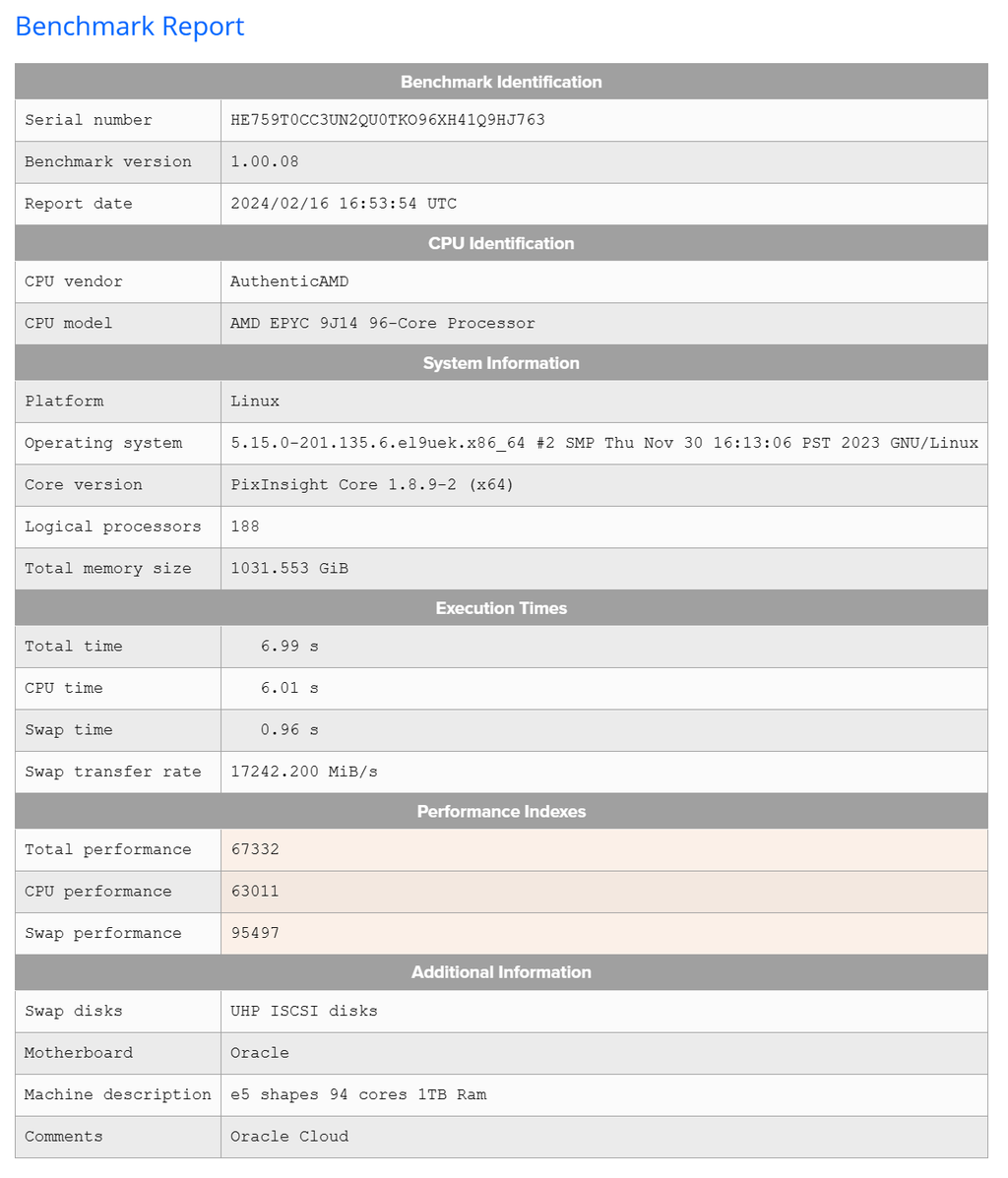

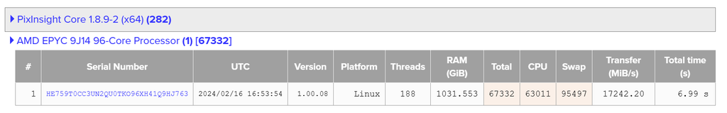

The swap performance on that one is off the charts. I don't know how they achieved over 17GB/s swap performance, but that's a big reason why it scored so high. Something about the EPYCs, they seem to score really high on swap throughput (and I assume, in general, overall disk throughput.) The raw CPU performance matters, and having 192 threads is a big deal, but this system's I/O rates are so high that data transfer times there basically don't matter. Most of the highest scoring (well, lowest total time) benchmarks have high I/O throughput.
More normal swap transfer rates are 3-6GB/s, with a pretty darn good "average" system scoring 8GB/s or so. It takes a lot of money to hit 7 seconds on the benchmark, and in all honesty, unless you are processing MASSIVE amounts of data, its utterly unnecessary.

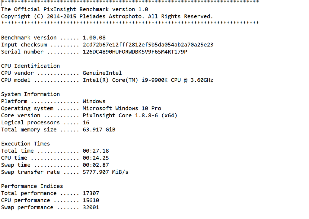

You pretty much nailed the swap performance for my system.  And this seems to be consistent for those who have set up their swap disk folders well, per PI suggestions.  I can't remember how it worked for me when I set up my swap folders on two RAM disks.  I don't think it was that different, even though, on my computer, the access time and transfer rate to the RAM disks blew away even my NVMe drive.  But the difference was between a fast blink and a blink in time...
I may be wrong, but I think this ratio between CPU time and Swap time could be a good diagnostic for what one should target when they are playing with their Swap configuration.  Clearly some who reported benchmarks should fix their swap configurations.
