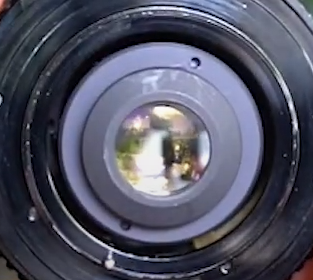

I have a question regarding the compatibility of vintage M42 camera lenses with the ZWO ASI2600MC Pro camera.
According to sources, the so-called "flange distance" of M42 lenses is 45.46mm
The 2600 camera has 17.5mm between its sensor and the M42 thread
My question is simple - will the M42 lens work with it?
Would I simply attach the lens to the camera directly? Would I need to use spacers? Would the distance between the lens and camera have to be exactly 55mm?
Here is the image of the M42 lens;
