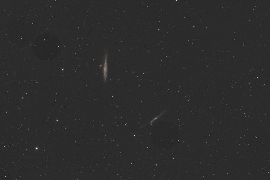

I'm usually trying to image targets across multiple nights and have noticed some slight issues with calibration frames.
I find sometimes artifacts on the imaging train move around from night to night (gusts of wind blowing stuff around, etc). Other times, I may not center the image in the exact same spot and so the dust motes and stuff come up in different parts of the image.
This sometimes leaves artifacts on the calibrated image (see attached).

Is it possible to take flats after each night and process them with that night's batch of images, then after, take the 3-5 calibrated images and stack those? Seems there must be a better way?
For reference, I currently take flats following the first night of imaging. I use a light panel and usually take 30-40. Then any lights I get over the next few nights will get stacked all at once with the calibration frames.
I'm pretty sure it's not the flats themselves that's the issue but rather the image alignment and artifacts moving, since this doesn't happen often and I've seen these dust motes on other images pre-processing.

I do the same, do flats on the first night and at any subsequent night, IF I made any changes in the imagetrain.
I have never seen artifacts like what you show move around.
With DSLRs you take flats every single imaging section regardless whether you take down the image train or not. They do move because of magnetic levitation. Doesn't usually happens with astro-camera but it isn't impossible (as it happened to myself).
Flats correct imperfections in your optical train. It does not matter where you point your telescope.

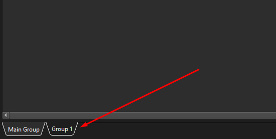

Ahh, silly of me to assume!  You can group sessions in DSS also, and it might actually be a little more intuitive.  Be sure you're on the latest DSS also:  https://github.com/deepskystacker/DSS/releases
Edit:  I believe it will stack all groups together after calibration, so it isn't something you'd want to do for LRGB/SHO stuff.  I might be wrong there, as it's been a while since I've used this feature.
