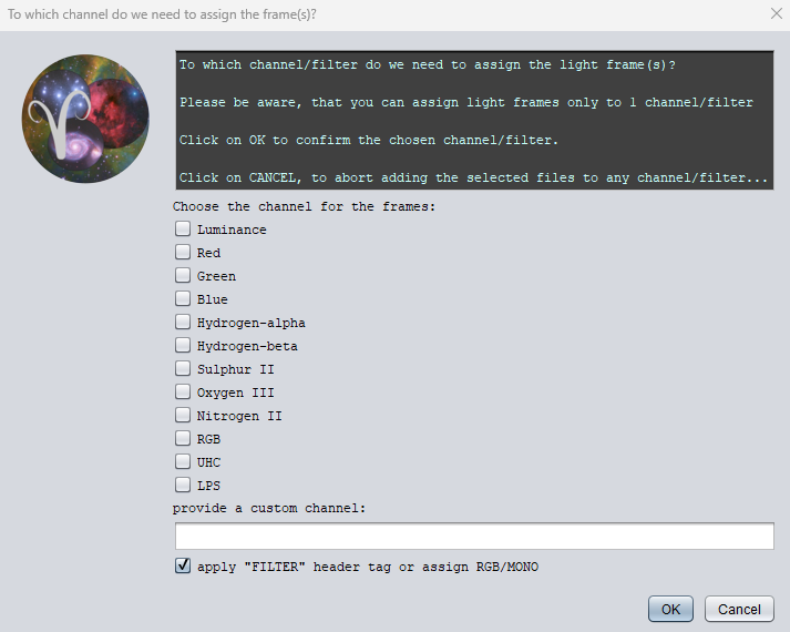

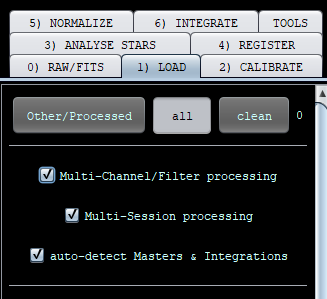

I'm stacking multiple nights with a luminance filter for two nights and the Optolong Quad filter for the other two nights. The dilemma I'm having is when choosing filters and multi-session, I can only choose one filter from the choices for a set of lights. What should I pick for the set using the quad filter? Or, should I even choose the filters option and just stack them as session 1 through 4?
Stack 'em up and be done with it. No faffing around with filter labels.

You should treat it as if you had no filter since that's the intent of this filter.
DavesView 2.39
Thanks! I wasn't sure if APP treated them differently when stacking. And thanks Andrea. Keep me from faffing up. LOL

In raw you'll need to select Ha-OIII color for example.

go to    0)   RAW/FITS   and  enable   the  force bayer /X-trans CFA
pattern   select your bayer pattern  sample   zwo  294mc pro  used RGGB
also check the algorithm  choice option and used the best for you camera

Not the same filter, but I often use an L'Extreme.  I just let APP choose based on file header. I assume it defaults to RGB.  Regardless, end results are good.
Gustav 1.20
Since the sensor only registers RGB there is a limit to what can be extracted anyhow. Ha is from red and Oiii is from blue + green and S is from ?…
DavesView 2.39
Same here. I also use the eXtreme and have done the same with it. Going to give Brian's and Henk_Jan's suggestion a go. Makes sense.

That filter is broadband, so you can leave it as is or select RGB.
