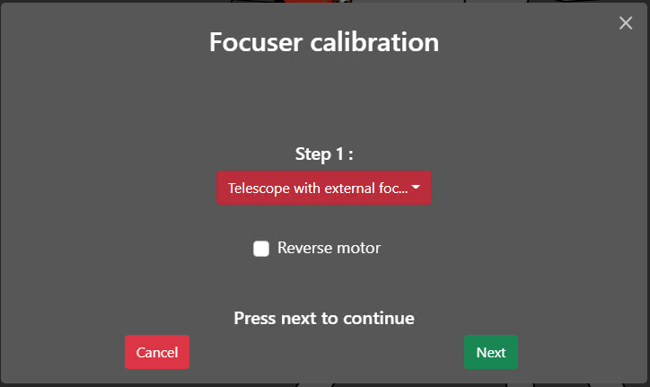

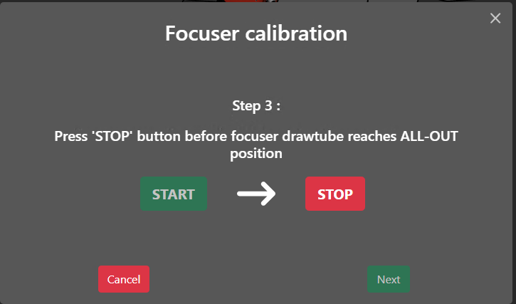

Based on the version I have which is the new P.L.A.Y software, I was not sure if the Senso1 was supported with P.L.A.Y this is what options I have:
Hit Calibration:
Select "Telescope with external focuser"
Manually set your focuser to 0 by use of the focusing knob and hit the "Confirm ZERO Position"
Hit "Start" to start the focuser moving out, when it gets close to the full travel of your focuser hit "stop"
You should then end up with this

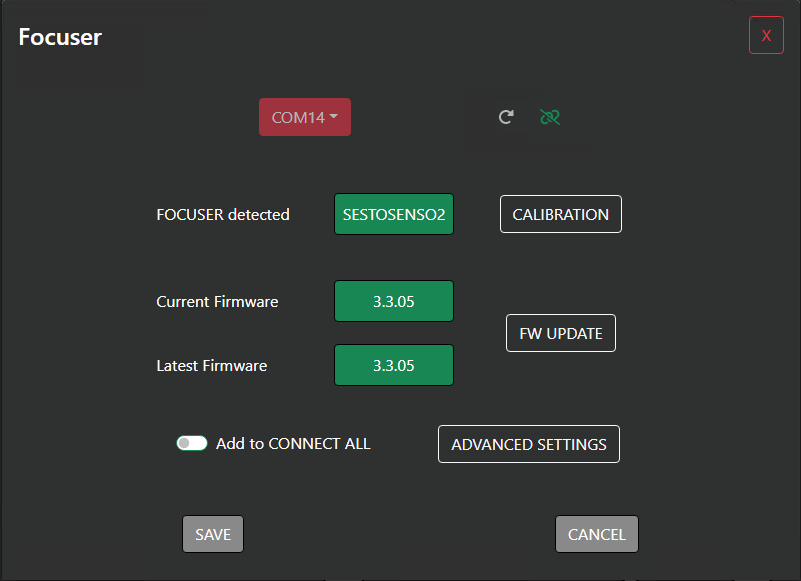

Hi Simon,
Sadly PLAY doesn't work with SS v1.
Andrea

I only have the v2 so I have to use Play, you should have "Focus Manager" installed for the V1, and the process is very similar

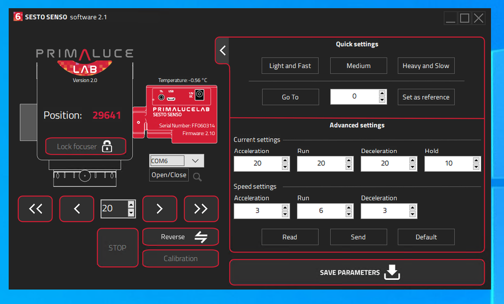

I have a v1 SS and have had a few years of experience with it.  When it works, it works really well.  When it doesn't, it will make you tear your hair out.
  I use mine on a Tak FSQ-85edx.  After a couple years of use, I found that the setscrews in the aluminum coupler had worked loose.  In fact the M3 setscrew on one side of the coupler stripped out after over-tightening.  I was able to fix the issue by drilling/tapping an M4 setscrew into it, then applying blue Loctite to both setscrews to (hopefully) keep them from backing out again.  I also found that the Tak's micro focuser shaft was loose.  Since tightening this all up, I've had no problems, mechanically.
  My other issue has been with the stepper motor seemingly losing its mind after powering it down.  It loses all it's settings and won't take new ones.  My only recourse has been to re-install the firmware and recalibrate.  It's happened so often that I made a wooden gage to quickly find the half-way location on the focuser during calibration.  I've taken to leaving it supplied with 12v power at all times.  That will do till I dismantle the obsy for the winter months.
  I recommend starting from scratch and reloading the firmware.  It's actually pretty easy to do.  After that, you need to tweak its settings to handle your specific load.  My image train includes the OAG, filter wheel and camera.  I figure that's plenty heavy, so my settings are as shown below.  Without setting these, I've had the focuser take off at a pace that would rival a race horse.  Re-calibrate the steps only after doing this.  As you can see, I'm using software v2.1.  The download from PL will include the files required for installing the firmware as well.  As other's have stated, do not try to use PLAY.  It's not for a SS v1.
P.S.  I use NINA and I could not be happier with the autofocus routine.  Once you get the AF steps right and the backlash steps figured out, it just works.  Every setup will be different but mine is set at 125 steps and Overshoot backlash IN/OUT is 75 & 0  (It's very important that overshoot only has steps in one direction,  IN in my case)
