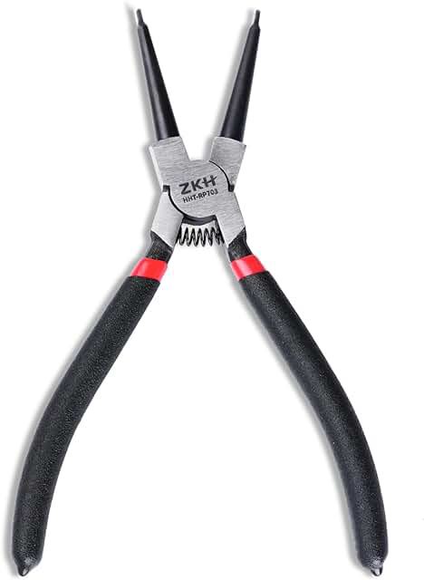

Roy Hagen: I`ve had these problems with my GEM28 from a few month after purchase( Dec. 2021) and mostly at objects hanging low. I found a sluggishness in the dec. axis caused by tightening the bearings to hard, and this sluggishness made it impossible to balance the telescope good enough, so when dithering in the dec axis the scope either stopped tracking or ran away. Better balancing made the trick for me @Roy Hagen , what do you mean when you say "tightening the bearings too hard"? Are you referring to the gear meshing adjustments? This problem (the mount stopping tracking for seemingly no reason, and generally poor guiding) continues to plague me. No, the shaft is held inside the dec. housing by two tiny ball bearings bearings, set in a distance of about 40mm. At the end of the shaft there is a nut to to tighten the bearings together and without a spacer between the bearings, it is possible to tighten the bearings to hard axially. I made a quick sketch and took a picture of the nut with my iPhone Everything is held in the correct position by the nut an the nut is easy to adjust if you can get a pair of straight snap ring pliers. A bit sloppy and fast drawing, but I hope it is possible to understand,    |
Roy Hagen: , the shaft is held inside the dec. housing by two tiny ball bearings bearings, set in a distance of about 40mm. At the end of the shaft there is a nut to to tighten the bearings together and without a spacer between the bearings, it is possible to tighten the bearings to hard axially. I made a quick sketch and took a picture of the nut with my iPhone Everything is held in the correct position by the nut an the nut is easy to adjust if you can get a pair of straight snap ring pliers. A bit sloppy and fast drawing, but I hope it is possible to understand, Thanks @Roy Hagen that's helpful.
