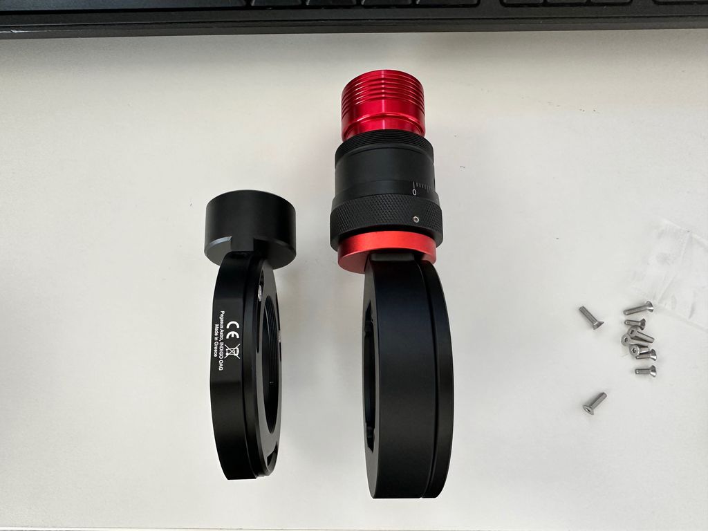

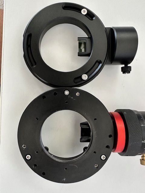

I believe the Indigo does have four mounting holes on the camera face side that will align with the ZWO EFW. When I took a look briefly it looked correct.
Yes but you will have to buy your own smaller (2.5 metric) screws since the ones that come with the Indigo are 3 metric and the EFW is 2.5....  |

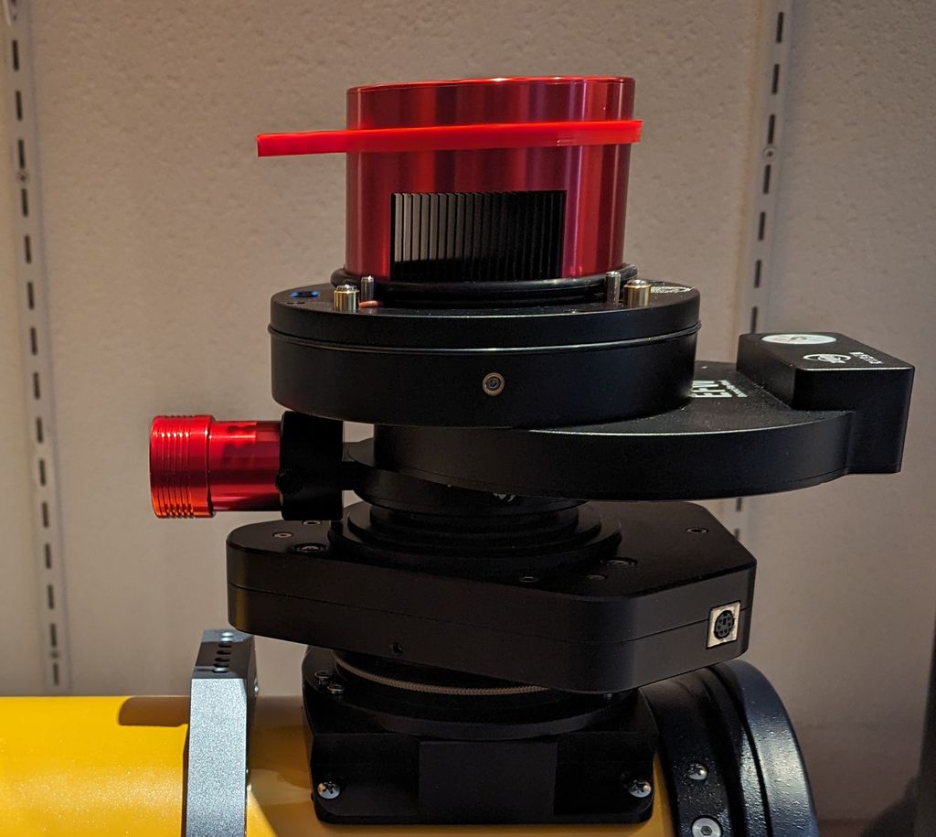

 @Bill McLaughlin is that an Octopi on the other side of the EFW?

 @Bill McLaughlin is that an Octopi on the other side of the EFW? Yes, it is going on an Epsilon 130D so tip/tilt is critical. That is also why the Indigo OAG instead of the ZWO OAG-L - because backspacing is also critical and there is not enough room for the ZWO unit.

Christian Bennich: he light coming through is not super great so looking for an alternative for my ASI220 guide camera. I just tried it on the horizon (PP adapter just showed up) and I am getting decent illumination even on my larger ZWO ASI174MINI. Still need to try it on the sky (if it ever clears  ).... Clearance for adjustment of the Octopi is really tight, down to minimums, otherwise the Indigo barrel would strike the LEO.  |
Wauu, you have room for a rotator there as well. What’s your backfocus demands? - 55mm I guess? 12.5mm for camera 20mm for efw (I assume) a minimum of 3 for the Octopi 10 as a minimum for the Indigo OAG Which rotator do you have?
Christian Bennich: Wauu, you have room for a rotator there as well. What’s your backfocus demands? - 55mm I guess? 12.5mm for camera 20mm for efw (I assume) a minimum of 3 for the Octopi 10 as a minimum for the Indigo OAG Which rotator do you have? Not a rotator. The focuser is an Optec LEO Low profile focuser.... The E130D back focus from the flattener is 56.2 mm. Adjusted for the Astronomik filters it is 56.5 mm.

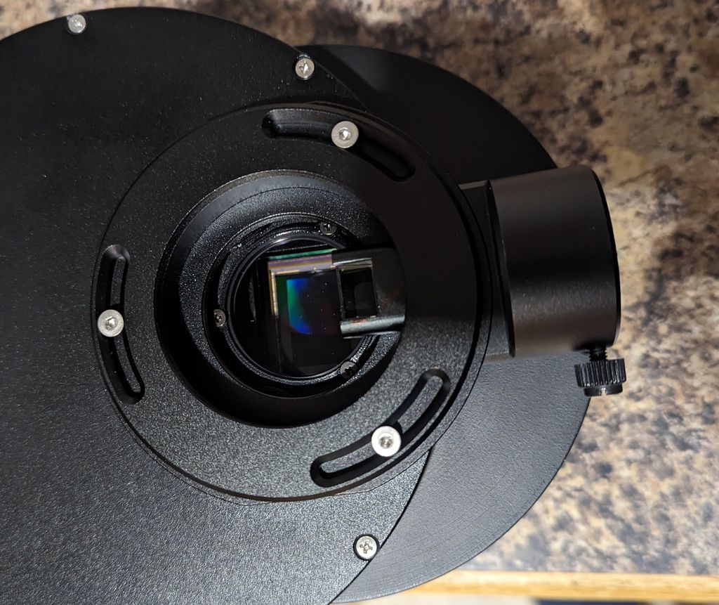

Hey all - glad that this channel is providing others with ideas when dealing with a tight back focus. I managed to test the Indigo OAG on Tuesday night and it performed really well - comparable to my ZWO OAGL (no noticeable difference). A few insights from my testing: 1) Build quality: high quality build that feels great in the hand. 2) ZWO Filter wheel Compatibility: fits the fastener pattern but as outlined above, you need to purchase 4 x fasteners which do not come in box. I brought my ZWO screws with the Indigo screws to my local fastener shop and it was easy to match (i used the Indigo length as a guide). 3) Helical Focuser: you cannot adapt the ZWO helical focuser onto the indigo if you were wondered  . But, it works perfectly fine to just use the screw on the side with micro adjustments by hand. Yes, it is not as good as a helical but it took me literally 2 minutes to get a good position. This could be an issue if you don't have a really good guide camera. I use the 174mm which is amazing. This is a great option for anyone looking to purchase an OAG. I personally would recommend purchasing this over the ZWO or QHY as it future proofs any back focus issues you may have. Included images are --> Esprit 100 setup hooked into an Esatto 3" ASI 2600MM, ZWO OAG (w/red helical) vs Pegasus indigo OAG front and side.    |
