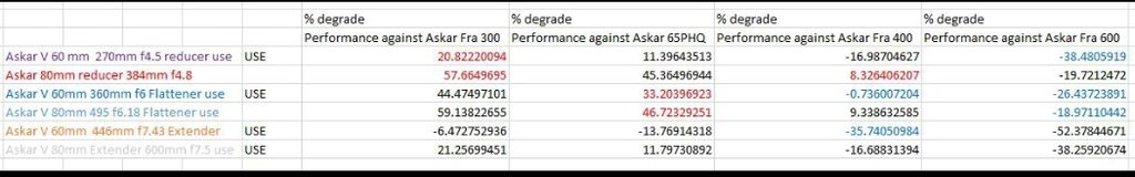

Hi, I've been looking on getting a V. But.... Im not convinced on the optical quality yet. So I downloaded the spot diagrams for it, and compared against Askar 65PHQ, Askar 300pro, Askar 400, Askar 600. I combined the total um spread one by one for each, and when you compare, it looks like the attached (see attached) Basically the Askar V at similar focal length to Fra 300 is 20% to 57% more degraded, 65PHQ 33% to 46% more degraded, Askar Fra 400 8% degraded to 0.7% upgraded[b], [/b]FRA 600 - better 18 to 26% upgraded  % degrade
 Performance against Askar Fra 300
Askar V 60 mm  270mm f4.5 reducer use    20.82220094%
Askar V 80mm reducer 384mm f4.8                57.6649695%
  % degrade Performance against Askar 65PHQ
Askar V 60mm 360mm f6 Flattener use    33.20396923%
Askar V 80mm 495 f6.18 Flattener use     46.72329251%
  % degrade (%upgraded)
Performance against Askar Fra 400
Askar 80mm reducer 384mm f4.8     8.326406207%
Askar V 60mm 360mm f6 Flattener  -0.736007204% % degrade %(upgraded)
 Performance against Askar Fra 600
Askar V 60mm 360mm f6 Flattener    -26.43723891
Askar V 80mm 495 f6.18 Flattener     -18.97110442
 So against the 300 you can expect, all things being equal, 20% reduction in optical quality, so on and so forth. I also cant find too many images published in astrobin and elsewhere that would refute the above. Either it is too early to compare due to lack of finished images, or the above numbers paint the picture. Any users here want to correct me that would be very much aprpeciated. This post is intended to bring out the best Askar V discussion so I can literally order one, not to discourage anyone who owns oneScreenshot_20231224_081147_Gallery.jpg

I do not own an Askar V, but I have researched them since I find looking for the next telescope is a big part of this hobby for me .
One item I found in my research, was a Cuiv, the Lazy Geek video in which if you look at the description, he linked to a bunch of raw frames in various configurations. These all looked relatively promising to me, and comparable to the 65PHQ which I did previously own. I like looking at raw frames when evaluating optics vs. finished images.

*** Chris I downloaded the fits and, yes, they look fine to me also! So I jsut ordered the Askar V! thanks for your reply ... I just noticed two really good images posted on Astrobin from the Askar V that look incredible so that also swayed me finally!***

I was skeptical, at first, but is it really any different than putting a field flattener/reducer on the back of most refractors, or adding a HyperStar to an SCT? I’m sure there is a slight drop-off in quality compared to a closed system, but is that reduction in quality worth buying 2 separate scopes?
I don’t have the V (and I don’t plan on buying it) but I’m intrigued by the design. I’m glad SharpStar and William Optics (WIFD design) are continuing to try new things.
