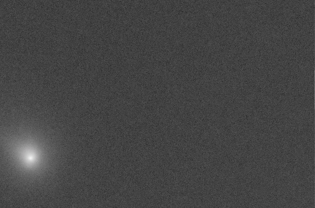

I am able to get an image, but at the cost of a darkened and less detailed tail as it's near impossible to mask out the comet itself:

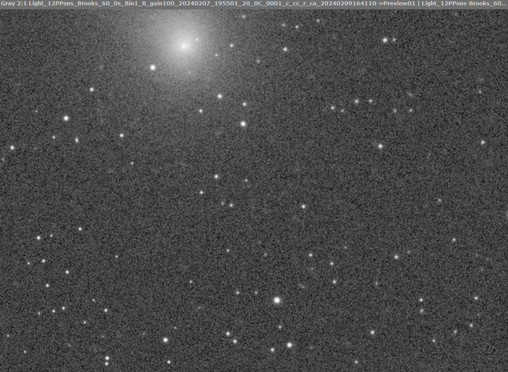

I've tried BXT correct only followed by BXT sharpening on stars before SXT on every sub as well now, I did however notice something on some of the subs:
These white specks are responsible for the rain noise.
Edit: Removed wrong assumption, they seem to be remains from star removal - but yet when comparing before/after they do not always overlap.

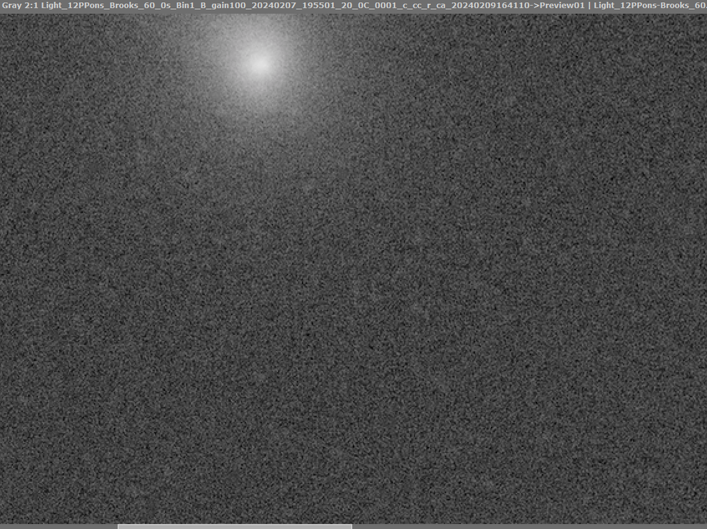

Before:
After:

The most effective way that I find to walkaround this is using the files that you make after align the comet from the core (PixInsight I mean), is taking those files into StarXTerminator on batch mode and removing the stars sub by sub. Using the batch mode, you can do it without the necessity of doing it manually. This is not "walking noise" in the traditional form. Is noise lefted by the star removal. You probably stacked the files of the comet core align and then runned the star removal, and that's it was causing that pattern.

As stated above I did run SXT before integrating the comet aligned images. The problem is that most of these streaks seems to come from bright spots in between the stars. Stuff that SXT doesn't extract unfortunately. Running ImageIntegration with some decent rejection algorithms in stead of using starless images actually performs almost as good, but the difference is neglible in the end. There's just too much of it anyway.
I'm starting to believe that one reason behind this could be the fact that I've had to shoot it pretty early, it's dark but temperatures are dropping quicker and the object is pretty low on the horizon and dropping quickly (lots of atmosphere). Neither of which is a good combination when I only did focus once. It might be some small slightly off focus stars that are left behind, that's my theory for now at least.
As you can see, the method you suggest and I also use, worked perfectly while processing C2022 E3 ZTF last year.
