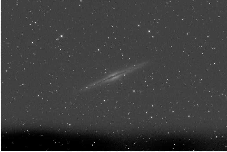

Just the five lights that you processed with default WBPP with LN:
So clearly the accumulation of data from the 75 more light frames is shifting the gradient to white.
