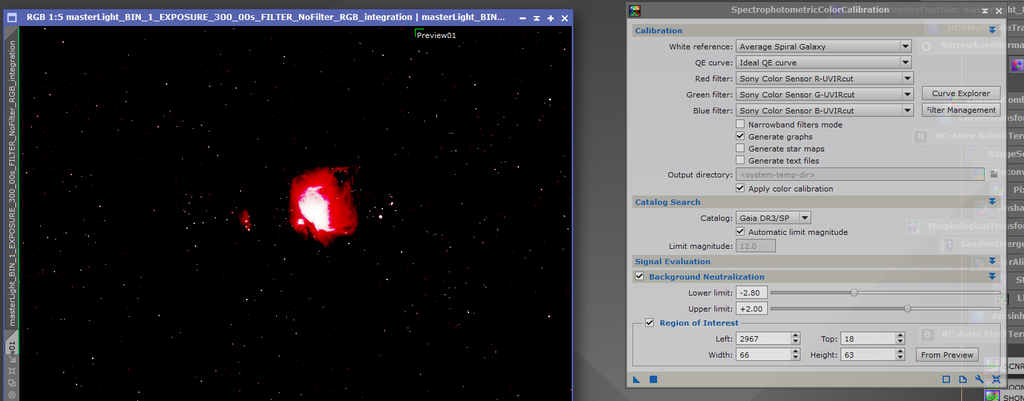

Hi everyone! I'm trying the SpectroscopicColorCalibration for the first time, and I haven't stretched my image yet. So far all I have done is WBPP, Crop, Alignment, Channel Combination and Image Solver. But even on my OSC images I still get these funny-looking results after running SPCC:  This happens whether I have the Channels Linked on STF or not. I also tried to run this with a narrowband image (applying the narrowband checkbox and editting the filters), and the result was very similar. Am I missing something? AFAIK, SPCC should be done with the image still linear, on an early stage in order to execute background neutralization and SCNR, right? Thank you!

Thank you! Just redo STF with channels linked @Taras_M hey friend, so I mentioned in my post that I have already tried it. The result is the same  |

This image can't possibly have been autostreched after SPCC (as all this tool does is trying to set a reasonnable background, which is not the case here) unless your image is severly broken to begin with. Does an unlink autostreched of your image before SPCC looks normal?

André Moleiro: @Taras_M hey friend, so I mentioned in my post that I have already tried it. The result is the same  I know it shouldn't work like this, but have you tried it without selecting a preview for background normalization? In case what is the result? And how is the STF stretched image before SPCC?
…and if you haven't already, try selecting your 24 bit LUT option.
The first thing that I noticed is that you have "Ideal QE Curve" selected. I always select my actual sensor. And make sure you have the correct filters selected. Also, I never set a region of interest for background neutralization. Try experimenting with those things. I would be very interested in your results.

Reading this I supposed you have monochrome camera with red, green and blue filters. But... The label on your screenshot says "...RGB_Integration" wich let's me think of OSC. If it's OSC, SPCC parameters seems OK but why did you do some channel combination and all that kind of stuff? WBPP takes care of all that stuff, I don't see any reason to do that manually. (By the way, if it's OSC, you should run "drizzle x1 integration" if possible; it really helps with SPCC and clors in general).
Anyway, I think the problem has something to do with "Channel combination"; it looks like you combined images that have difference regarding of the PSF (size of stars are not the same for all channels).

Hi everyone, thanks so much for the replies and suggestions! I'm not sure exactly what happens, but I found a way to overcome the issue: I need to apply SPCC with the Channels Linked on STF (even though applying an auto-stretch with it enabled messes it up).. It will generate an image with the same aberration, but then I can just auto-stretch again, and the image will come back to normal, with the SPCC process applied. Example below (OSC image).  1) Original image with an auto-stretch (STF Channels unlinked) 2) SPCC applied with STF Channels linked 3) Applied another auto-stretch with STF Channels linked In the tutorials I watched, people wouldn't apply another auto-stretch after running SPCC, so I still don't know what that's about. In any case, it seems to be working with theworflow I described. Thank you, everyone! Moleiro

The way the channels are linked on STF have nothing to do with the results of SPCC. Don't forget STF is a visualisation tool only. It doesn't change anything to your image (which is still linear at that stage).
The results you are seeing after SPCC are normal. As it has been said in the very first messages of this thread you only need to reapply an STF (with linked channels) to see a normal image again.

You are now doing what Taras_m suggested in the second post. It does not matter what STF is applied before running SPCC as the actual image data being calibrated is not affected by the STF. After SPCC the stf parameters remain as they were set before running SPCC and the image will look like this until you run stf again. At which point it will set the parameters based on the post SPCC image/data.
This is completly normal. As Taras _m said Just redo STF with channels linked after spcc.
