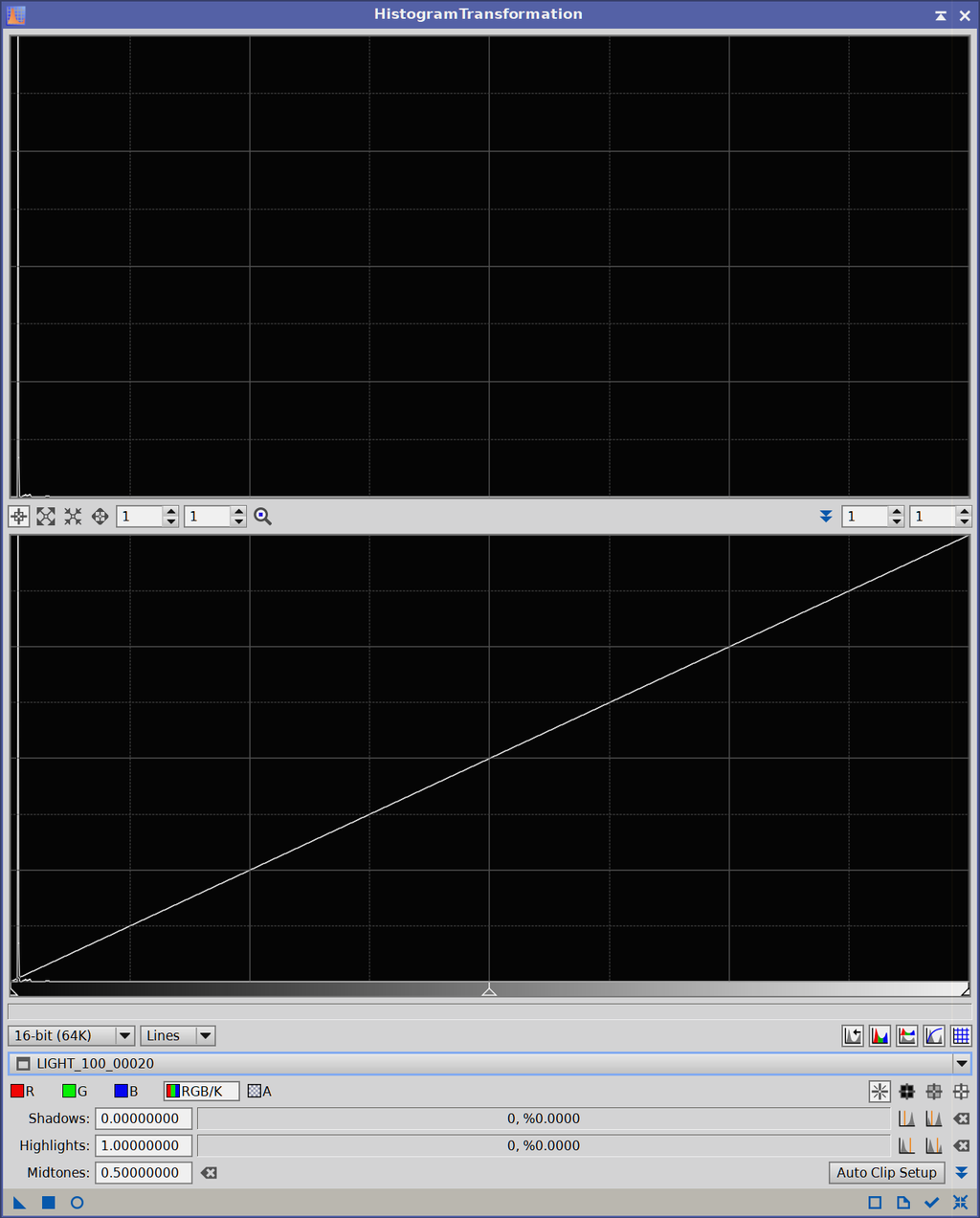

Hi everyone! I have a Canon 90D (astro-modified) and an Astronomik 6nm H-Alpha clip filter. I'm using a Tokina 400mm f8 lens. I've got the ISO set to 100. The exposure is currently at 1/60s. I also have a solar filter mounted on the lens. Everything appears to work well, but I'm having issues with the histogram and how much I need to adjust my exposure. The light on the histogram is nearly to the left all the way. I think I'm under-exposing, but I want to see what others think. Any advice or tips are appreciated. I pasted a screenshot of the histogram from Pixinsight. EDIT: Forgot to mention, the histogram below is from one of my light frames in RAW format, unedited. -Crimsus  |
I think you should post an image of the stacked image unedited (assuming you have already stacked the individual frames together). But I think, at first glance, your histogram does not look right for the sun.
I think you should post an image of the stacked image unedited I had a moment of frustration and realized I deleted the folder, so all I have left is the screenshot of the histogram. You mentioned it doesn't look right for the sun (and I agree something is wrong, but I don't have much experience with solar photos yet). What do you suspect is wrong? How should the unstretched histogram look for the sun?
What do you suspect is wrong? How should the unstretched histogram look for the sun? Well that histogram looks like the histogram of a deep sky object linear image which doesn't make sense to me. I assume the histogram should be wavy and long(er) for bright objects like the sun and moon. I had a moment of frustration and realized I deleted the folder, so all I have left is the screenshot of the histogram. Do you have any light frames to show at all? All I need is one, if they all look the same.

I was able to find another light frame from when I was testing out my SolarQuest. There's only one RAW image. I attached the RAW file. Below is the screenshot of the unstretched histogram. Here is the link to the RAW file.  |
It probably would do with a bit more exposure but if you are stacking a stream of raws that won't matter much to the final result. I see, however, that you are both underexposing and out of focus and don't forget to take flats!

Are you using an Ha clip in filter combined with a white light solar filter?
Thomas: Are you using an Ha clip in filter combined with a white light solar filter? I'm using the H-Alpha clip in filter with the solar filter at this link: https://www.seymoursolar.com/store/p246/Helios_Glass_Threaded_Camera_Solar_Filter.html#/ |
So the Ha clip filter is for DSOs, not solar. The solar Ha is something completely different and a way smaller bandwidth than the clip in filters. We are talking angstroms, not nanometers. The filter you have for the lens is designed for "white-light" solar imaging and on its own will let you see sunspots and surface granulation. I would try removing the clip filter and go from there.
