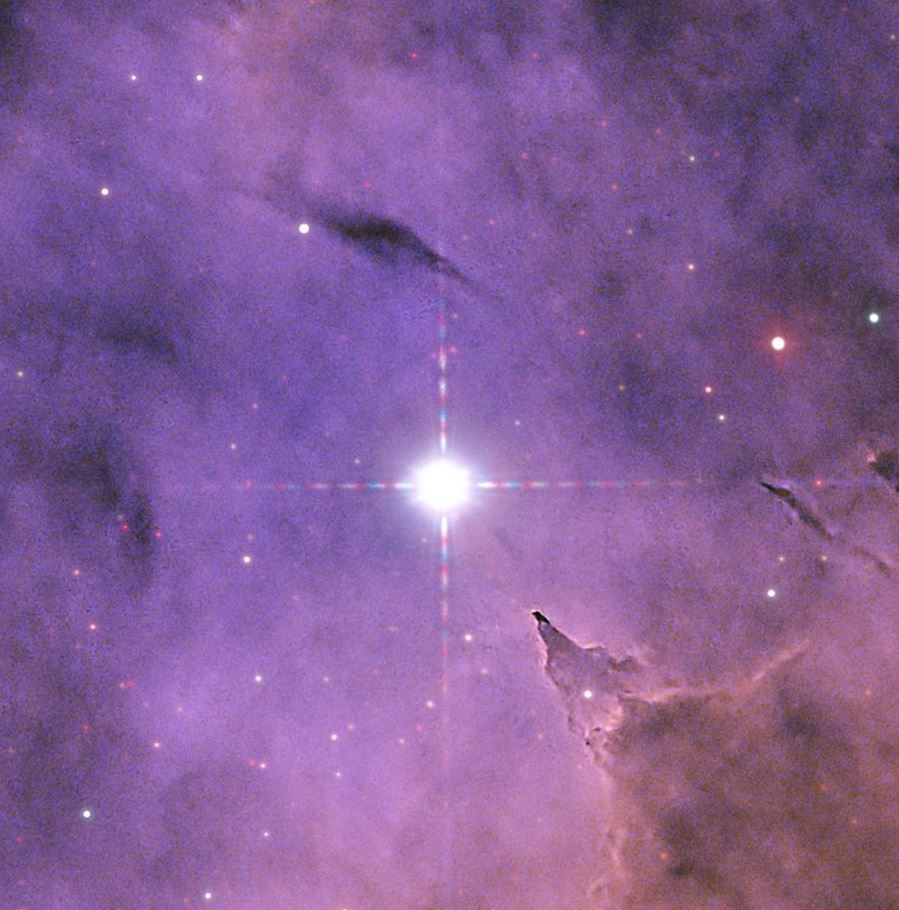

I seem to be getting rainbow/dotted diffraction spikes when I shoot with my 8" Newt. I don't recall seeing them before and I can't spot the effect in the individual frames. Is it just down to my processing?
They don't bother me in the slightest, I'm just curious!

diffraction is wavelength dependent. Hence the different waves produce at different places minima and maxima. That's what you see. The geometry is given by the geometry of the spider vanes.

Thanks - I get the geometry (I rather like it!) but couldn't fathom why they were appearing "rainbowy". So it's just a result of how light works then!

Thicker vanes produce that.  Thinner vanes will be far less 'dotted' or rainbowy.

Ah well, the R200SS has girders for vanes so that makes sense!

It doesn't matter the thickness as long it is an of order of magnitude greater than the wavelength of light. Mine are 0.5mm thick and they produce the same effect as well.

All, are there any processing tricks to minimize the rainbow banding on the diffraction spikes in question? (just now processing and can't stop seeing them)

I did some studies with that. The thinner the spider vanes are the less pronounced is the rainbow in the spikes. The Takahashis have relatively thick vanes. My newton has very thin vanes and the effect is barely visible. The other solution are curved vanes.
I don´t think there is a processing solution to get rid of the coluered spikes.

you can avoid the spikes by a special spider mask, like i used in this image here: https://www.astrobin.com/tgvhai/
but the mask produces larger stars, because the energy of the spider have to be distributed somewhere in the image.

With narrow band you get separated dots. As you increase the band width, the dots connect to an almost continuous line once you get to full band.
The thicker the vanes, the more visible it is. You get the worst (most visible) with double vanes like in the Asa Newtonians, or other double vane scopes, like my home made newtonian
Also you need bright stars to see the effect strongly.
