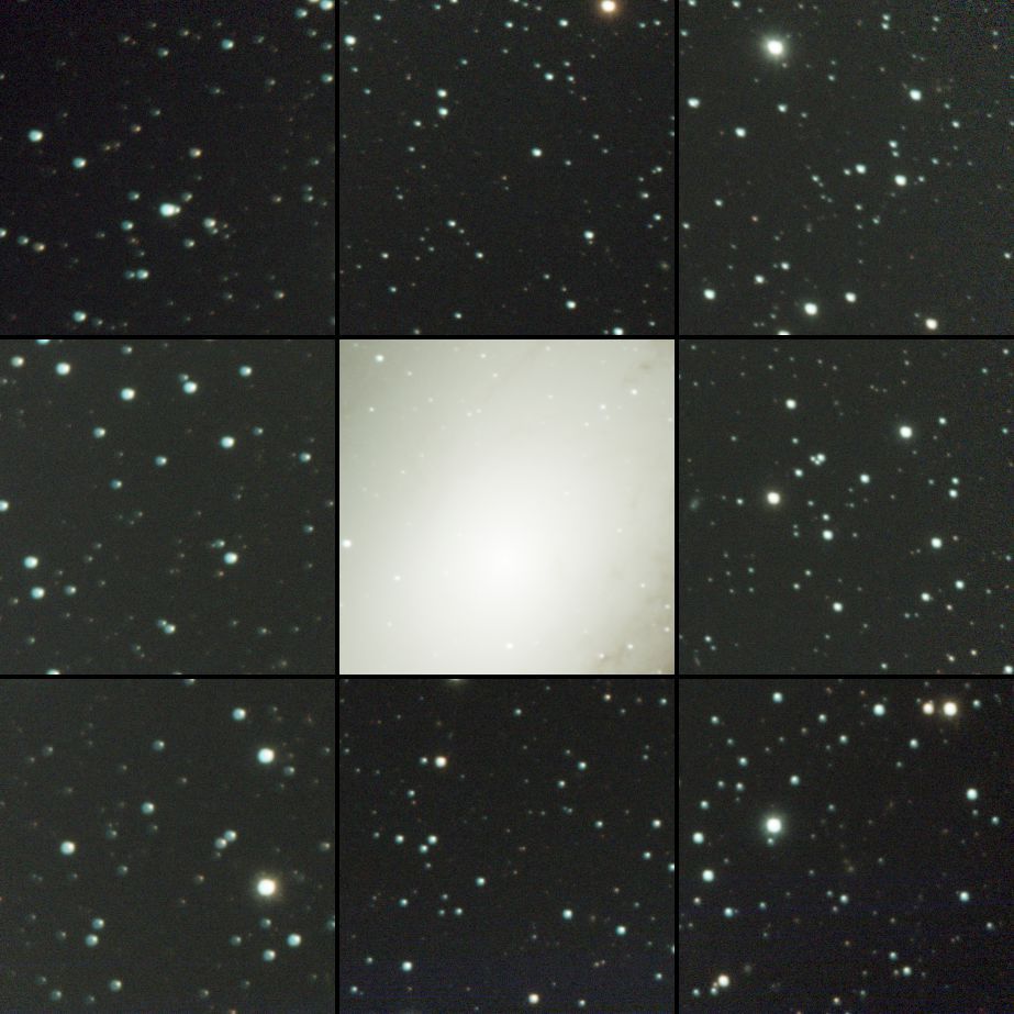

Every telescope has proper backspacing... often times for 'most' telescopes this is 55mm.    Problem is some folks don't realize that 55mm is merely a suggestion.  Proper backspacing is achieved when the image provides the flattest possible image across the full field of view.  Often times this is closer to 56 or 57mm.   This is due to the addition of filters in your imaging train, but I wont  go into detail there.   Solutions for this degree of accuracy come in the form of shims that can be found on sites like Agena.       Things like tilt are a little more difficult to fix, and often can be caused by the camera itself.   You can research on your own how to fix these things.    Also, it really doesn't matter how much you spend on your telescope, everyone has to go through this and learn how to properly align their optics at some point.
Here is what your corner stars look like on your stacked image:
Left side looks pretty substantially out of focus and somewhat streaking away.   This tells me your sensor is likely too close on that side.   The right side of the image is still just a tad out of focus, but the stars look more concentric towards the center of frame.   This indicates the sensor is too far away on that side.    These adjustments can be as subtle as 0.2mm to correct.   I encourage you to google this stuff , it's not difficult, but you must identify if the tilt is in your camera or in your telescope first before you make corrections, unless you plan on never rotating your camera.   You can purchase things like the Gerd Nuemann plate to correct tilt either way.
