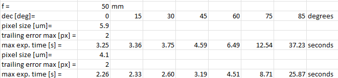

Which brings in how to calculate the maximum exposure for any camera/lens combo. I had worked out an excel spreadsheet to carry out the task and decided to stick to either the Canon 7Dii (modded) or the Nikon D610 (FF). In alll case I alaso made the "play safe" decision to keep the f/ratio at 4 and no less to contain aberrations with one of either the 35mm (24mm mistaken for a 50mm was left at home, again!) or the widefield workhorse, the Nikon 50mm f/1.8 "pancake". In the end I decided to go for the 50mm with the either the Canon or the Nikon.
Inserting these numbers and the pixel size for both cameras yield the following results:
I also decided upfront to limit trailing error to a maximum of 2 pixels, which is probably a bit on the conservative side but better safe than sorry I said to myself. Given that the Canon is modded and the D610 isn't I played it safe and went for the Canon to try to pick up the major emission lines nebulae in the Southern sky as seen from Navarino, as well as giving me a bit more oomph factor in terms of image scale. I was going to image the MW from the Scutum to as far South as was safe to go considering the Pylos massive LP (and never mind the strobing lasers from the night-clubs) .
