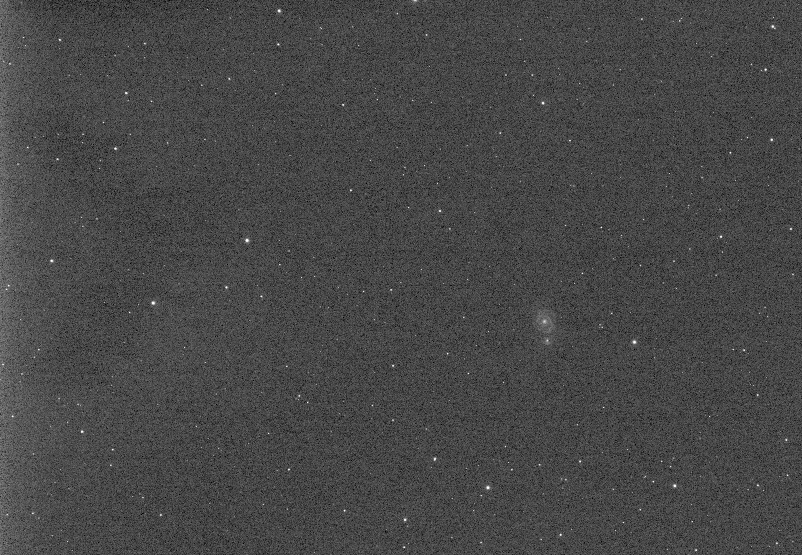

here is the link to dropbox, 4 Light Frames, 1 Masterdark. Also one result of a stack and calibration of 47x 300sec with below confituration.
Made with a FMA180, QHY183M (Mono) and Antlia O3 3nm Filter.

What I actually meant in my previous post is to have raw dark files (like 10) just to make sure there is nothing in the pipeline that might give you the issue you're experiencing. This said I used your master dark and albeit there wasn't an accompanying flat master the light frame seems seem to calibrate just right For what I can see the signal is really weak and the noise pretty large but otherwise nothing untoward imaging it with few more hours (let's say 7-8 hours) to get a decent image.

Hi Andrea,
I have only the master dark. And if you look at the right side of your calibrated picture you can see very faint the same artefact as in my pictures. The more lights you use the more artefact is visible.
If you look at other users of the imx183 sensor I can't see any problems whether color nore Mono. And with me it's only visible with narrowband filters, no problem with broadband.
Hi Werner,
Looking at the final stack I can't see much to distinguish that area from other areas and some have even worse signature than that. Yet the issue with residuals seems to exists with that sensor, see here:
ASI183MM test (astrosurf.com)
