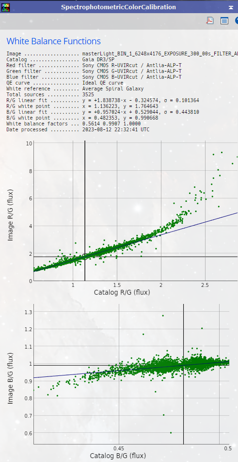

What does it mean when all your integrated pictures have a SPCC graph that looks like this one?
For background, I'm using a C8 + Hyperstar 4 + ASI2600MC Pro + ALP-T Highspeed dual narrow-band filter on NGC6960.

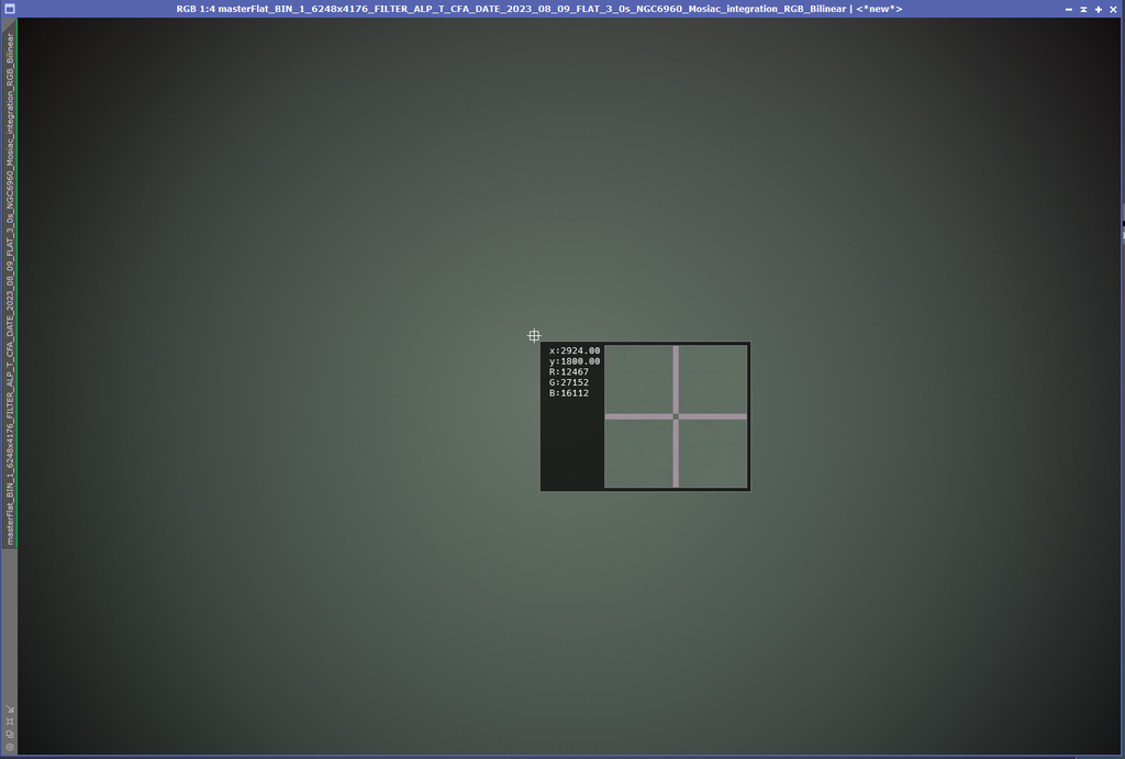

On another, but possibly related note, no matter how hard I try to take flat frames all my integrated results always have a blue/red gradient that looks something like:
For flats I've tried:
Dusk sky + hayes t-shirt (4 layers)
Dusk sky (no diffuser)
Amazon A3 light panel + haynes t-shirt (4 layers)
Amazon A3 light panel + Amazon neutral density film
Amazon A3 light panel + Amazon neutral density film + haynes t-shirt (4 layers)
and no matter what I do, I always end up with what looks like a flat-frame problem but with differing intensities between blue and red.
B.t.w., The first SPCC graph is done after ABE, here is what it looks like right after Integration (SPCC is the first thing I do)SPCC_before.png
Anyone else seen this weird color gradient/flat-frame problem before?
Any advise on how to fix it?
This look for me that you have a sensor shift. So one side show more out of focus red the other one blue.

For the bi-color gradient in the flat, that is entirely normal when shooting with a dual nb filter. For the variation from strict linearity in the spcc graph that is due to the response of the filter at different incidence angles, IMHO.

Are you shooting flats through the filter?

You're telling SPCC that you're using just a UV/IR cut filter.

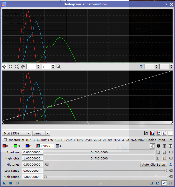

There's some confusion here.  The image I posted is the gradient extracted by ABE after my lights have been calibrated and stacked.   Obviously my Flats aren't working correctly, but I don't know what to do to fix them.  (see the original post for all the things I've tried) and b.t.w.  Here's a screen grab of my debayered (bilinear) master flat (unlinked STF) taken with neutral density film and the Amazon A3 Tracing Light Panel and it's associated histogram.

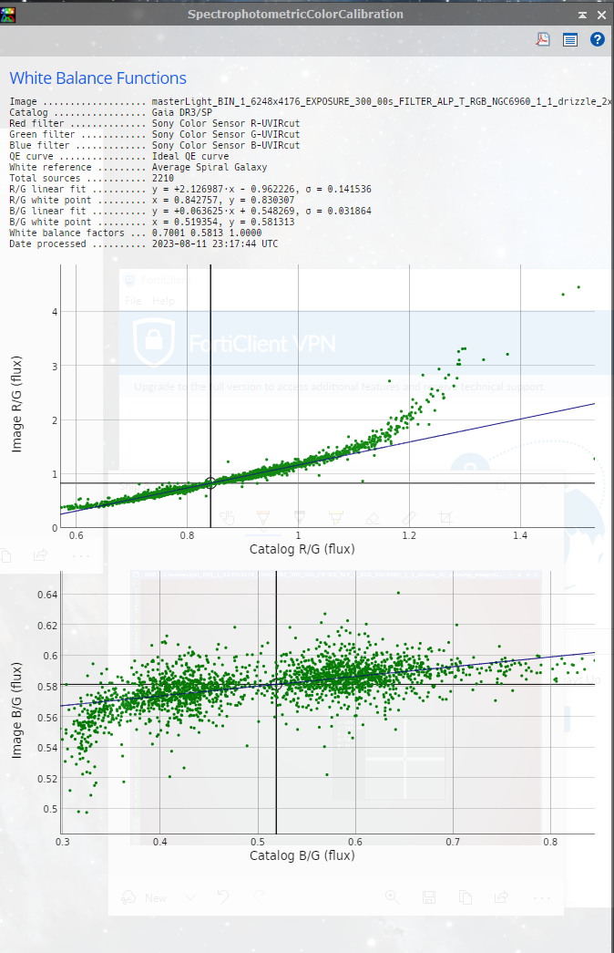

When I read the PI documentation about SPCC, it says "when working with OSC cameras, we should always set the QE curve parameter to Ideal QE curve" (source).
But I don't see anything about "using a narrow-band filter with OSC" so I'm quite confuse about such a case.
I would try using "Ideal QE curve" but with "Narrow-band" mode enable. Something like this:
Yes, when using dual narrow band filters I was supposed to select the Sony R/G/B + ALP-T filter settings in SPCC like this:
which gives this result if I do SPCC before ABE/DBE:

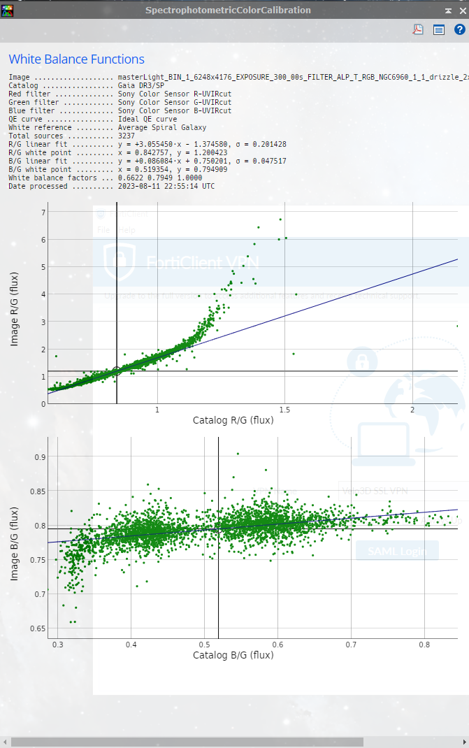

and this result if I do SPCC after ABE/DEB:
which I admit is much better than the first image I posted, but it still has this weird upward curve in the R/G flux chart
I want to thank everyone for their answers.   I wonder if there may be more suggestions regarding my inability to calibrate with flat-frames and if there's a possible relationship to this weird SPCC R/G flux chart?
