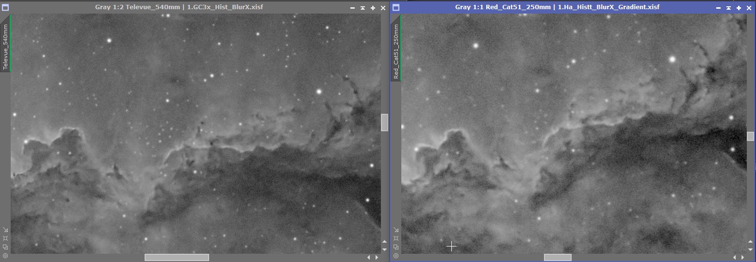

Leonardo-Ruiz 4.01
I show you the difference in resolution. On the left, the Televue NP101is, with a 540 mm focal length with the ASI2600MM of 3.76 μm pixel size, which provides optimal resolution. On the right the Red Cat 51 with 250mm focal length and identical pixel size. Both are perfectly focused, it is not a difference in focus but in resolution, but as I mentioned, it is not something drastic either, you can make excellent images under sampling.

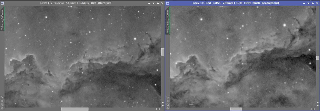

Leonardo-Ruiz 4.01
Another comparison with a smaller zoom shows that although there is a difference, the result is very good.
