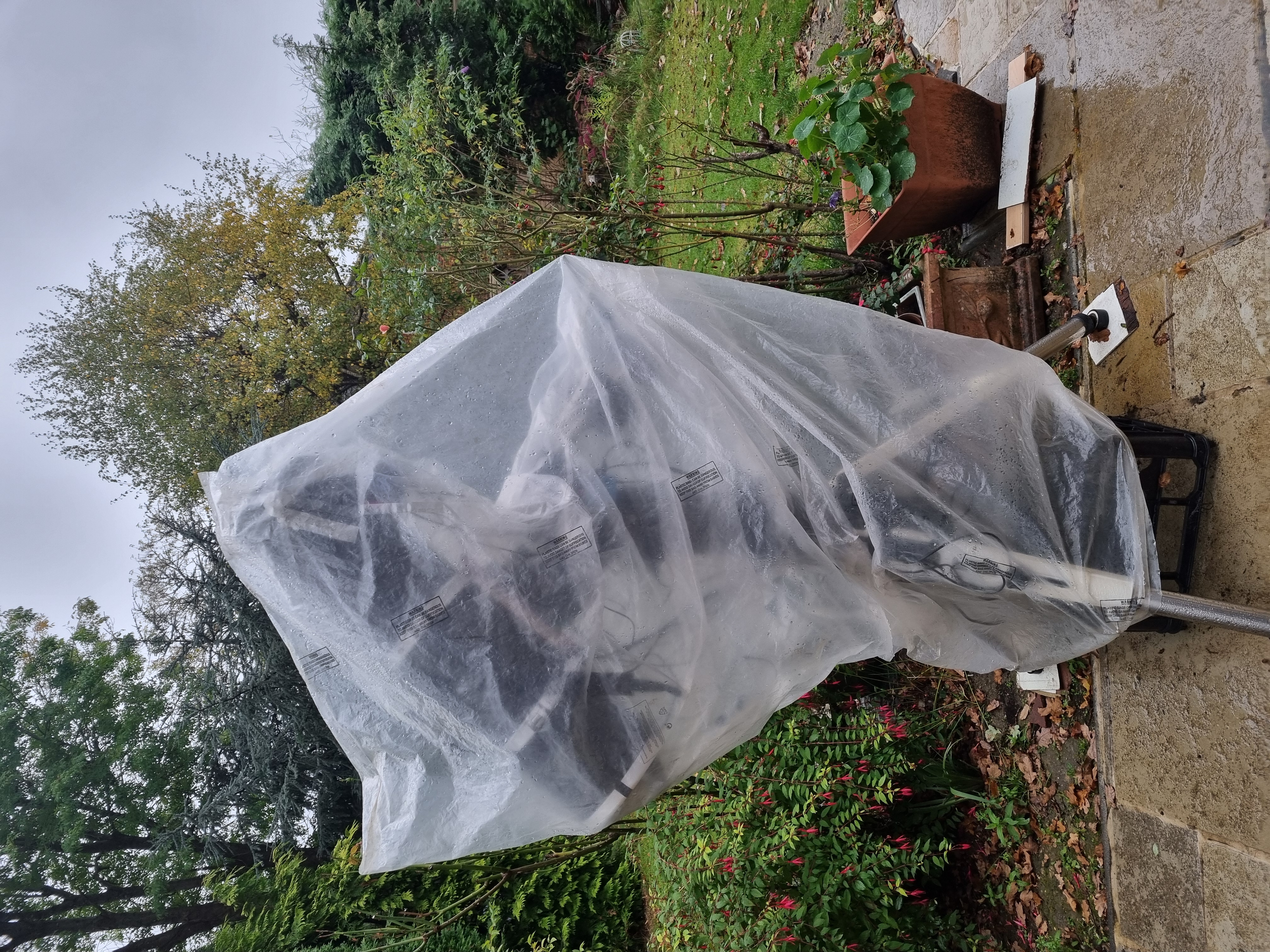

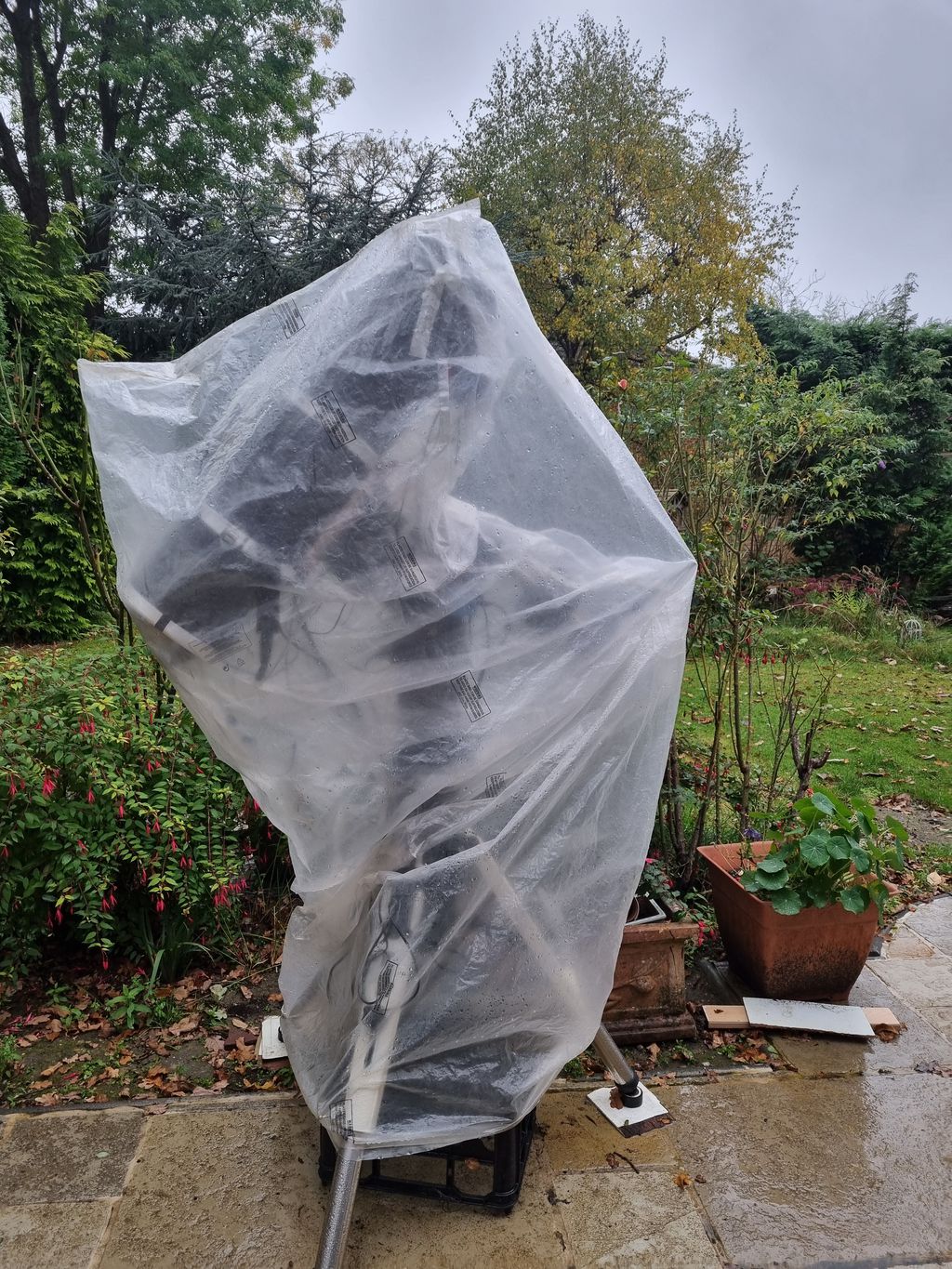

sadly -  are two large plastic sheets that came with some furniture.  But they are great to cover the scope on rainy nights so I can leave it set up and polar aligned awaiting the next clear night or part of a night.  It does mean that I can get imaging more quickly when the chance comes.
What do other folk without special observatories etc generally do?   Take everything down or cover the scope up for a few nights as I have done?

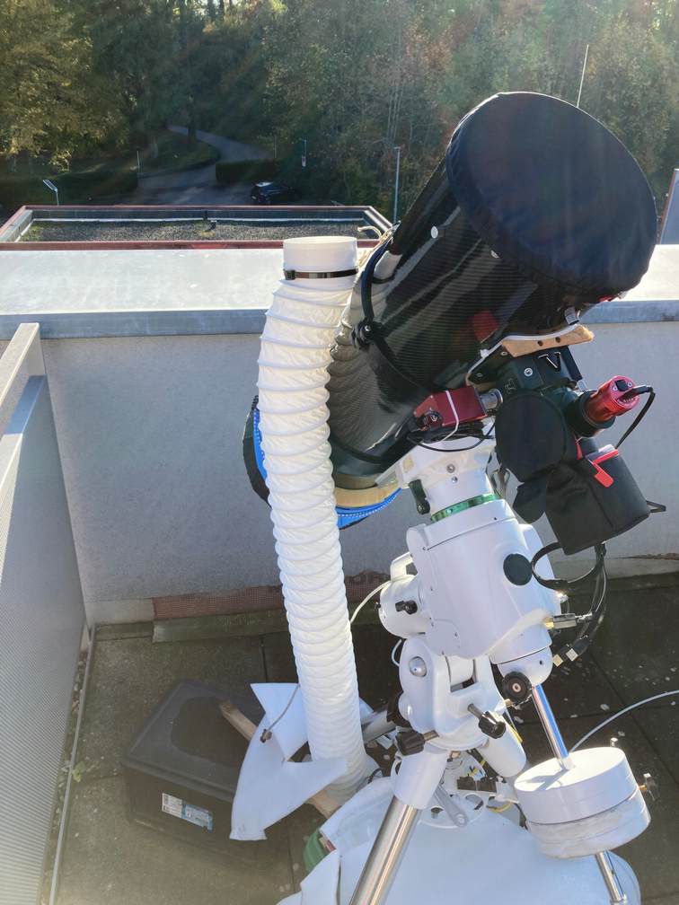

Great set up Patrice. I am interested in your 'Active Airduct'. Do you have any detailed pictures of this?
Many thanks,
I dont have such picture at the moment. I will get some the next time I uncover the set up.
However this is fairly simple. You need
- a PVC or aluminium vent
- a box to secure the horizontal part of the vent such that the vent does not get destroyed by the telescope cover
- a (intel-2012ish) CPU fan
- some standard basic vent connecting parts, include a tube in which you can fit the CPU fan.
In my case, I placed the solide tube with the fan next to the tripod and taped it. The vent has then a part going up from the fan to suck the air, a second part going down to the box and then a third part going trough the box and an exhaust on the side of the box that cannot be covered by the telescope cover.

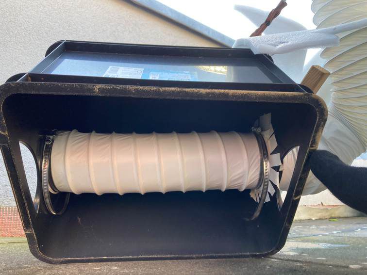

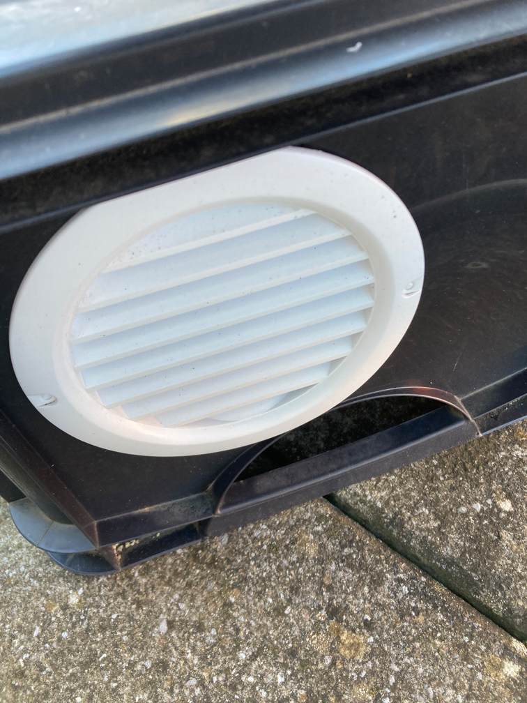

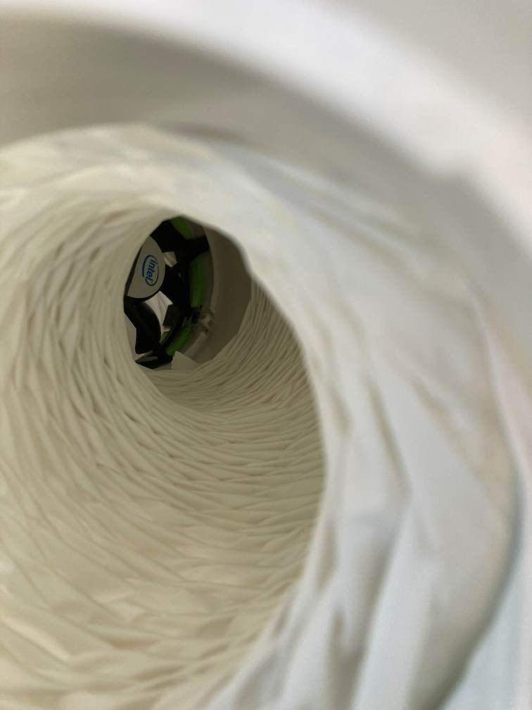

Hi @hughsie
Here are a few more pictures :
Overview
Lookind down in the duct, seeing the CPU fan:
Plastic box to avoid having the cover killing the duct within a few days, seeing from below: 2024-10-29 14.58.21 - Copie.jpg
Exhaust:
Cheers
