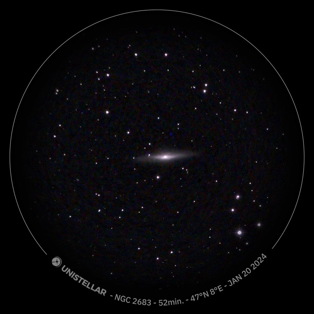

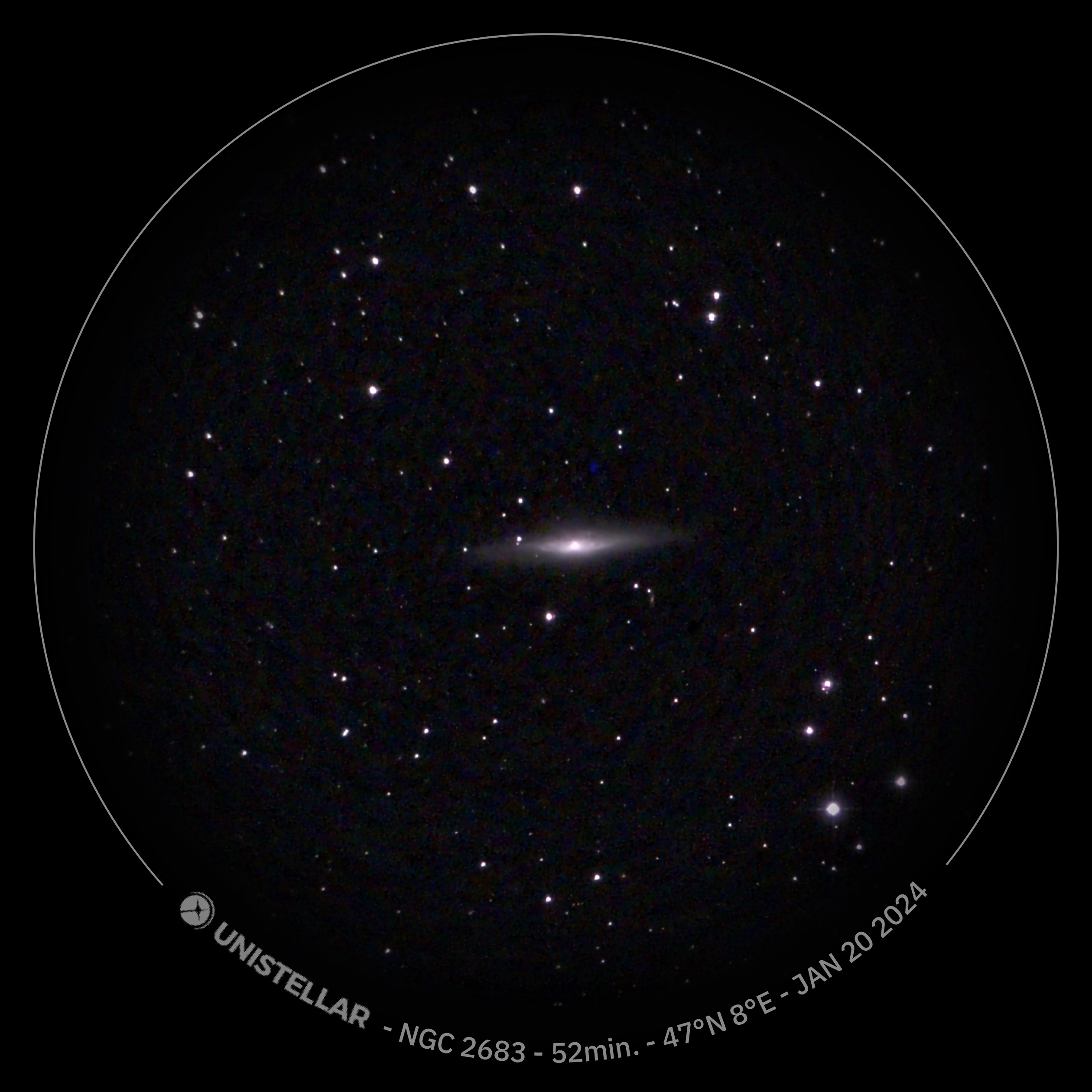

Hey there
You can see what the Unistellar Equinox 2 is capable of, at my profile.
Note: All those pictures are highly edited and custom stacked within Pixinsight and Photoshop.
The real results are not as promising directly from the app.
I mean look at the picture below and compare it to the pictures in my profile...
