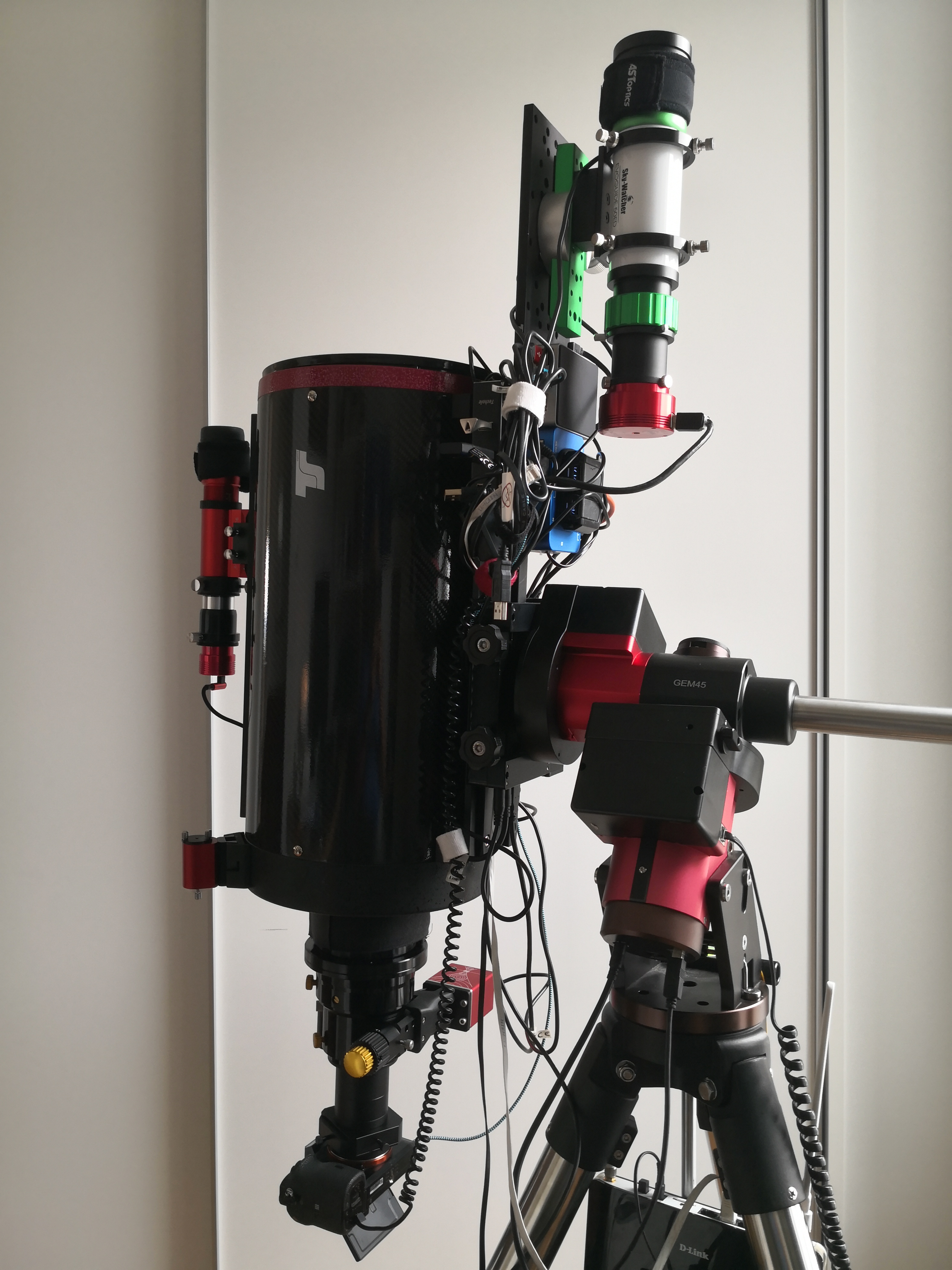

Gustav 1.20
Perfect balance both for weight and wind achieved by adding usefull stuff on a losmandy plate forward.
