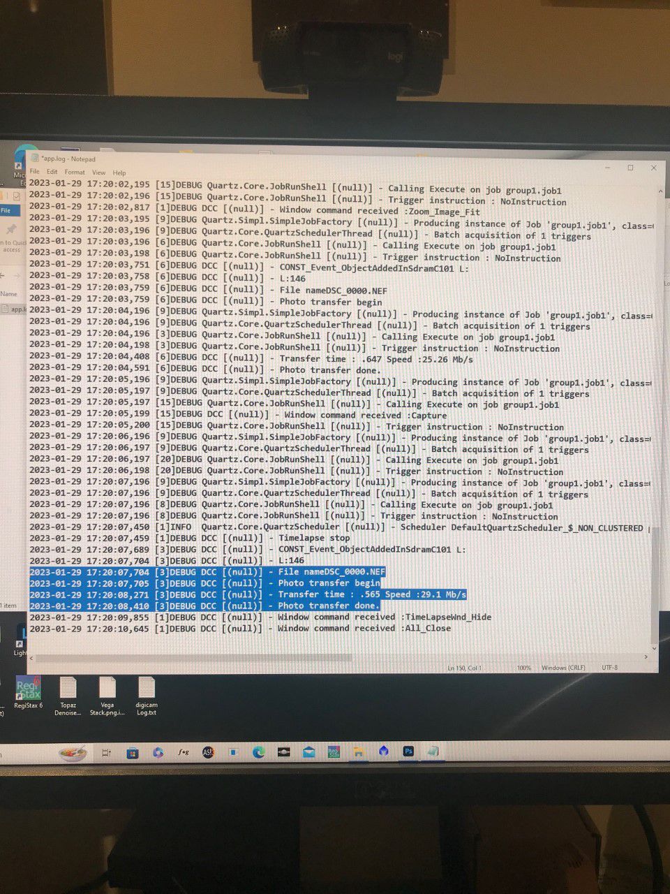

I connected by Nikon up to my 10 year old PC, which has a traditional Mechanical hard drive (not SSD), I controlled it with DigiCam software (as I couldn't find an ASCOM driver  to use SharpCap or FireCapture) . When I do this, saving the image to the PC hard disk I get sub-second transfer & save times.
I'm assuming that you don't have a delay between shots set in BackyardEOS (Sorry for asking the obvious)?
If you're comfortable with techie stuff,  ou could look at the logfile and see where the delay is occurring.  the logfile should be at "My Pictures\BackyardTEMP\logs"
you should see something like
2020-05-22 11:04:18,825 [7] DEBUG - TAKE PICTURE ::: Shutter(MANUAL) Cable(CameraUSB) Av(1.8) Duration(20.0) Iso(1600) Quality(RAW) Mirror(0) SaveTo(PC)
2020-05-22 11:04:42,606 [5] DEBUG - NIKON EVENT --> OnDeviceOnImageReady(1,type[1]) fired
2020-05-22 11:04:59,204 [CameraTakePictureOnMessageRecieved] INFO  - Timespan 40.603

I've attached the log from DIGICAM and yes this is transfer of the image from the DSLR to the PC. Granted PC tend to be more powerful but mine is 10 year old Dell (i7 3Ghz with 8Gb RAM. I've attached an extract from the DigiCam Log to demonstrate - its taking 1s exposures with a 1s wait time between exposures. As you will see the timedigicamlog.jpg

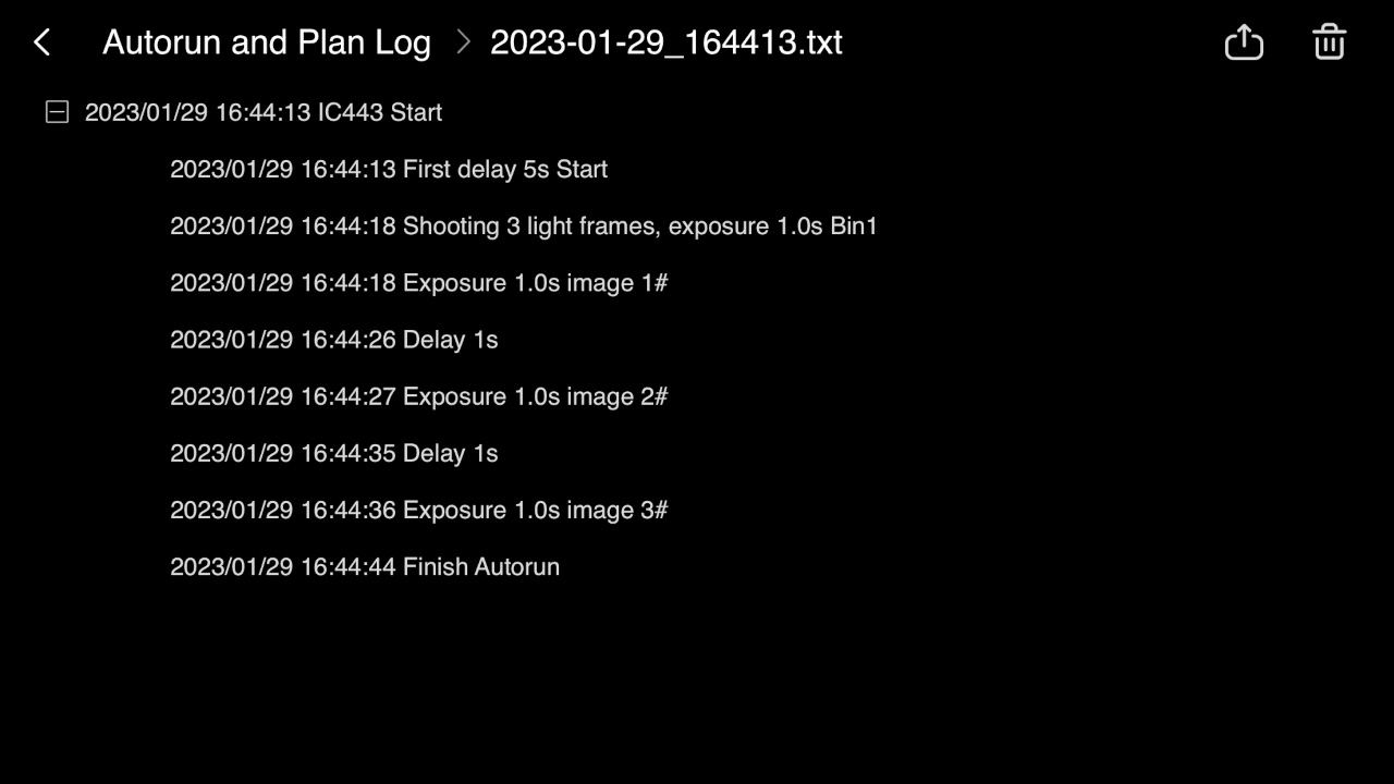

Then in the interest of completeness, I hooked the Nikon DSLR to my ASIAIR pro, and run a series of image captures, the DSLR images (RAW) are being saved to the MicroSD card. This time I see a delay of 7 seconds (after the 1 sec exposure) to transfer the image to the ASIAIR and write it to its microSD card
So what does this all mean? The answer is I'm not sure or where to go next?
