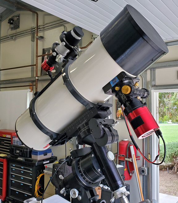

My fast Newt is a Vixen R200SS (8" f/4) that was purchased used but was NIB condition. I  dropped it on the concrete garage floor before first light which destroyed the focuser. The complete abbreviated story is here.  I've installed a rear fan, machined the spider vanes and moved the primary mirror forward to accommodate the focuser.
Corrector for f/4: TSGPU
Corrector for f/3: Starizona Nexus
Main imaging camera: ASI2600MC-Pro (APS-C)
