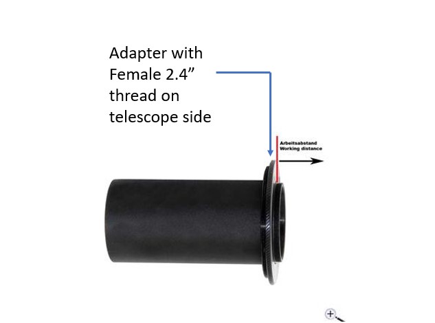

This was quite interesting to me.  Several years ago I bought a TS Optics "Power Newt", a carbon fiber F/4 Newt bundled with a TS Optics 0.7x reducer/corrector to give an effective F/2.8 Newt.  I also purchased a non-reducing "Superflat" corrector.
The reducer corrector gave me fits and I sold it without getting any pictures that were satisfactory and after many many hours of trying to correct tilt issues.  It now seems apparent from the results above, that each time I removed the camera assembly from the focuser in order to be able to access the adjustment screws on the tilt corrector, I changed the angle of the corrector in the focuser tube.  So the bizarre and unpredictable results I got trying to adjust the tilt corrector now make sense.
The Superflat corrector has an extra long thread on the camera side.  I screw an adapter on there followed by the camera, and the other side of the adapater screws onto the focuser.  Even if I had kept the reducer/corrector, it had no such extended thread on the camera side.  I don't know how I would screw it onto the focuser, but this sounds like it might have solved a lot of problems. F2.8 would be a blast if it worked.
How do you screw your corrector to your focuser?  Is there a similar long thread and adapter?  I'm not seeing these long threads in most of the correctors I look at online.
Picture of the Superflat corrector with the adapter screwed on belowsuperflat.jpg
Yes makes perfect sense to me why you would have struggled with F2.8 without the security and reproducible positioning of a threaded connection.
The paracorr II coma corrector has a female thread (65mm I think) that I connect to this adapter, which gives me an M68 female thread to connect to the focuser and an M48 male thread to connect to the camera/FW/OAG assembly.

I guess what I'm not following is how you put this together.  I have a threaded focuser (God knows what the thread size is, I bought the adapter recommended by TS Optics), and an adapter that fits onto the focuser and a thread on the corrector (which thread is immediately adjacent to the one for the camera and  a little larger than M48, looks like about M52).
I briefly played with the idea of reinvestigating the 0.7x corrector (F2.9) with the corrector threaded on this time.  But was not able to identify any reducing corrector that has a thread analogous to the one on the TS Optics Superflat corrector that I use now and which is pictured above.
Surely you don't use the filter thread to connect to the focuser?  I wouldn't expect those to support the weight.

Sounds like you've got it together!
