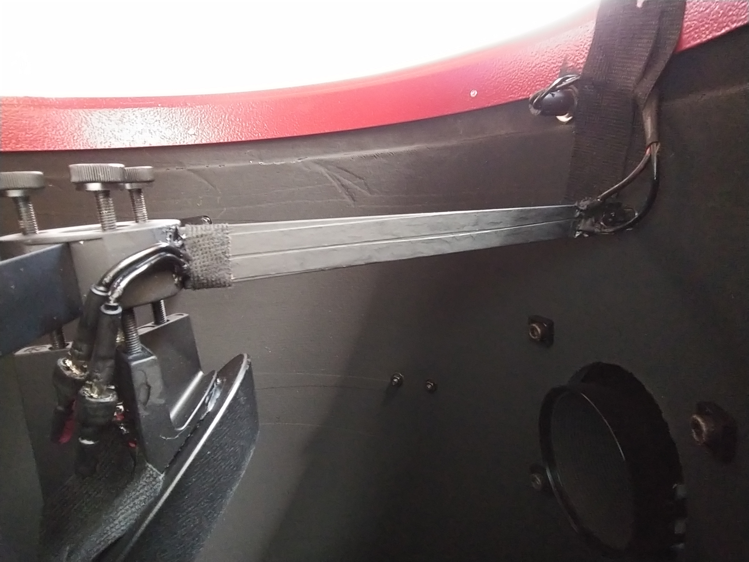

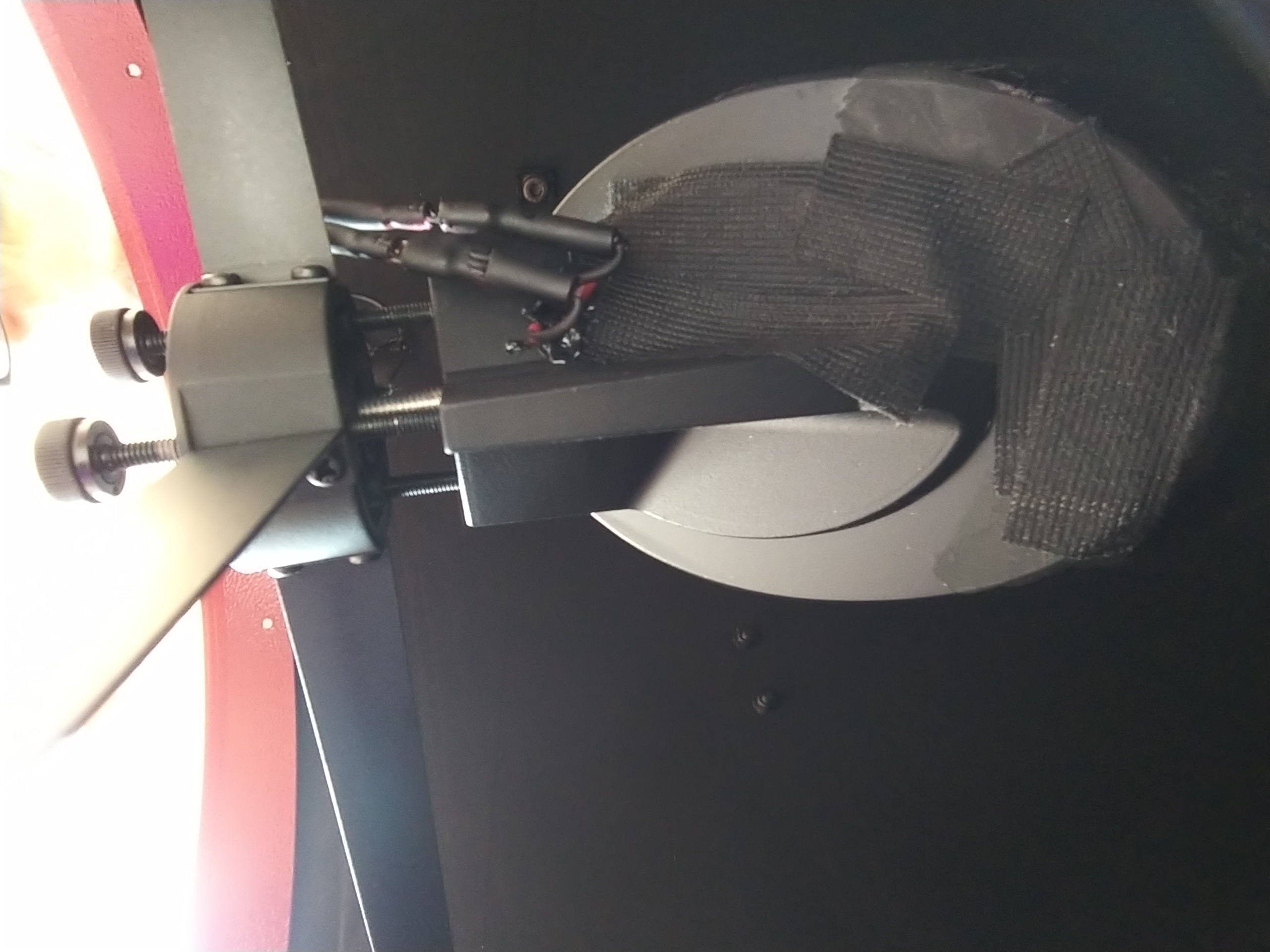

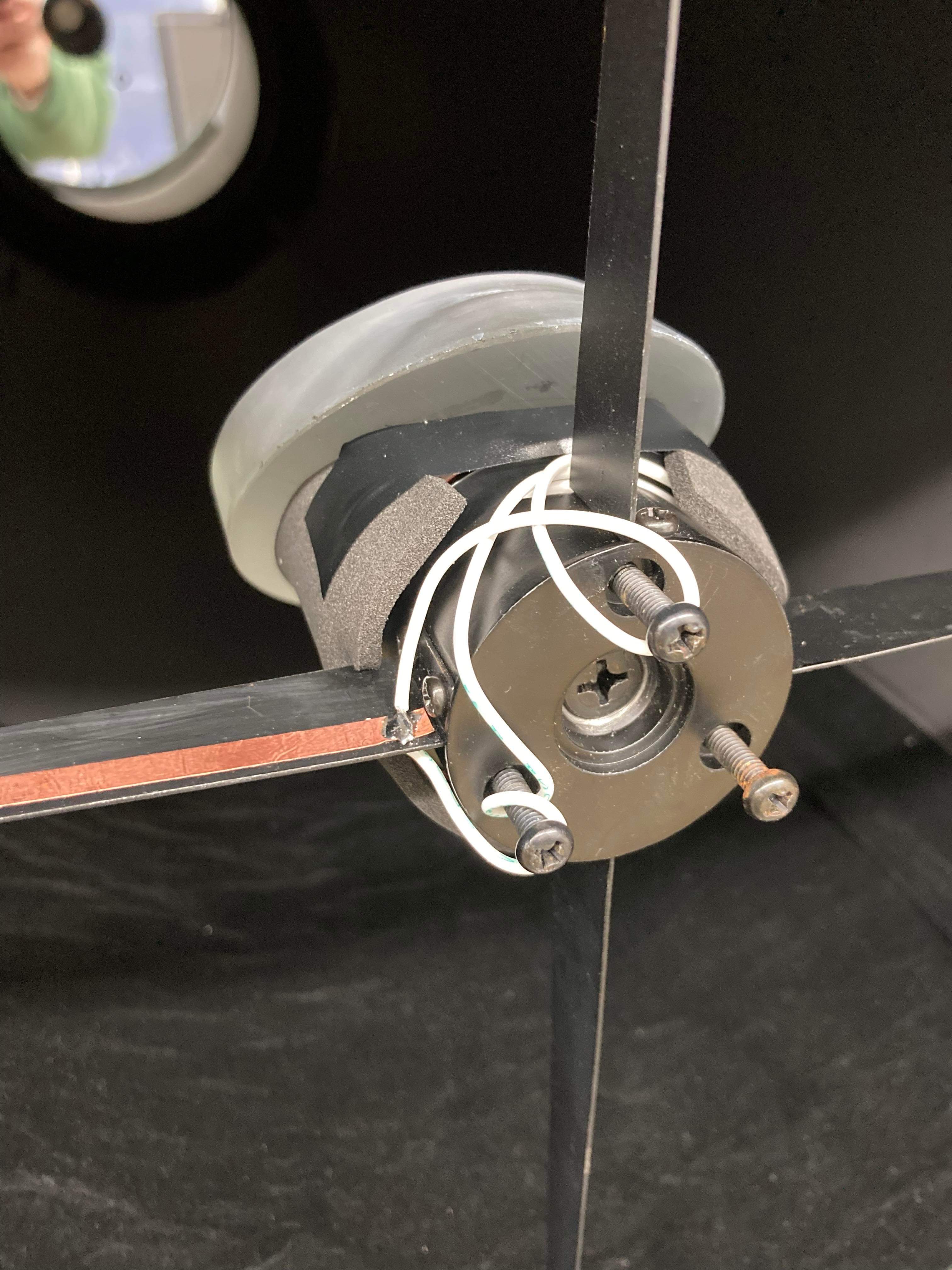

2.  Secondary:  Given the diy solutions found on CN and/or the commercial solutions, I have instead opted to use the heaters that I found on-line commercially, and at a very reduced price point.  Starting with the secondary, I could not be sure that I could fit the Kendrick split ring item to my secondary.  And there is no way I was going to pry off the secondary from its mount to put a full disk heater between the two.  The strip heaters I could find on-line for a few bucks seemed not that different than the Kendrick model, so I went for the non-astro model.  Here are some photos of the heater and the wiring via the spider using copper tape as suggested and shown above by @Dale Penkala.Secondary heater.jpg
Note the strip heater runs down along the aluminum secondary mount and maybe just 1 cm onto the actual secondary.  Most of the heat flows into the aluminum.  The electrical connetions are via spade connectors.  I need the ability to disconnect these so that I can change out the secondaries that I have for different imaging demands.  The heater comes with an adhesive so the fabric tape is for light and insulation.  I'll probably add a bit of tape to the other side of the secondary mount rib to balance heat flow and temperature across the full back of the secondary and mount.  A bit of black "Shoe Goo" anchors the wiring near the connective end.  Shoe Goo is extremely tough stuff.
You can see the copper strips used to connect to power.  They are painted black.  Very low profile (see next photo).  A lot of copper tape is the 1 mil variety.  Here, I found 3 mil tape, which I thought would be a better conductor and easier to solder.  Tape is used to anchor, along with black Shoe Goo.  Also, I added a barrel connector through the wall of the OTA.  Yes I drilled my carbon tube!  But I wanted a solid connection and in a location that did not interfere with the dust cap.  Also, if I add a dew shield, I wanted the connection to be solid and in a consistent location.  And no, none of the visible connections fall within the light path of this OTA, which itself offers a generous amount of space on the margins.
A not quite face on view, showing the low profile nature of the copper tape setup.  My only concern is that the sellers of the copper tape claim that the adhesive is highly conductive.  (I actually doubt that after testing with my meter.)  So I was concerned that I might get a short between the two strips of tape and the metal in the spider.  The black paint on the spider is sufficiently insulating.  Lets hope is stays that way...

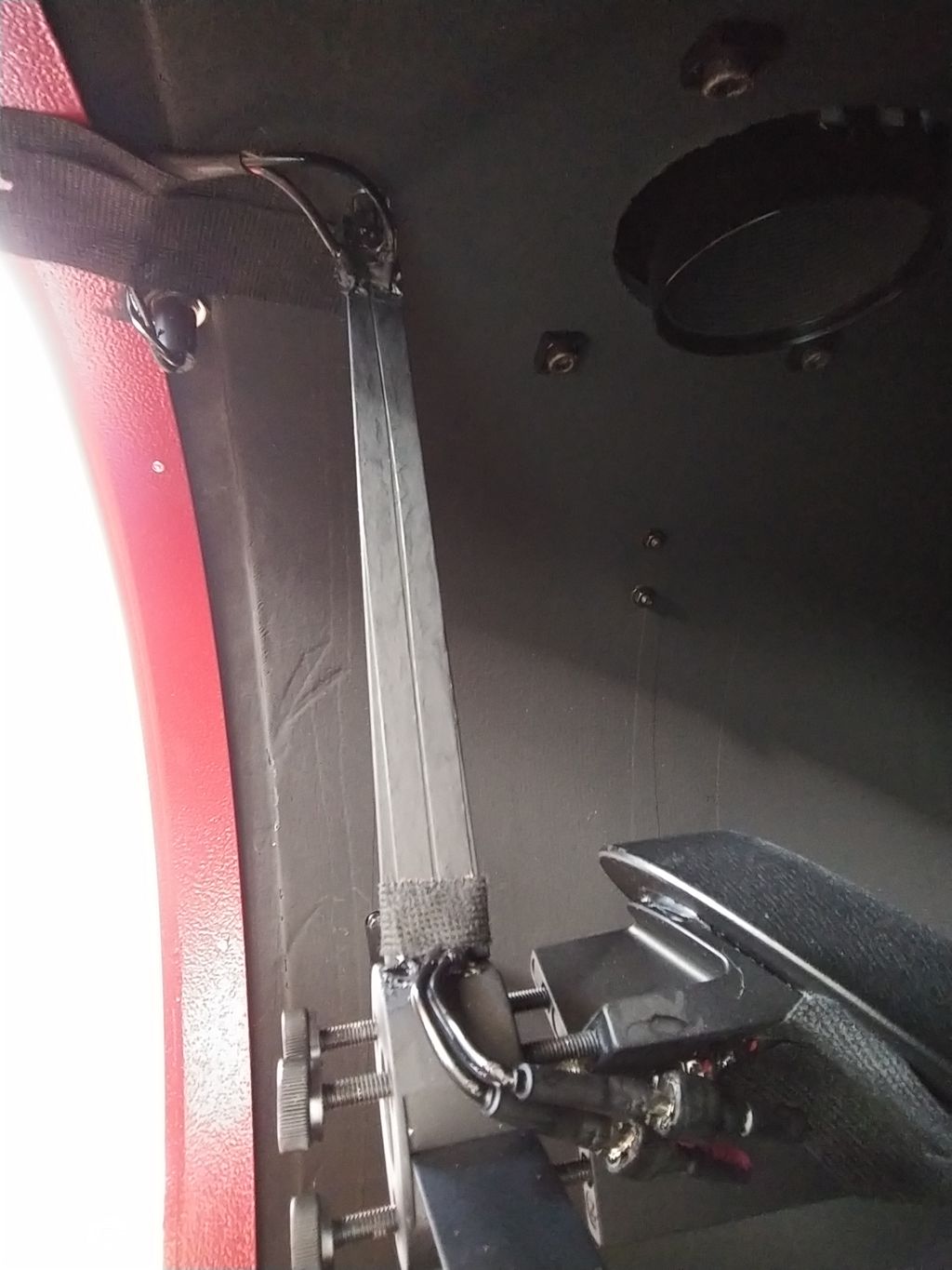

My concerns about the strip heater that I used is that its wattage is 10 watts at 12 V.  This is a 3X more than the commercial strip heater I was looking at.  However, upon use and setting the aggressiveness during use to a low setting, the heater works fine.  Getting 4 heaters for $15 was also very very painless.  Time will tell if these are durable.  They are claimed to be sealed against the environment and indeed appear to be so.  The resistive conductors appear to be thin foil, rather than NiChrome wire.  It is quite flexible and can be closely pressed onto the changing surfaces of the secondary and mount.  I actually used the other 3 strip heaters as temporary solutions on my primary (see below).

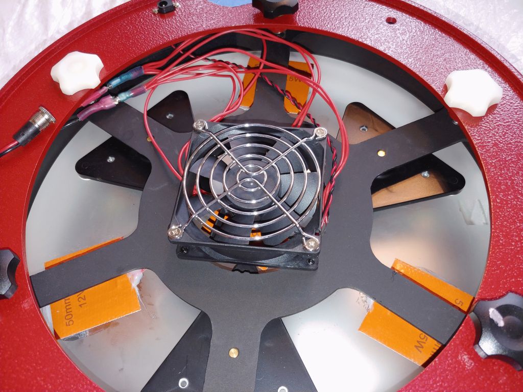

3.  Primary heaters.  Unlike the experiences mostly seen on this forum, my primary has been dewing up over the last month or so.  So I have no choice but to heat my primary.  Since my rig is open air, a fan seems illogical and I will not extend my scope until such time as it comes "indoors" with an observatory.
Because the heaters I planned to use for my primary were on a slow boat from China, I went ahead and temporarily mounted the remaining three strip headers that I got for the secondary to allow me to image for a few of the last clear nights here in Oregon.
For this, I did not want to remove the adhesive protective backing and just taped them directly on to the primary in symetrical locations.  I also learned that using such heaters demands that they be wired in parallel.  Doing so in series would effectively raise the resistance seen at the load and force the wattage output to extremely low max values.  The heaters that I planned to use are now delivered and I will pull these strip heaters off and save them in case I need to use them for other projects.  BTW, they worked spectacularly well at very low power draws from my PowerBox.  Under very dewy conditions (every other surface ended up dripping wet), the primary stayed dry.
Here is one of the 4 heaters that I received this week.  It cannot be seen in this photo, but the resistive conductor in this heater is clearly a wire, not a foil strip.  I will assume it is NiChrome.  This heater also is "sealed" in a much thicker silicone/fabric sandwich than the strip heaters.  This heater is lower power than the strip heaters (7.5W spec, but likely under 7W as measured directly with the meter) and I plan on using 4 of these.  3 symetrically a few cm inside the perimeter of the primary and one directly in the center.  I will attach these with a thin layer of silicone adhesive to ensure full coverage of the heater to primary.  I will likely add a bit of silicone to the wire entries as I am not sure the there is a good seal into the wiring solder joints.  This will provide 30 watts/hour of power, which happens to be roughly the power that the commercial heater for this size mirror offers.  I would never expect to use more than a few watts/hour as I have learned from using the strip heaters.  These heaters are relatively thick and the silicone adhesive will add a bit more thickness overall.  I expect that this will slow and diffuse the heat transfer to the primary.  That is fine.  I hope not to have to cover these heaters with tape or other insulation for them to be effective.  Either way, it has to be better than a peripheral heater wrapped around the edge of the primary.  I do worry that if I need agressive heating, that uneven heating might cause a mirror surface artifact that might resemble pinched optics.  But the expectations are that the heaters will not come on until very late in these sessions.  I'll post a final photo of this setup.

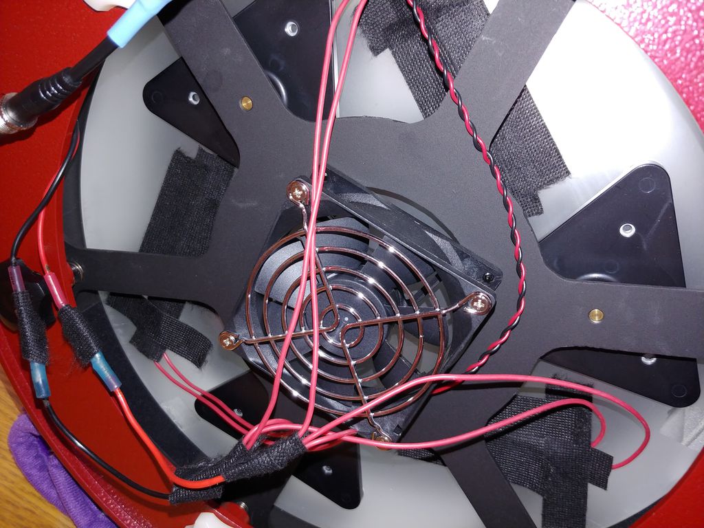

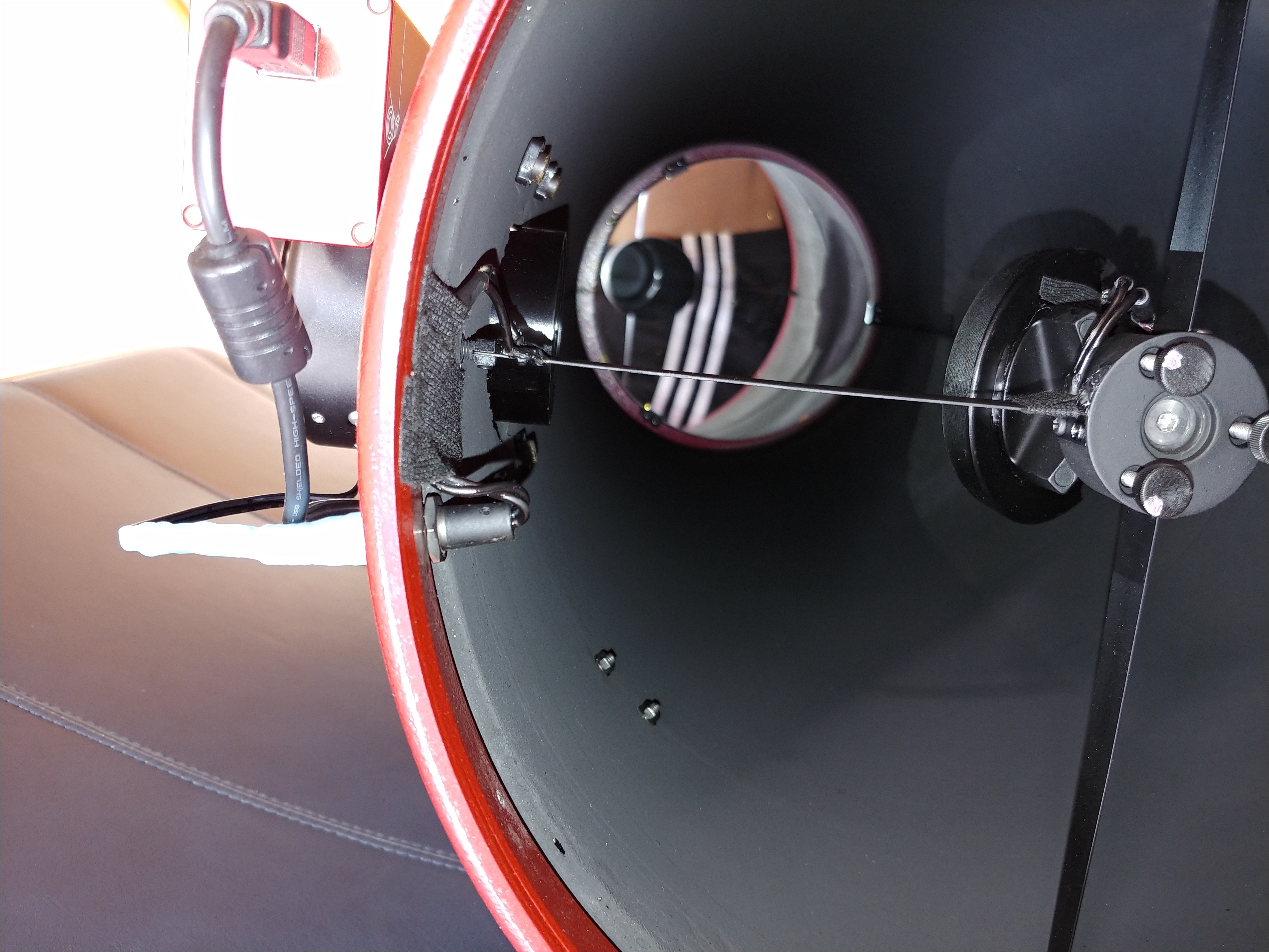

A final update with the promised photo of the finished assembly for the heating of the primary mirror.  The 4 heaters appear to draw 0.6 Amps at 12.1V, which works out to ~7.25 W.  This was confirmed after assembly and the 4 heaters and under full power setting with the Pegasus Power Box.  So a bit under spec.  A total of 29 W at 12.1 V and a power draw of under 2.5 Amps.  This at full power.  I can feel the heat under these conditions and likely will never run these at more than 20% agressiveness in reality.  As such, the draw of all the heaters, including my guide scope is well within the power I supply to the Power Box, though heating is one of the biggest draws overall.
To repeat, I used 4 heaters.  Three placed symetrically on the perimeter, a couple of cm from the edge of the primary.  The 4th heater is centered under the fan.  There appears to be a lot of wire spaghetti, but I decided to not shorten the cables.  I wanted all the cables to be the same length so that each heater would output the same power.  And it is nice to have the extra cable in case I need to make some repairs in the future.  The heaters are fixed in place with a thin layer of silicone adhesive.  These were pressed down with blocks of wood to ensure an even and thin spread so that heat transfer is consistent from heater to heater.  Silicone adhesive is tough stuff, but I know that if any heater were to fail, it would not be that difficult to remove if need be.  The spade connectors pretty much offer me no real advantage other than the connections are crimped rather than soldered.  If I ever have to replace a heater, I will have to cut these connections and redo it.
Hopefully, this description will be of use to someone.  Also, If anyone has used the type of heaters described in this thread and found them to be wanting, or have failed, please post that here for anyone on the future.

Sorry to resurrect this old thread, but I thought it my duty to report on any issues that I have seen on my setup in case someone adopts what I have done.
Mostly I should state that I am please with how things are working.  But, I am still getting used to how to use it with the controller, which in my case is the Pegasus Astro power box.
I have had a stretch of clear weather this week, so finally got this telescope out for a few nights of imaging.  Most nights have failed due to high winds, but at least I tried.
In the case of the primary heaters, I note that when the heaters are turned on, quickly I find that the out of focus star images change into the shape of a trefoil.  That is three brighter areas equally spaced around what should be the out-of-focus donut that is normally seen.  Because it has been around freezing here, the heater power, when set to auto, has been pretty constant.  This not counting the cycling of the pulse generator.  I have also set the Power Box controller at the lowest agressive setting of one.  This certainly has kept the dew at bay.  I believe that the exposed nature of my setup means that heat migrating from the heater pads outward to the exposed areas means that this forms a heat gradient, and therefore stress gradient between the exposed areas and areas under the pads.  And this does not change during the night.  The in-focus star image appears to align the three spots of the trefoil and therefore seems to resolve into a minor issue, but I still am not happy with that occurring.  So I have gone to manually setting the power levels to lower levels and stopped the cycling.  I use settings under 10% for the primary and just a few percent for the secondary.  With that, I can eliminate the trefoils and do not see any dew.  So in this case, I think that pulsed heating is not ideal.
I am not sure that the heater on the secondary causes any issues.  But I expect that the heat would in theory cause a minor expansion of the aluminum secondary holder which could cause slight changes in the focus.  This is dealt with if one uses autofocus and hfr assessment to trigger refocusing.  I am not sure that pulsed heating hurts here, but steady power to the heaters, at a lower setting should be better.  But the insulation over my heater that I have done with multiple layers of cloth tape (or the foam that is supplied with some kits or used by others), likely reduces any real temperature fluctuations with shortly spaced pulses.
I can only imagine that any heating setup for a Newtonian primary will have some heat-induced issues optically.  For that reason, solutions, such as the Kendrick heating pad that covers the full back of the primary may avoid such issues.  But I was not about the remove my primary from its cell, stick the rubber heater on the back and try to fit it back into its cell.  I am not even sure there is room for that and not sure how stable the primary mirror would be without the floating supports in contact with the glass of the primary.  Alternatively, heating just the periphery of the mirror offers challenges because of interference from mirror clips and the fact the heating, isolated to the periphery of the mirror, should also cause figure changes, albeit different that what I see.  In that case, it is also a long way for the heat to travel to get to the center of a larger mirror.
I think I have the issue solved by using the lowered settings on my power controller.  However, not wanting to just let things be (which would be the smart thing to do!), I will likely buy a thin sheet dense foam that I can cut with scissors and cover the back of my primary in segments that cover the heaters and most of the exposed areas of the primary without interfering with the floating mirror cell suspension.  I am hoping that this allows the heat that enters the glass at the location of the heaters can more freely migrate horizontally out from the heaters and not so easily exit the exposed primary back around the heaters (see figure above).  Given the Pacific NW weather here, I will have a good number of months to work that mod out.  I am not ready to close off the whole back of the OTA for fear that this might cause other issues with imbalanced temperature within the optical tube itself.  Carbon fiber tubes may well be less reactive to temperature changes, but I can clearly see that the effects are not zero, and I do not want that to become a secondary problem.
